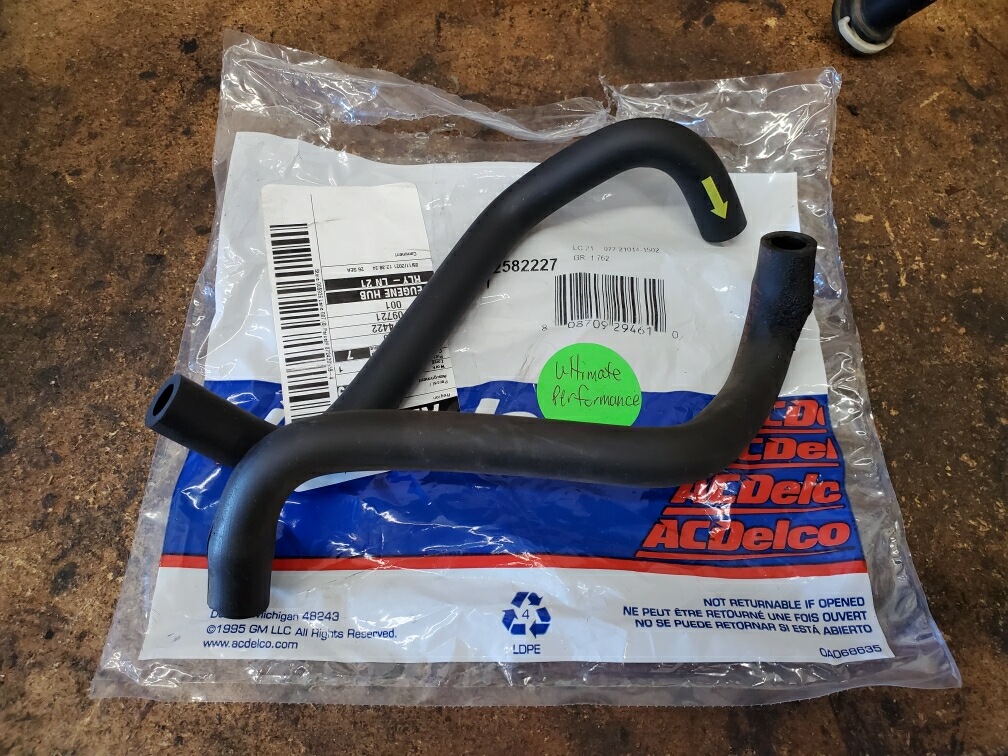

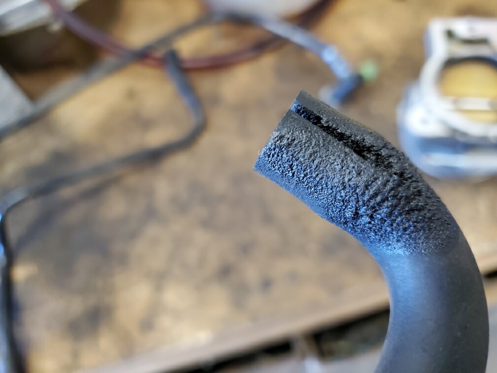

Recently did my PCV and found as I traced the hose back to below the throttle body, that I had a bad hose but never did get a CEL:
