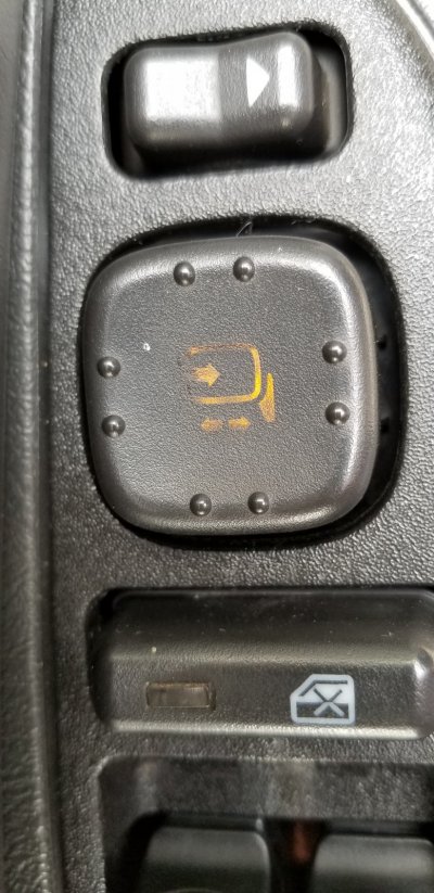

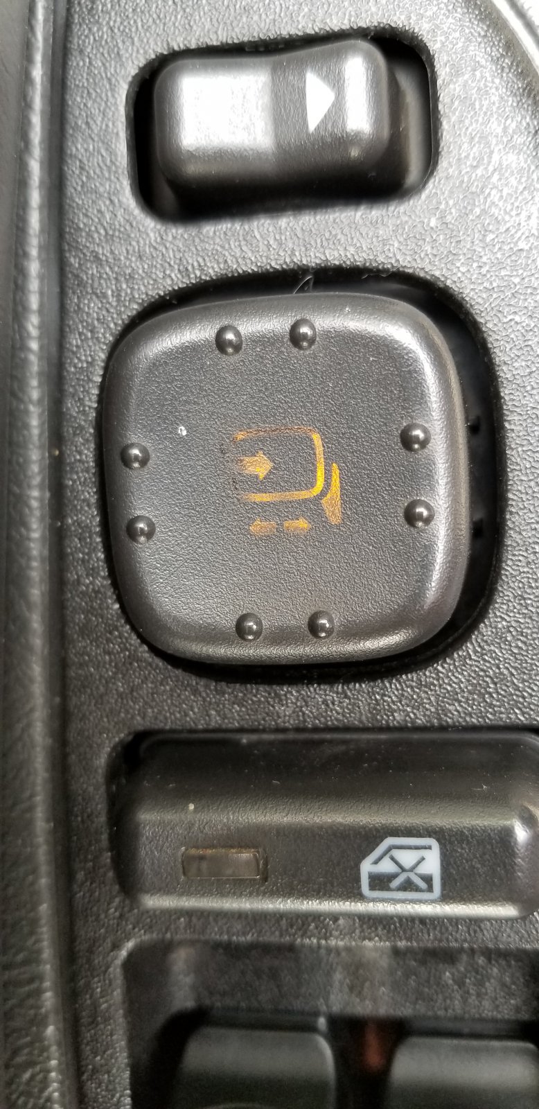

Weird stuff going on up there, anyway, here's how to check and see if you have the power fold option...
33,344
51,835

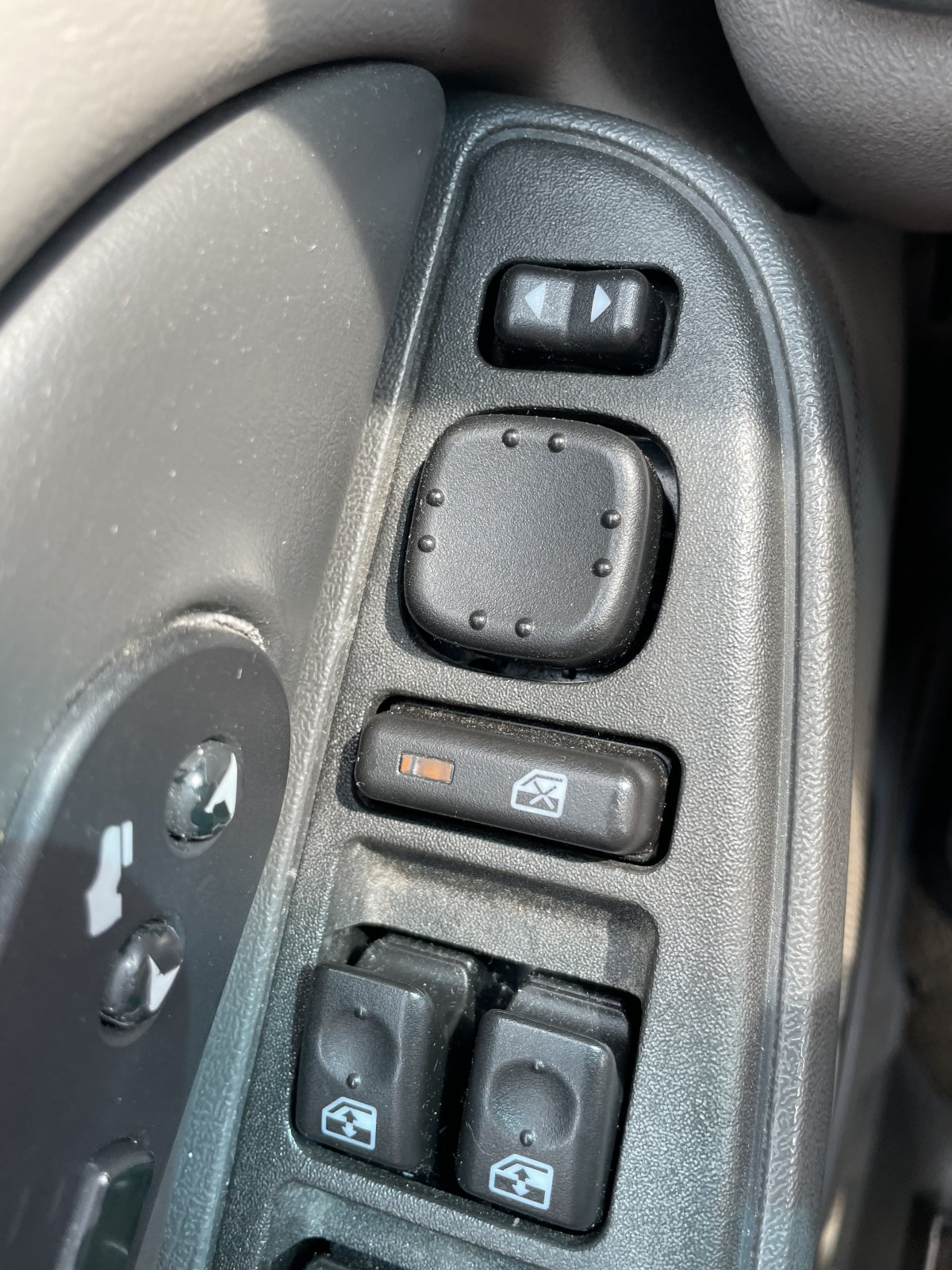

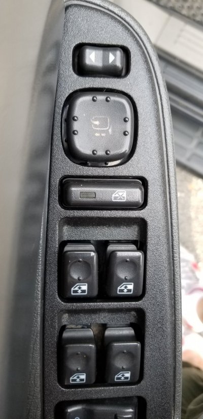

DL3 are the powerfold mirrors. This is what your power mirror switch will look like if you have powerfold mirrors. The left/right switch needs to be in the middle before the switch will light up.20180608_170206.jpg20180608_170221.jpg

RPO code is DL3, but my mirror switch doesn’t have the little center light up indicator in the middle of the adjustment button.

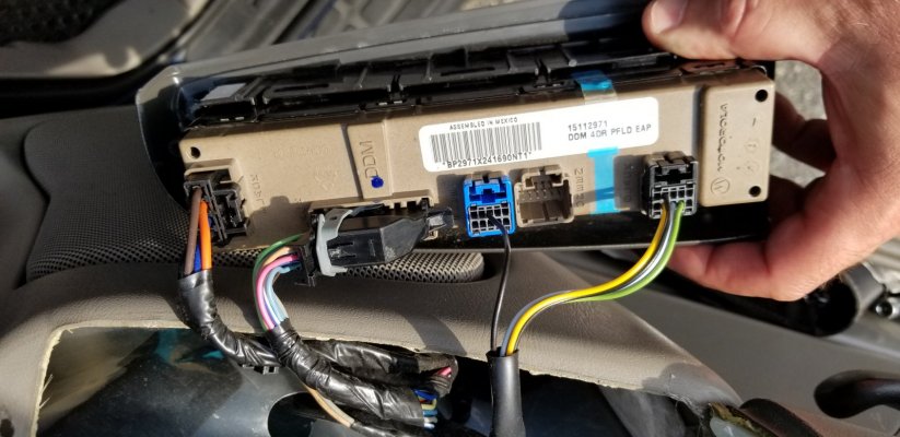

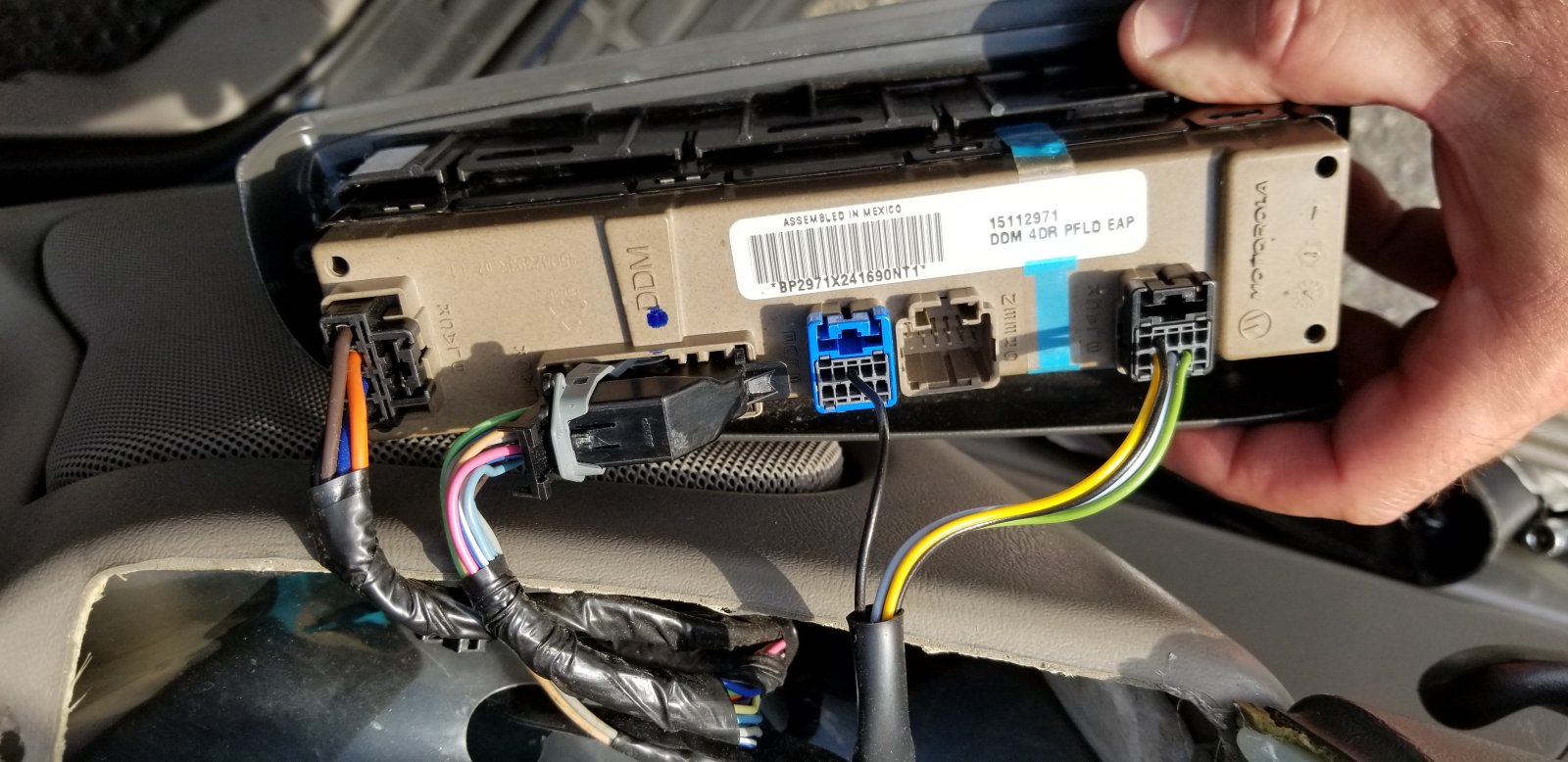

You might have the correct mirrors, but just the wrong switch. How many plugs does the mirror have? All of them plug into the master switch--underneath the window switches.20180608_164456.jpg20180608_165744.jpg

Not sure yet, hoping to be able to pull the switch tomorrow. I EFFed up my back on Friday so Ive been laid up the last couple of days.

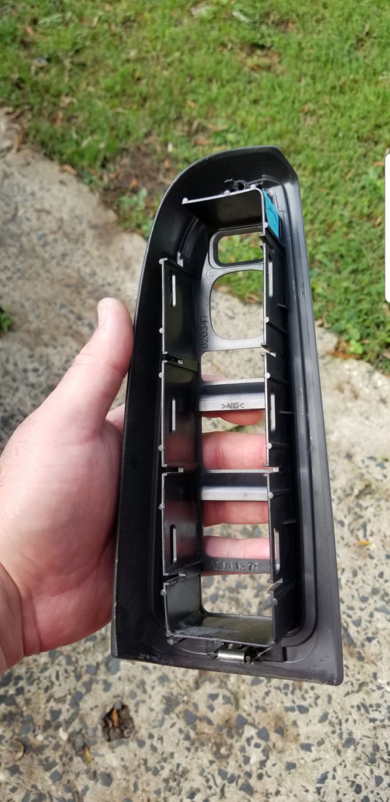

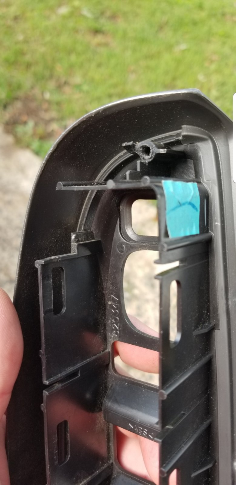

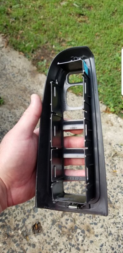

Being an '03, be sure to pull the door panel to remove the switch. There should be a screw underneath it to capture the bezel it's clipped into. Don't try to pry it up from the top or you'll break the bezel off of the screw post. Don't ask me how I know.
33,344
51,835
Yup, forgot about that. Been there, done that too.Screenshot_20210808-143412_Gallery.jpgScreenshot_20210808-143422_Gallery.jpg
See the broken nub in the upper part?

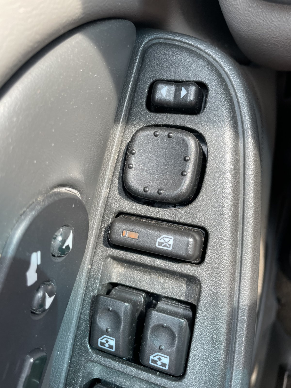

30,772
48,476
my 03 Silverado had power fold and led mirrors and the drivers door switch did not light up, you just put the left/right selector in the center and press the big button up or down.
Was it original or swapped before you got it?
