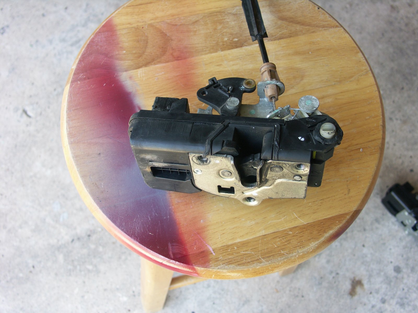

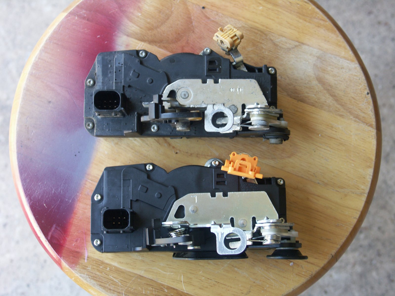

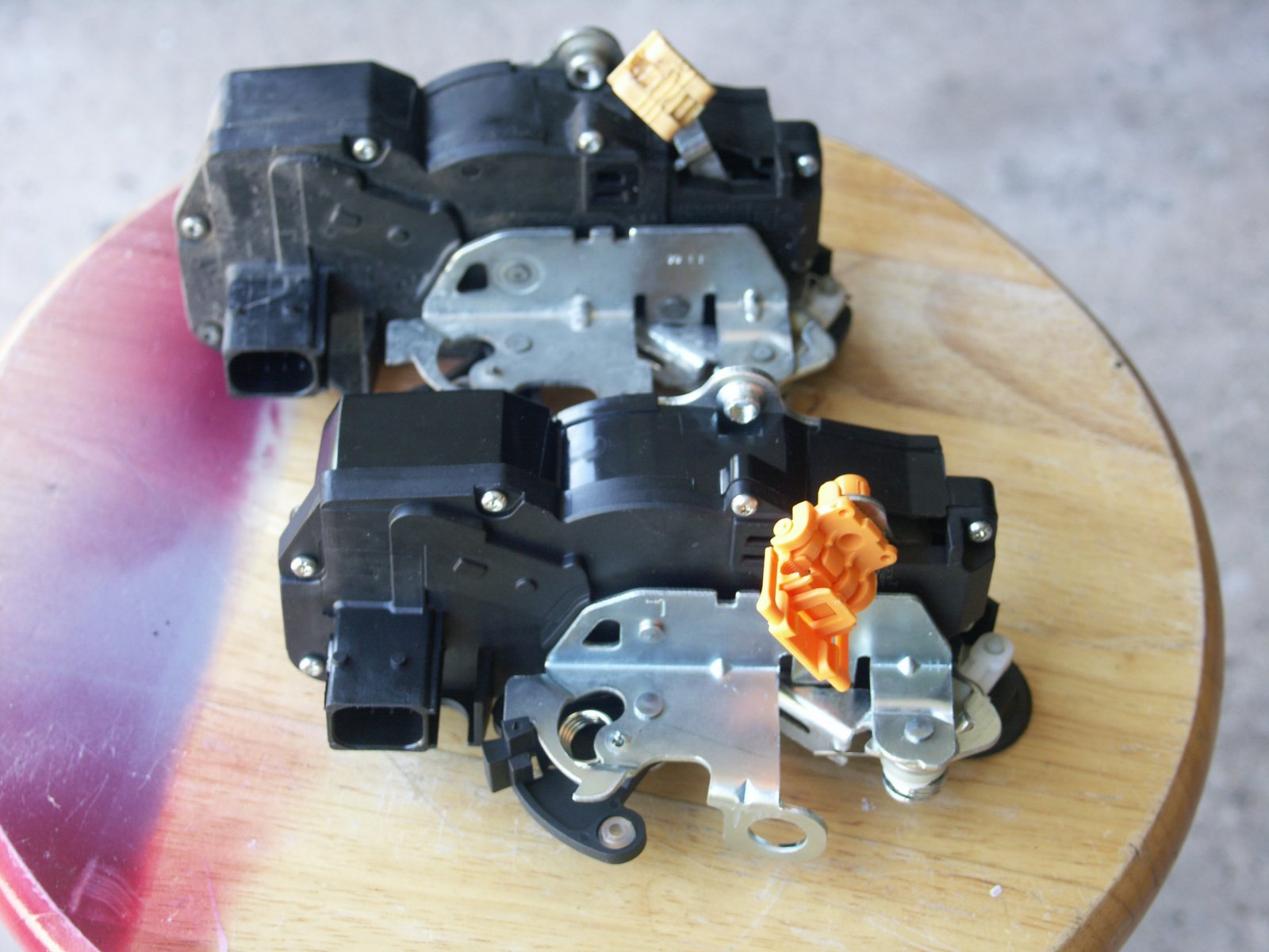

So, after a lot jacking around, Not only was the yellow clip was messed up, but the actuator itself was FUBAR'd. The lever that the yellow clip is attached to was very tight and not moving. After a quick overnight order of a replacement $21 actuator from Amazon, everything now works as it should. I almost gave up a couple of times and was going to throw in the towel. Let's just hop this actuator don't give me problems. $21 vs $108 from dealer.
