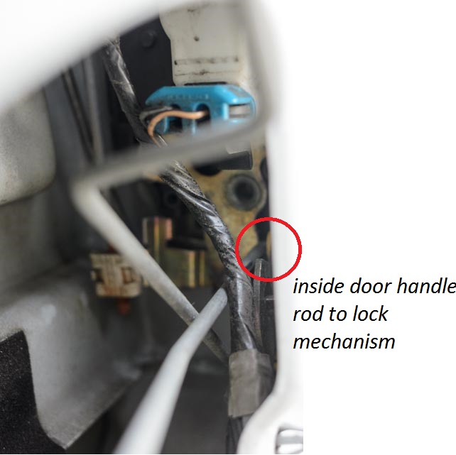

1) Using a blade screwdriver, pop out the rod connecting the inside door handle to the lock mechanism circled in red. There is no need to remove the rod from the door handle itself.

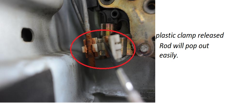

3) Push indicated tab outward until you can release the plastic catch. Careful to not break the plastic. This took two hands. One to push the release tab, a second to pull the catch open.

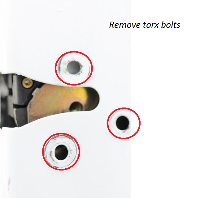

5) Unbolt the lock mechanism from the side of the door. It is easier to pop off the remaining rod after the door lock mechanism has been unbolted.
