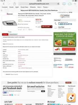

And another....cut the shit out go my finger twice now... Anyone try an aftermarket one? Replaces the whole color matched piece and chrome handle.
