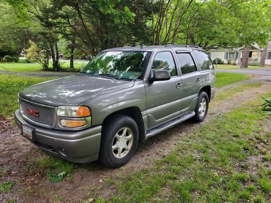

2005 Yukon Denali AWD:
My dome and map lights stopped working when any of the doors open, and also do not respond to the dimmer top position. They DO turn on manually, so I know they function.
Additional observation: the courtesy lights on the bottom of the doors continue to turn on and off with the door action.
I suspect the BCM. About a month ago my dash went crazy for about half an hour. Possibly not a coincidence?
Advice will be appreciated.
Also, is it true a replacement BCM needs some kind of authorization?

Pics of the truck, please.
