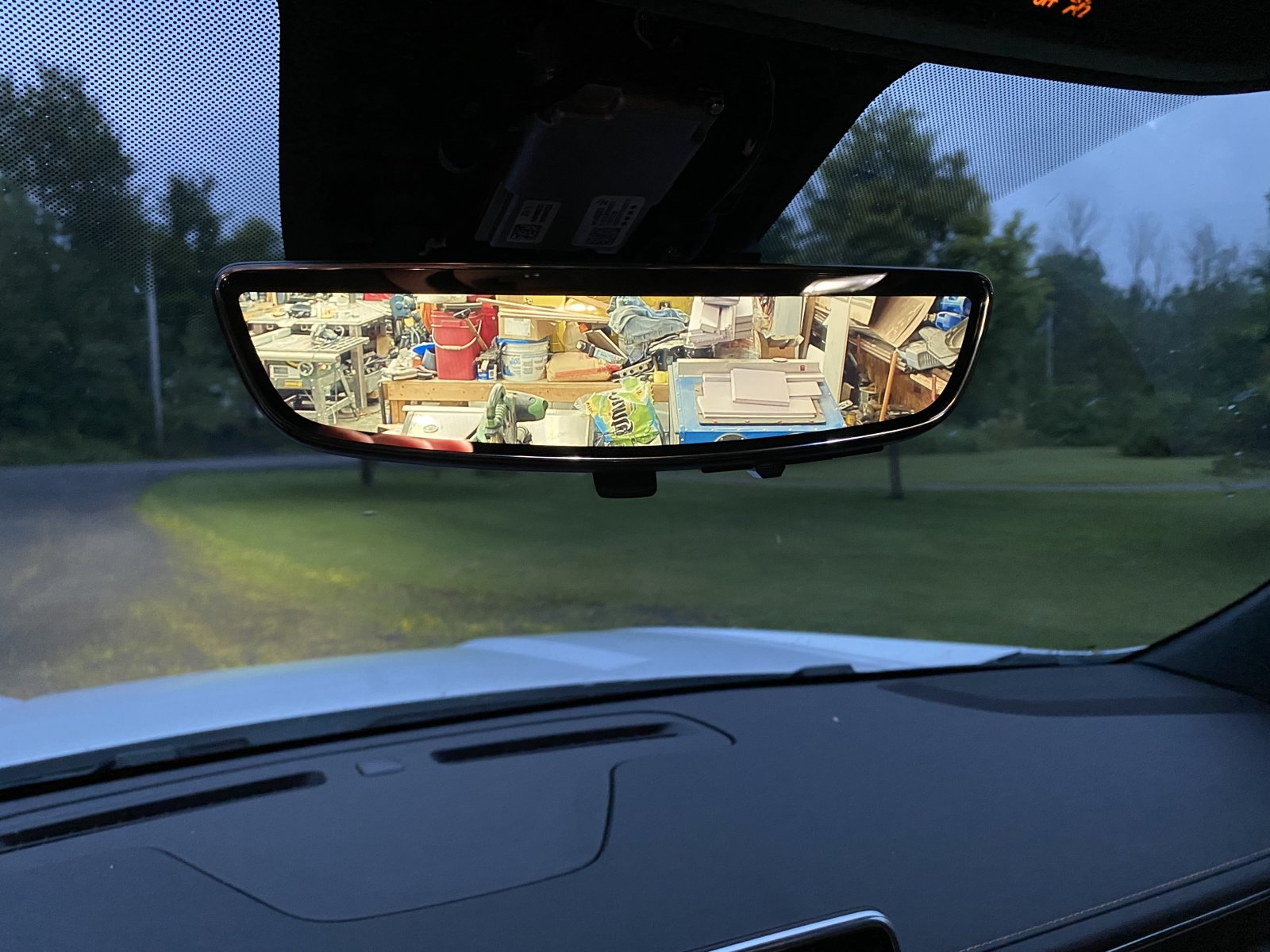

The digital rear view mirror kit arrived today and I installed the mirror this evening. Mirror and cameras / license plate light assembly appear to be genuine GM parts (as claimed). The camera assembly included both the backup camera and mirror camera (video and website state mirror camera only). I will not be installing the camera for a few weeks but I did try it briefly. I'll purchase second mirror camera for the back of my trailer.
The mirror camera field of view is too narrow to use as an interior trailer camera. I couldn't see floor or ceiling of my 14' V-nose, only the ramp door and a bit of the walls when fully zoomed out. I'm hoping the standard reverse camera works with the mirror as it has a wide angle lens. The only difficulty is it's Fakra connector is keyed differently (M code vs C code).

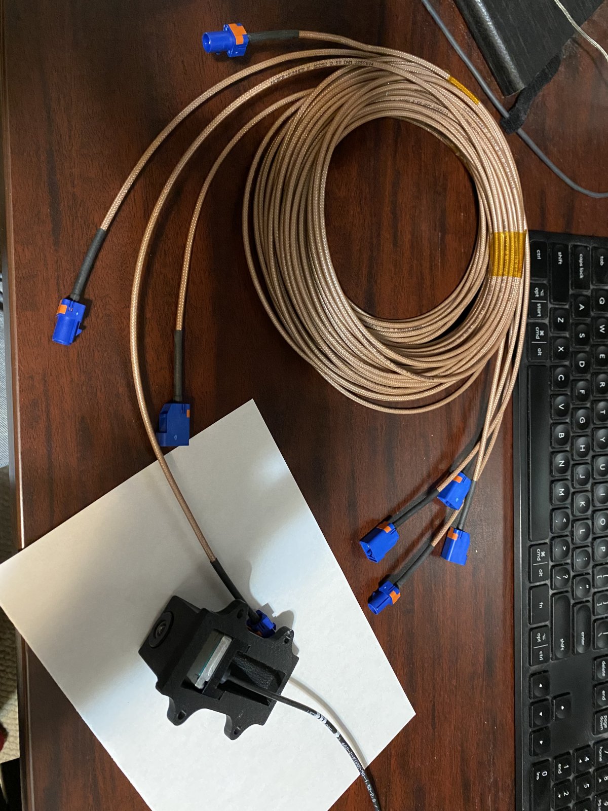

This is progressing slower than I would like, but I passed my last technical risk for a minimal level of functionality. I was concerned about the overall cable length and connector loss with a connector at the hitch and more than twice as much cable as the infotainment kit came with (and likely an OE installation). With this in mind I purchased 25m (~80') of what I think is the best quality / performing cable available which is still small enough to work with Fakra connectors. What is discovered is connectors claiming to be compatible with RG-316 are not exactly compatible with RG-316DS (dual shield) and RG-316DS cable is expensive. I ordered the following from Digikey:
Digikey: 3628-22510218-DS-ND MFG : Huber+Suhner, Inc. / K_02252_D
Digikey: WM10362-ND MFG : Molex / 0734036262
Digikey: WM10369-ND MFG : Molex / 0734036282 (This is the wrong p/n (C key, blue) to connect to the mirror! The infotainment plug Z key (water blue, equivalent to Molex 73403-6290).)
The electronics lab tech at work assembled the connectors for me, using a Amphenol? crimper with SMB dies. He commented the connectors weren't intended to be used with dual shield cable (he had to thin the braid to fit the crimp tube), the SMB dies weren't ideal for the center contact but worked, they were the correct size for the crimp tube and something about me being impatient, which i ignored. I took his recommendation to install connectors on both ends of the spool and test the connection before cutting the cable to the lengths I need.
Before leaving the office, I had to test the cable. This is when I discovered the mirror connection was not C key. The infotainment cable has a Z key plug (mirror end) and a C key jack (camera end). The camera is very obviously C key (has blue band on die cast plug). The mirror jack is dark (black, or brown?) and difficult to see with the mirror installed. It's obviously not C or Z key (Z is universal), but I can't tell for certain if its A (black), F (brown) or something else without a flashlight and moving the mirror. I modified my C key to a Z key by shaving off the 2 keying ribs with a pocket knife. Everything was finally connected (we also installed the connectors on wrong ends of the spool so I had unspooled 80' of cable into the passenger foot well) and flipping the toggle yielded a clear image on the mirror. I could drive home happy.
Once home, I tried my 25m (80') cable as an extension on the infotainment 25' cable, to test signal integrity margin. This introduces signal loss via an additional connector pair (I'll have a pair at the hitch and another pair near the rear fuse panel (to select the lift gate camera)) and 25' of lower quality RG-174 cable. Considering my final cable length will be approximately 60', I likely could have purchased 1/2 as much RG-174 (at 20% the cost per meter of RG-316DS and still Huber+Suhner), used the infotainment cable to get to the hitch and saved several hundred dollars.
My next steps are to determine the length of each section, have the additional connectors installed, 3D print a housing for the camera, install then further testing on a 1500km tow to my parents place.

I measured each run of cable last night: mirror to rear fuse block, rear fuse block to hitch, hitch to rear of trailer and hitch to front of trailer and with, some guidance, made up the remainder of the connectors. I'll eventually modify the infotainment cable to run from the rear fuse block to lift gate for the OE camera location but I'm won't install that camera until after vacation. After installing 5 of the connectors on my own, they're small and a bit involved but not too technically challenging. I am glad i was doing it at a lab bench set up for soldering PCBs and made good use of the microscope, and not laying in the driveway under my Yukon.

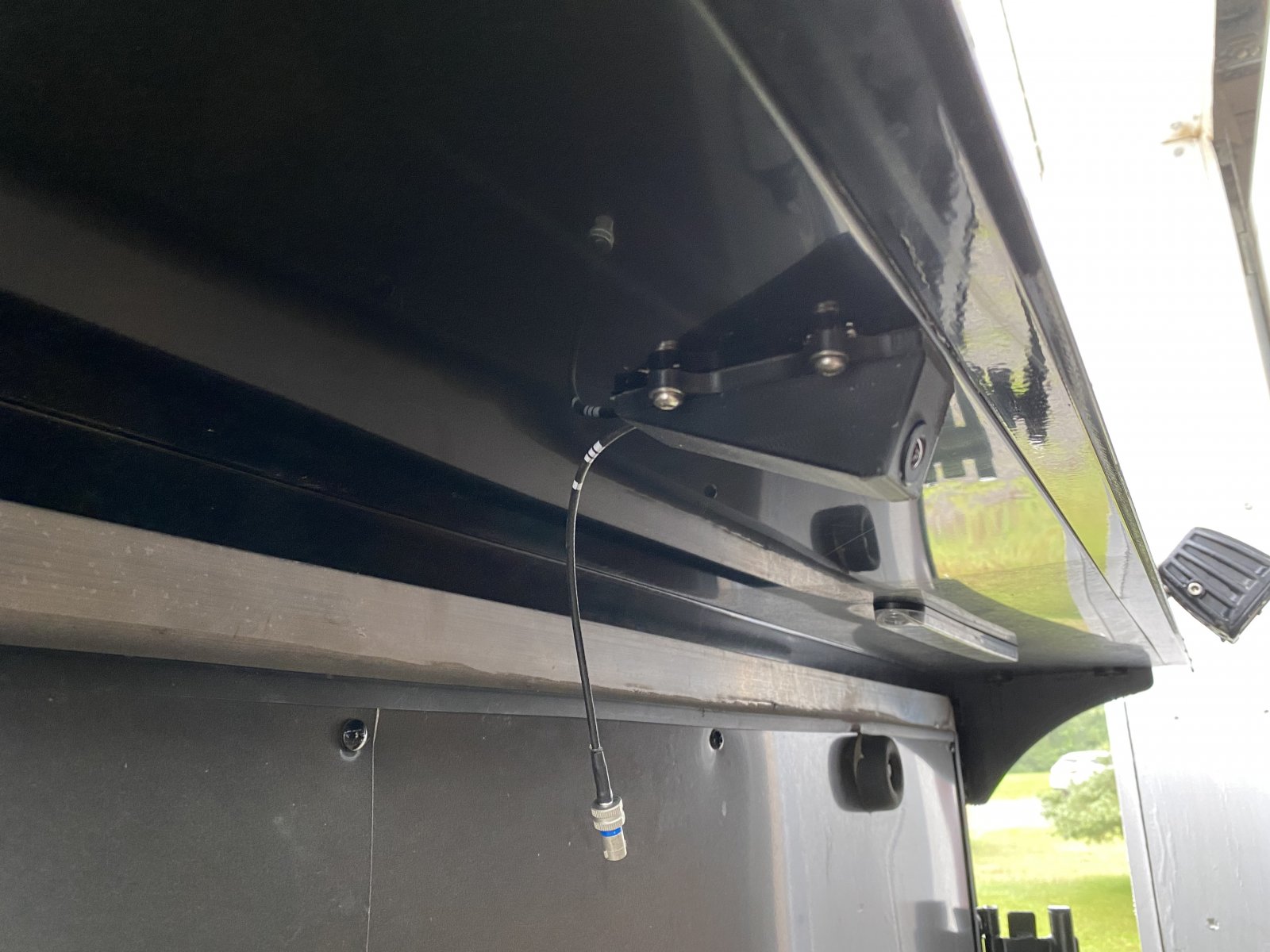

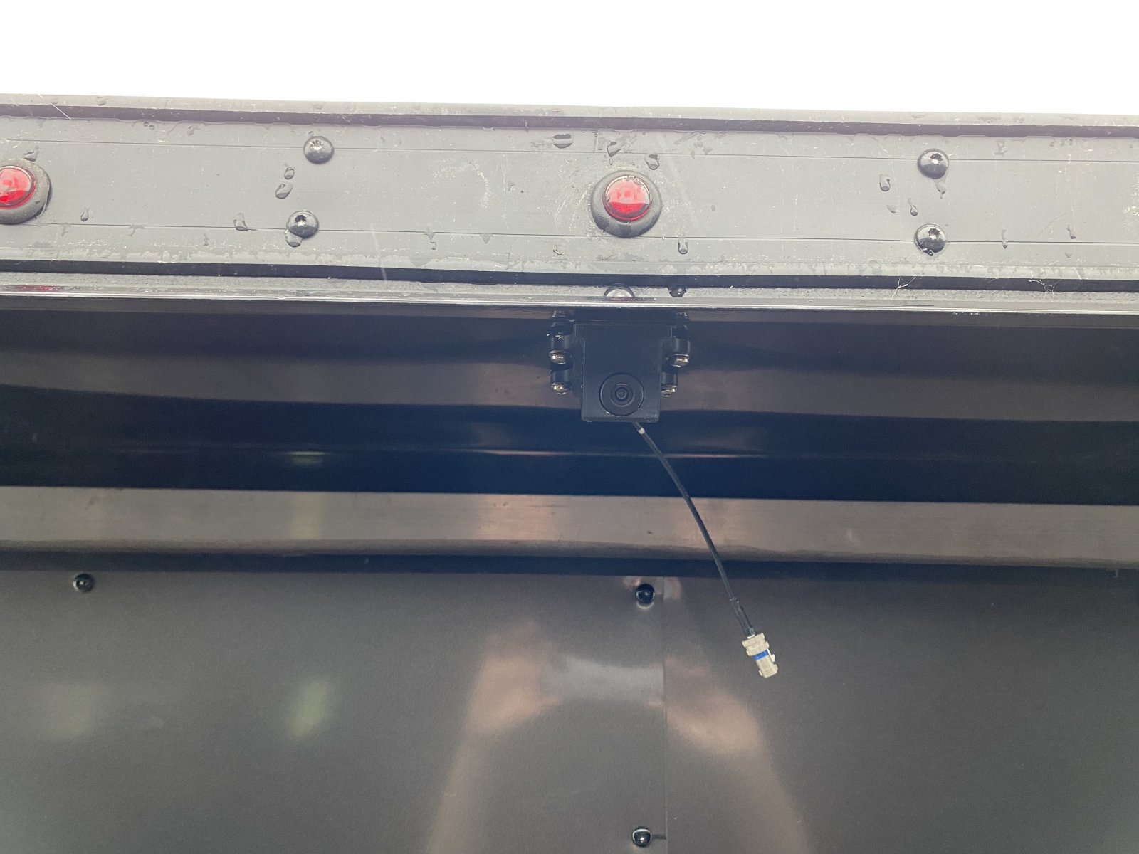

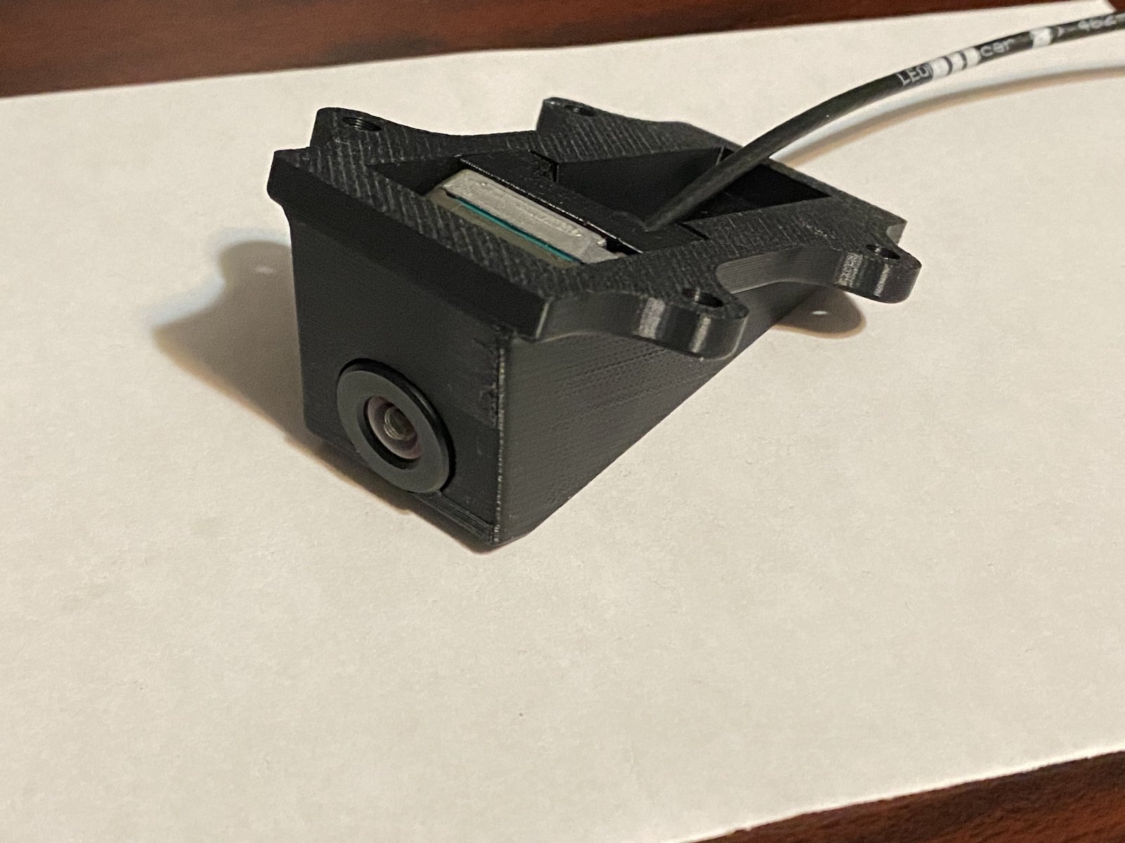

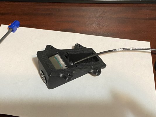

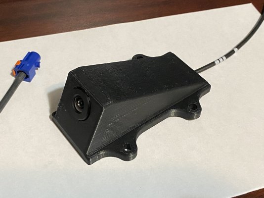

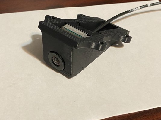

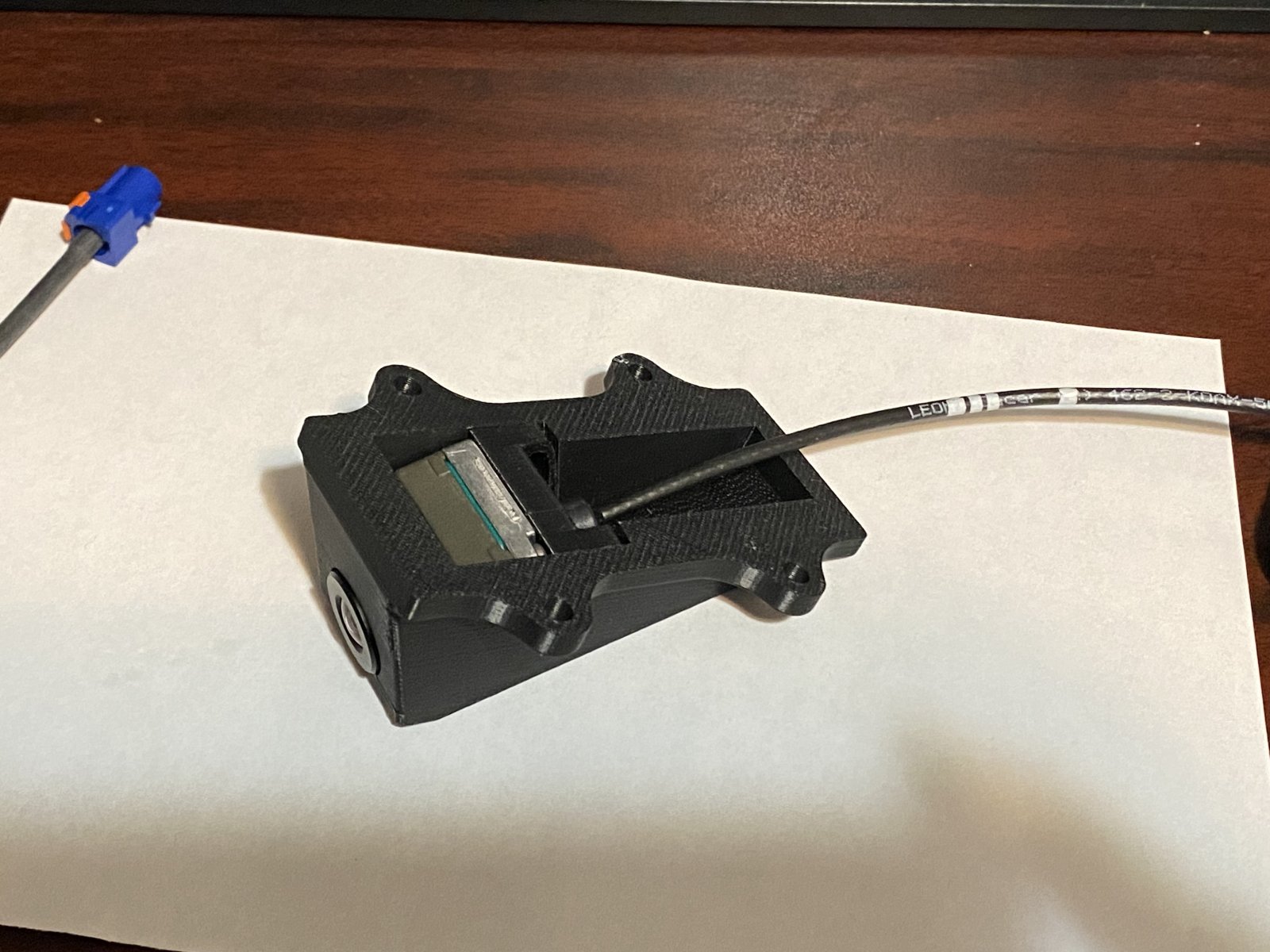

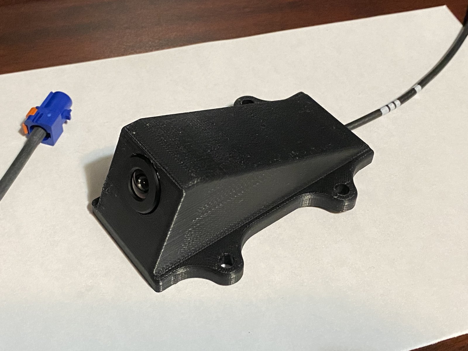

I also designed and 3D printed a housing for the exterior trailer camera. I will mount under the spoiler and above the ramp door of my trailer. There is about 1/4" clearance when the door opens but I didn't have to recess the camera body into the spoiler.
This weekend I'll run the cable for both trailer cameras and install the exterior camera. The second camera is on order and can be used for either the OE location of the interior. I'm still not happy with the narrow field of view with the mirror camera in the interior but want to run both cables while the wall is apart.

After a long day of installing the camera, disassembling the trailer, running the cable, reassembling the trailer and short lived disappointment (the hatch must be closed for the video mirror to work), I successfully have a camera on the back of my trailer! :happy160:
I still have to run the cable through the truck but that should be easy. This will be such an improvement over the stock exterior mirrors which just barely provide a view along side my 7' wide trailer.

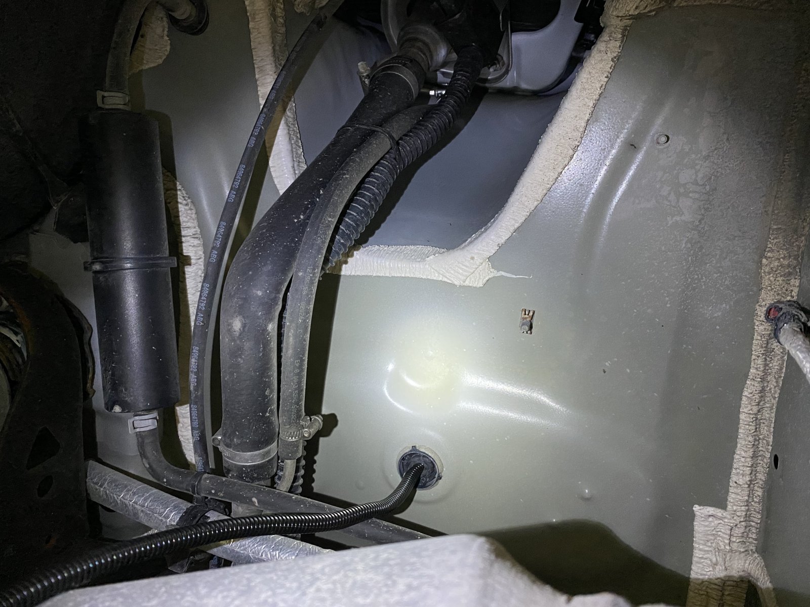

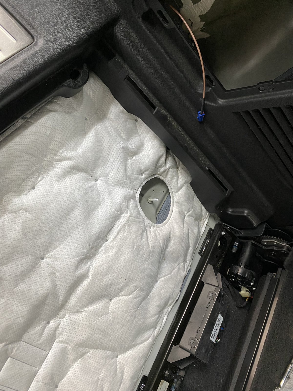

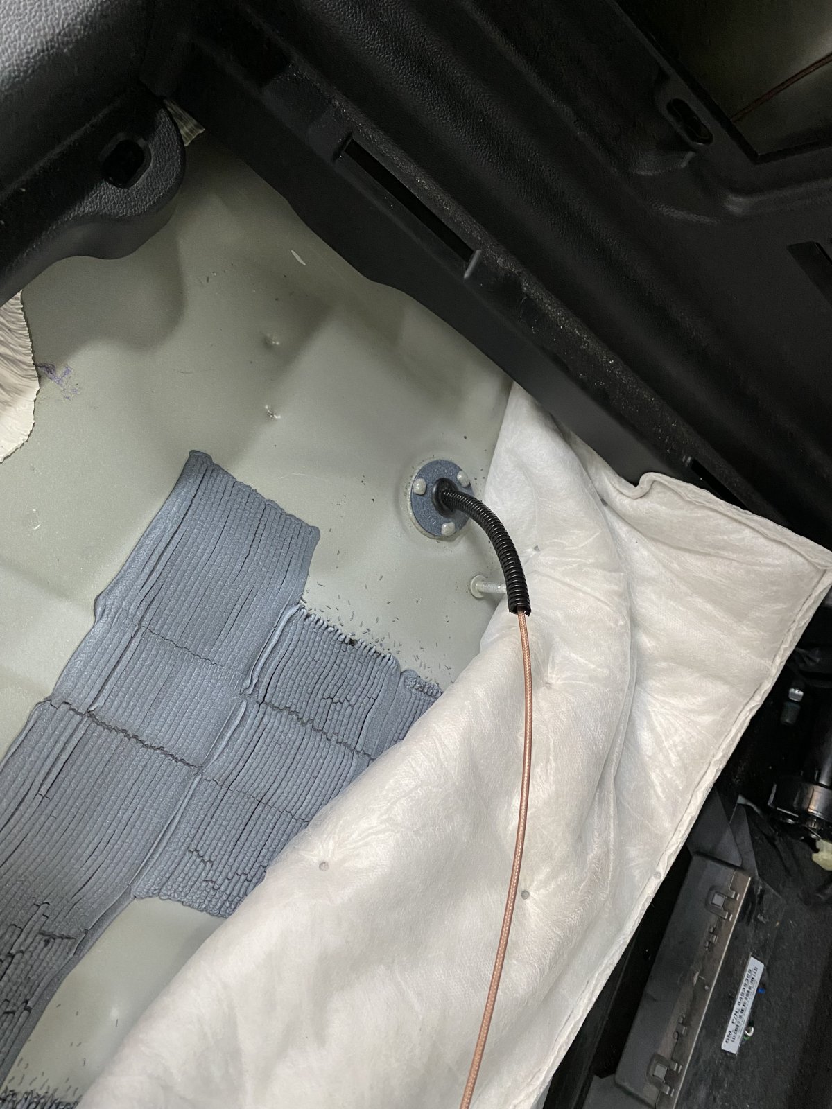

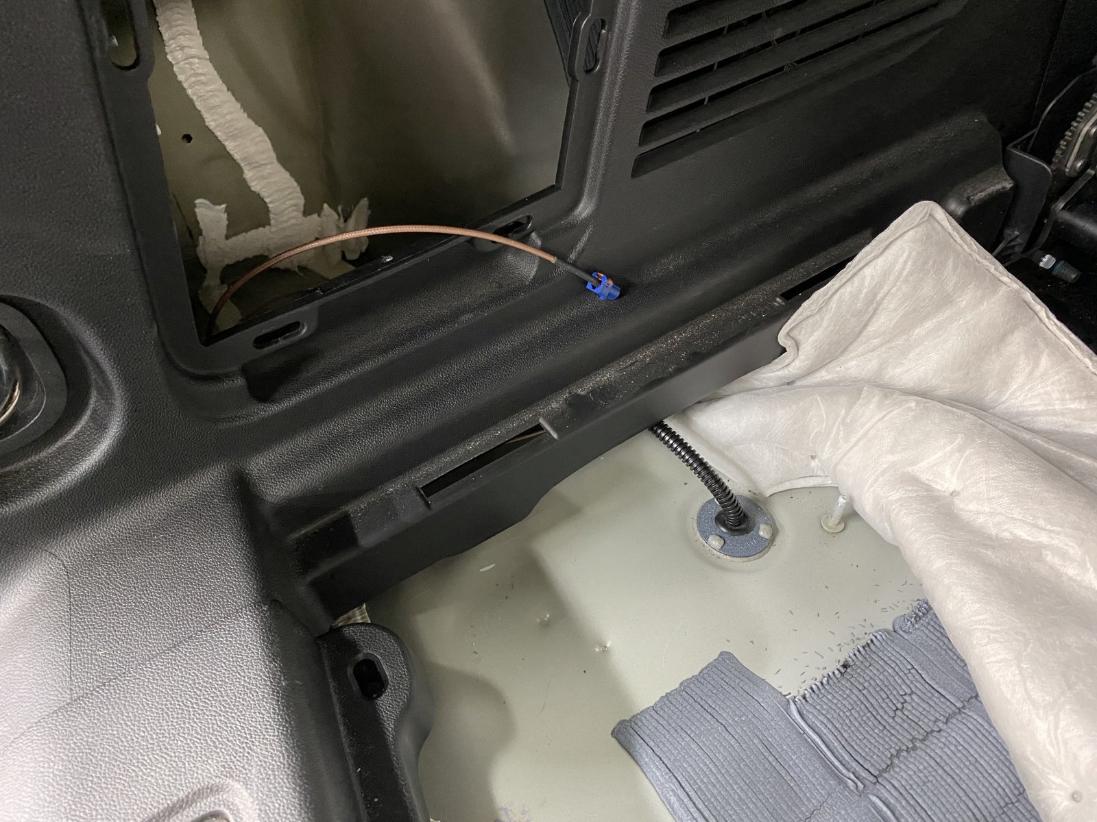

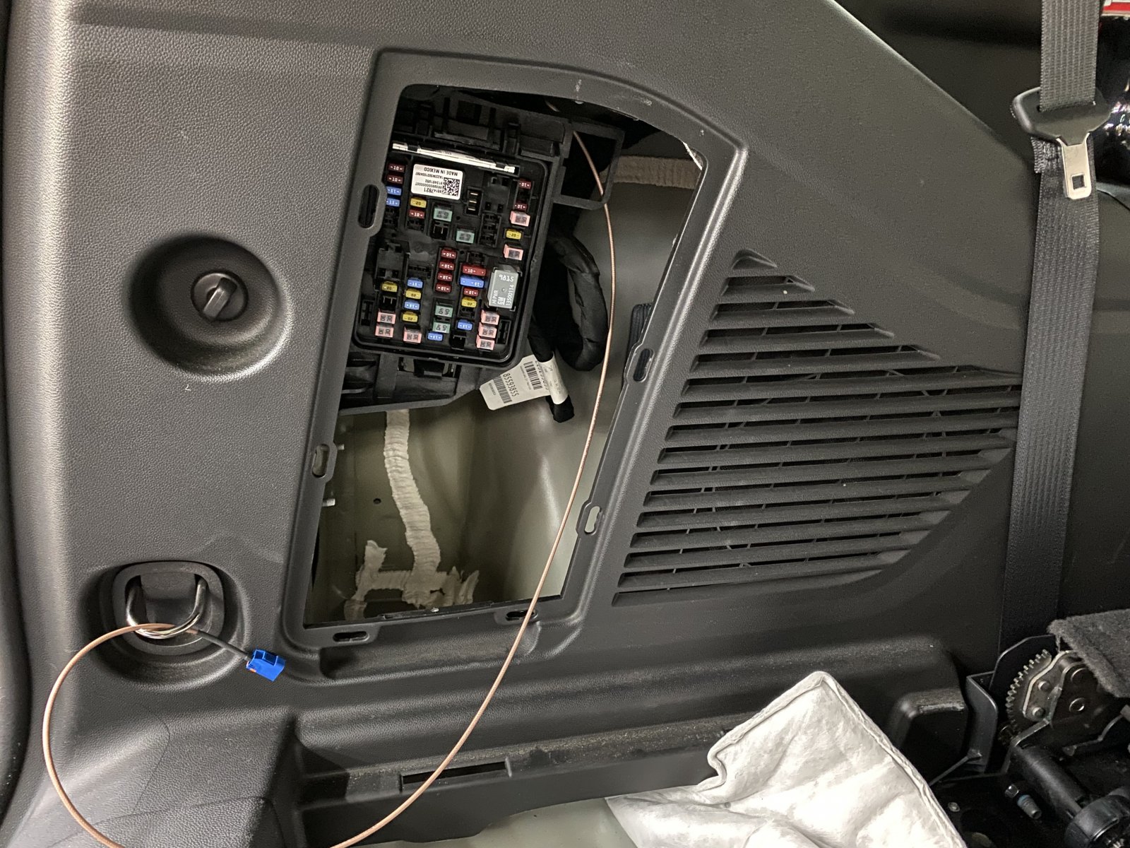

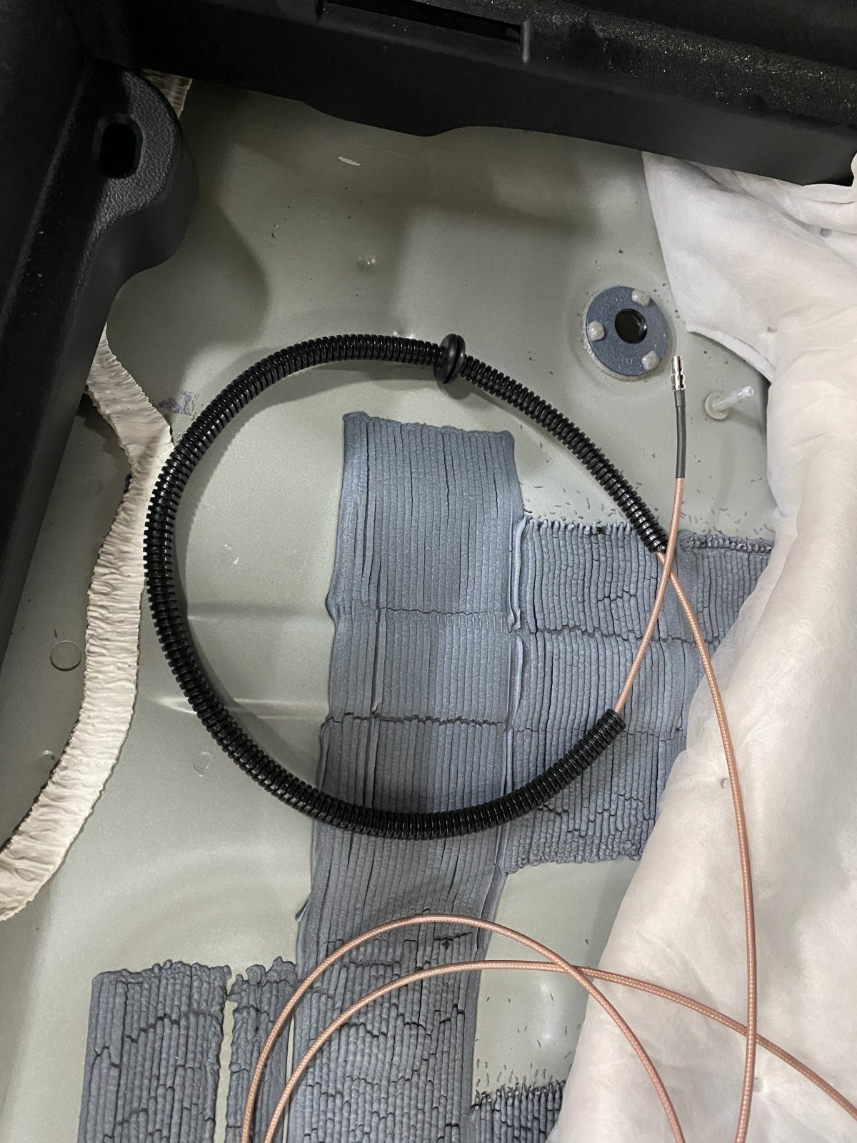

Here is the cable from the rear view mirror, and the rear fuse panel. It is quire straight forward to route the cable to here following infotainment's YouTube video (example is an Escalade but the Yukon and Tahoe are the same) and then feeding the cable down behind this panel from the top. The infotainment cable is black and a bit smaller diameter (RG-174) than the RG-316DS I used. My intent is to plug into either a cable going to the lift gate (OE location) camera or a cable going to the hitch, from this access panel. Longer term, I would like to have a remotely operated video switch here.
After extensive searching for a OE grommet, I decided this plug was the best location to pass my hitch cable from the interior to exterior. I still had to drill a hole but at least it was in an easily placed plug, rather than sheet metal which could be a future spot for rust. It is under the rear storage compartment.

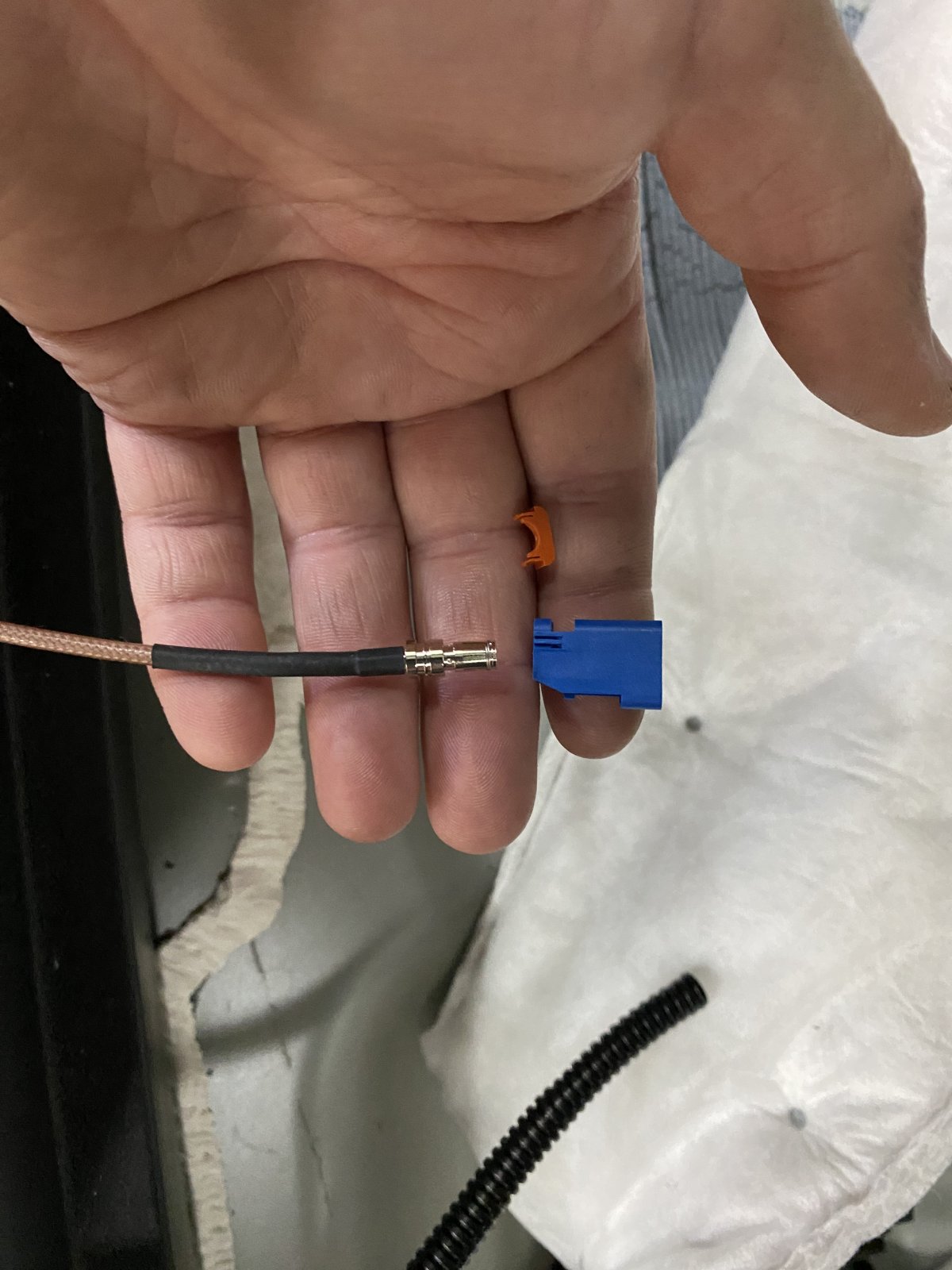

The plastic body of the Fakra connector is easily removed. The infotainment plugs are slightly different but the concept is similar, pry the locking clip out then the housing slides off. This allows passing it through smaller holes or replacing the body if it is damaged or the wrong code.
I used a section of 1/4" split loom and a grommet to protect the cable under the storage compartment and where in passes through the plug. The grommet was just something that's been laying around the garage for years.

Here is the hitch cable tucked under the side panel and into the rear fuse panel / jack (missing in this photo) compartment.
You can't tell the cable is there once the insulation is replaced.

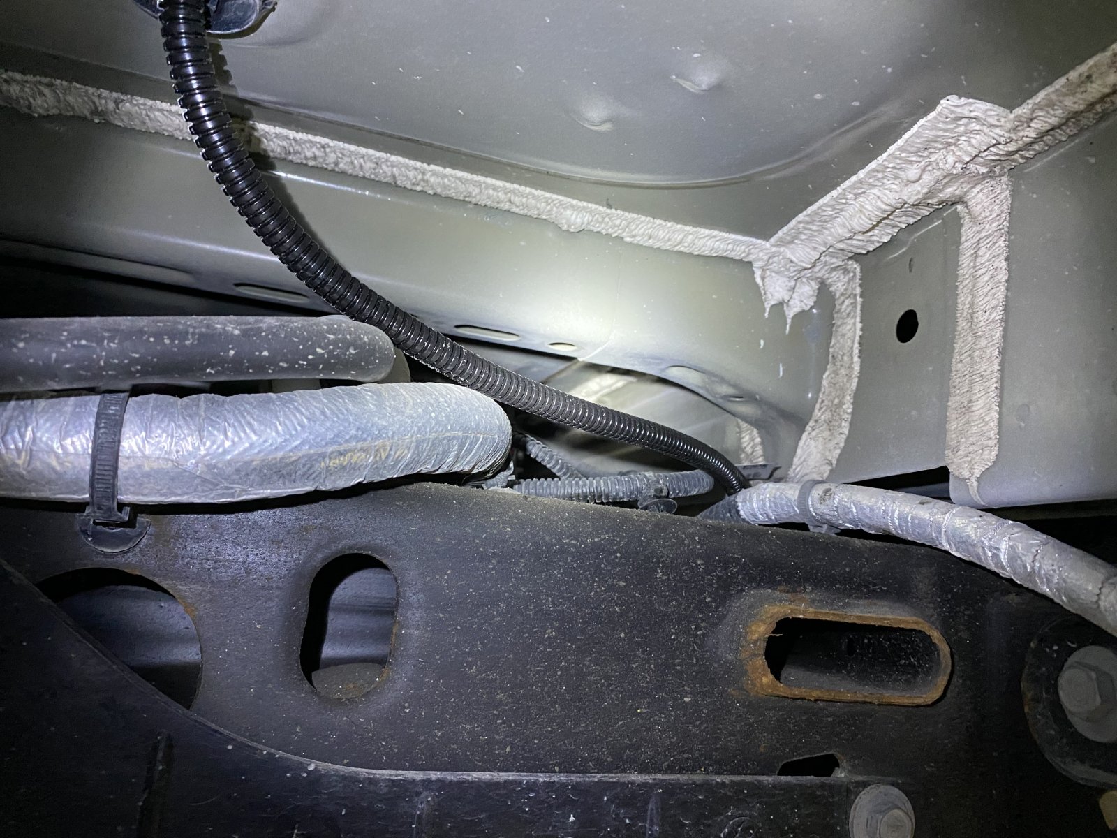

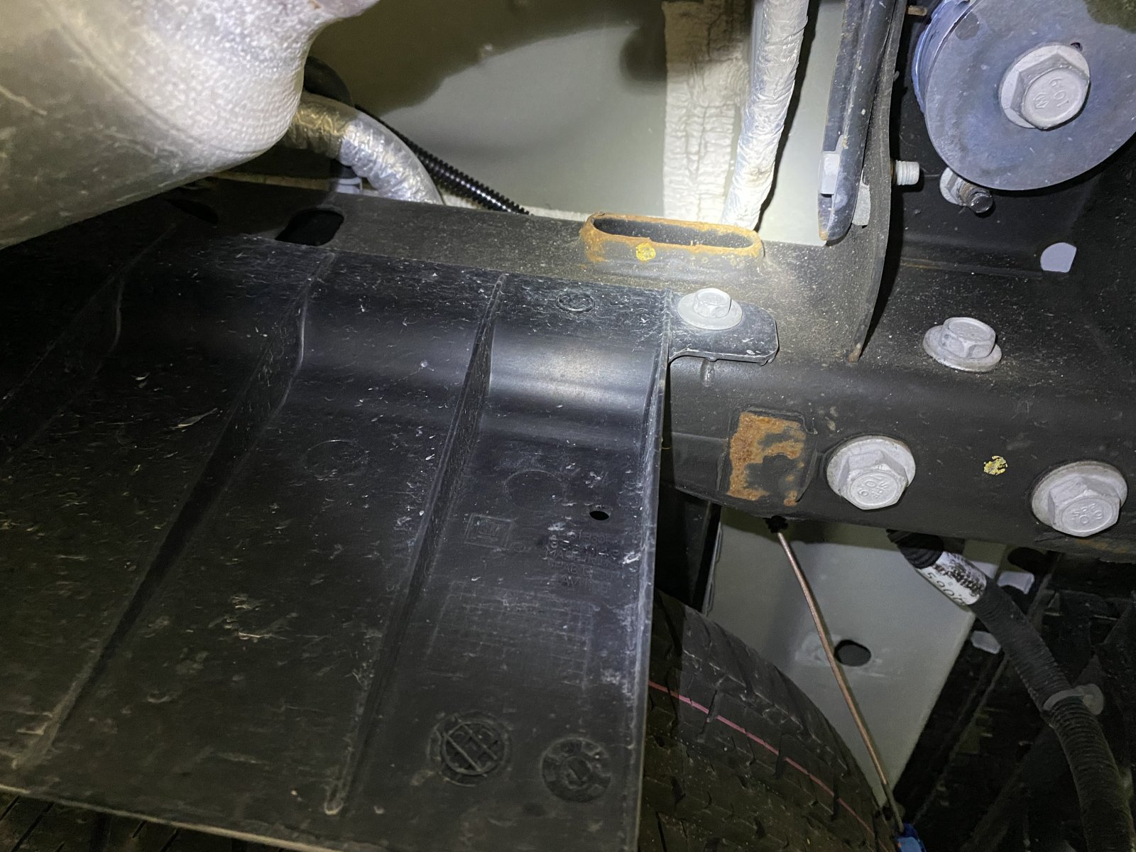

Under the truck, the cable is near the frame rail, approximately in line with the fuel filler.
I ran the cable above the frame rail and later zip-tied it to the existing hoses and harnesses.

The cable eventually joins the OE trailer harness and is zip-tied to it before exiting beside the 7-pin trailer connector.
I will install 1/4" split loom over the full length of cable under the truck, I just used what I had left-over from the camera install on the trailer today.

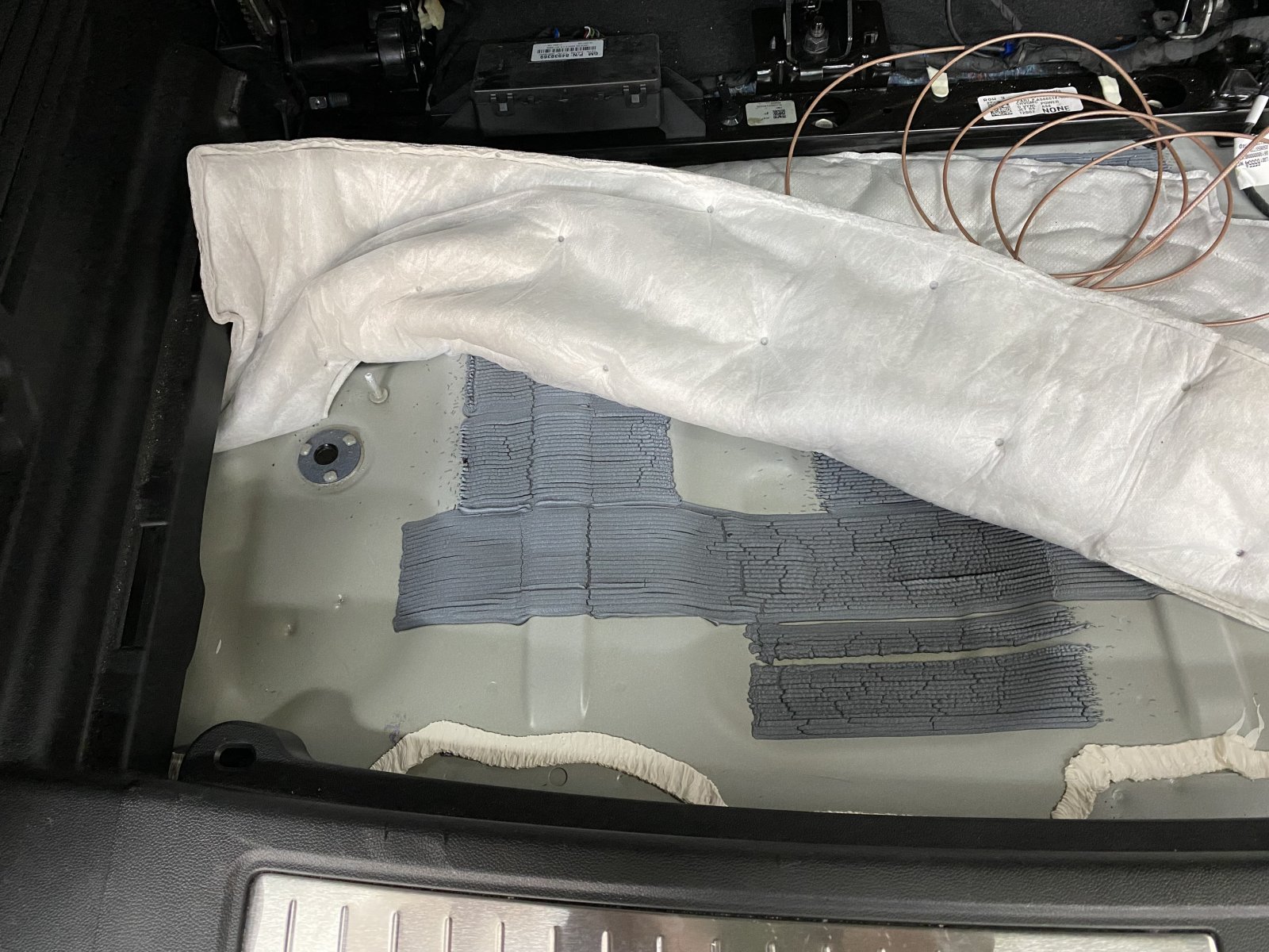

The plug I drilled is located approximately here under the storage compartment. There is plenty of space for the cable due to the feet on the bottom of the storage tray.
The storage tray is easy to remove. Unscrew these 2 thumb nuts (1 on each side) and lift the entire tray and lid out in as one unit.
