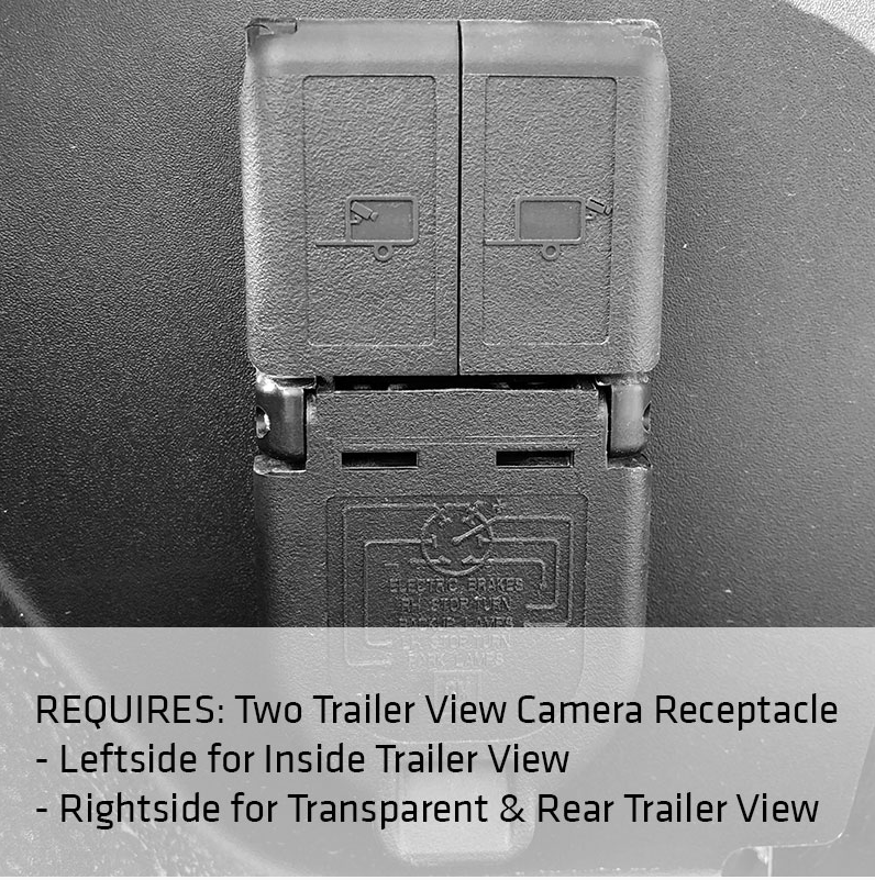

ZM1 gives you two trailer camera input jacks just above the 7-way. Without that option you won’t have those inputs and can’t use this camera.
Good afternoon. Can you please tell me what these two additional connectors of the ZM1 option look like?
StephenPT
Jan 16, 2022
1,252
1,268
St. Helens, OR
Above your 7-Way will be these two camera connectors.
