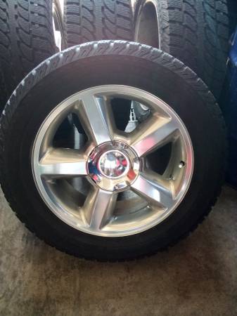

I need to know if OEM 20" wheels will clear Willwood 16" front brakes. So did anyone try them and will they clear. I know on willwood website it says 20" wheels will clear but not all wheels are tha same. Thanks

I dont have an answer to your question, but I think it would come down to the dish of the wheel. If they are deep dished, then I could see a problem. But if they are flat faced, which most are, then you should be in the clear.
But as you say, not all rims are built the same. Some may have a deeper lip on the rim face, so that even thou they are flat faced, the lip brings it in deeper.

I asked in two different threads because i maybe using 07-14 20" tahoe wheels. And im using those wheels just for winter and im planing installing blizzaks tires

I found these 20" from 07-14 Tahoe cheep. Like i said i need these wheels just for winter. Ill be installing Bridgestone Blizzaks on these 20"
