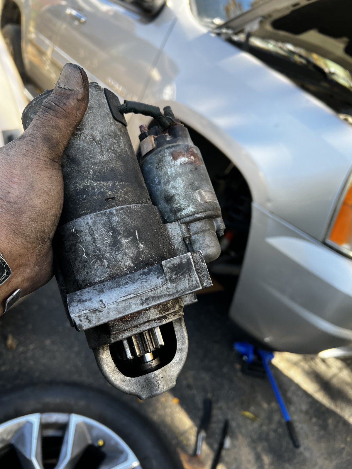

Sparkyz07Denali
Sep 12, 2022
30
24
Starter was dead.
I mean it ran when parked. LoL
New starter, battery and positive cable.
Thanks for the help everyone.
I’m Still floored the starter just died like that.
