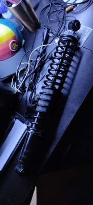

Na I got those ol booty doo shock with the "helper" coils on it. Silly analog stuff.
Nivomats aren't electronic, just self-adjusting. They do come with softer-riding coil springs, so if yours had them and they were removed, you'd definitely want to change the springs to the standard ones.
I don't see any connections for them, my Tahoe is a Less Sporty so it is possible, these are the budget breakers I have on rn, was waiting on the lift to do bs5100s
