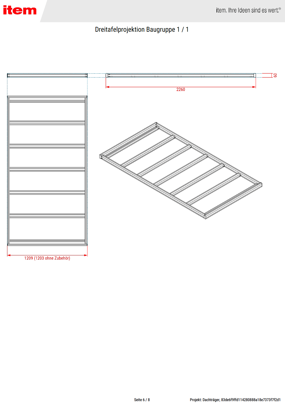

The rack will look like this, it will be made from 60x30 (mm) extruded black anodized aluminum. It allows for a ton of different things to be easily mounted on it. It is fairly cheap as well.
I will mount a 133L aluminum cargo box, two bike axle fork mounts for my two bikes, 2x 500mm OSRAM light bars, 2 work lights on the left, right and rear (rear will also turn on as backup light).
Just the roof rack (without lightbars, etc.) will be about 250-300€ (280-330$).
EDIT: scan the QR code on the first image and when forwarded to the website (which is in German) click on
"Als Gast fortfahren". You can then check out the plans in a 3D program.

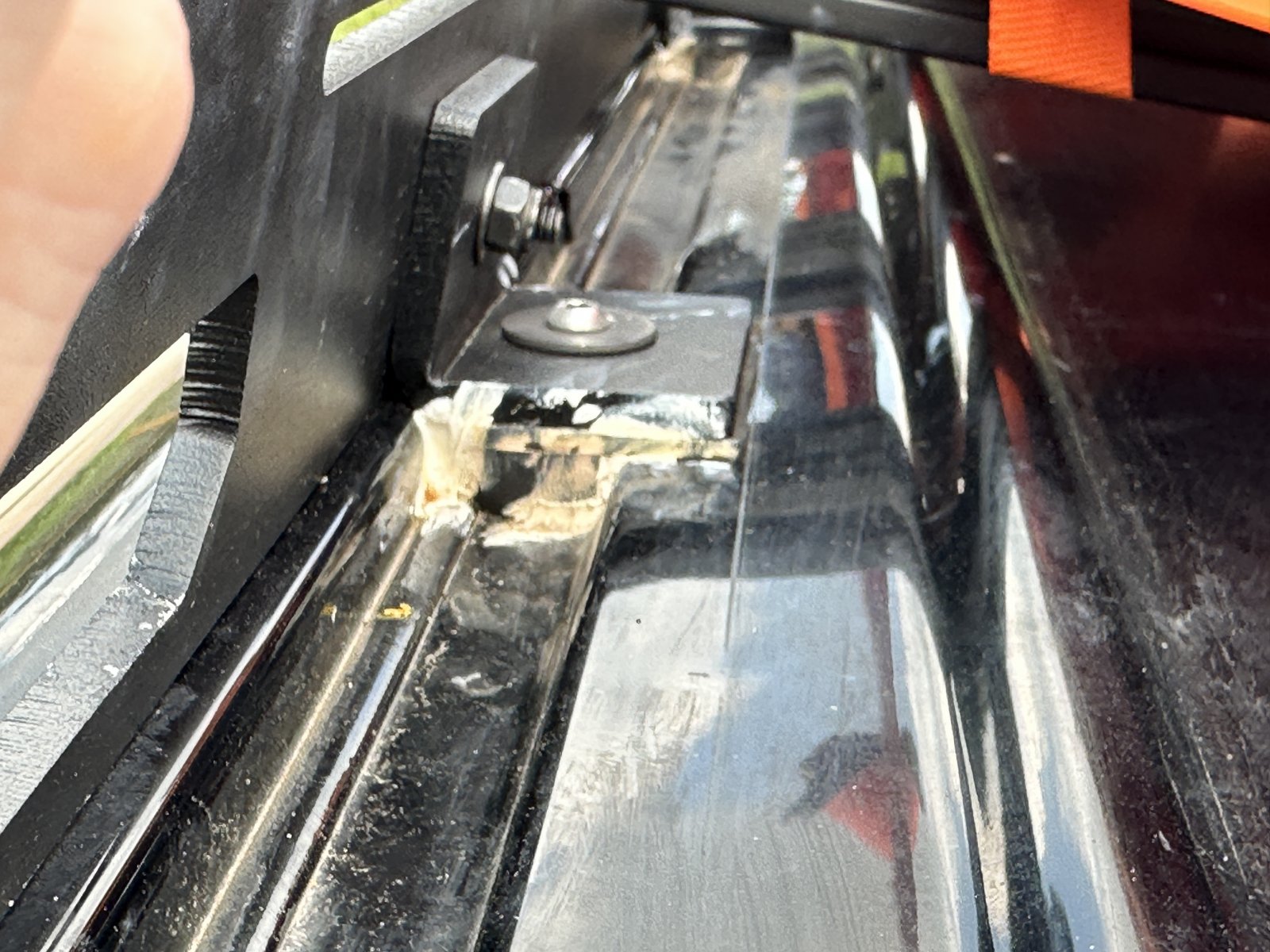

Here are the brackets my rack uses to attach the rails in place of the stock rails.
here’s the whole rack. It’s from Baseline Overland. @mrpeterclark
