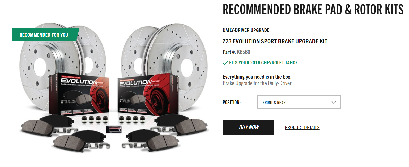

I went with these on my 2016 Tahoe and I like them very much, better than OEM in my opinion and the rotors look great thru my custom summer wheels,
