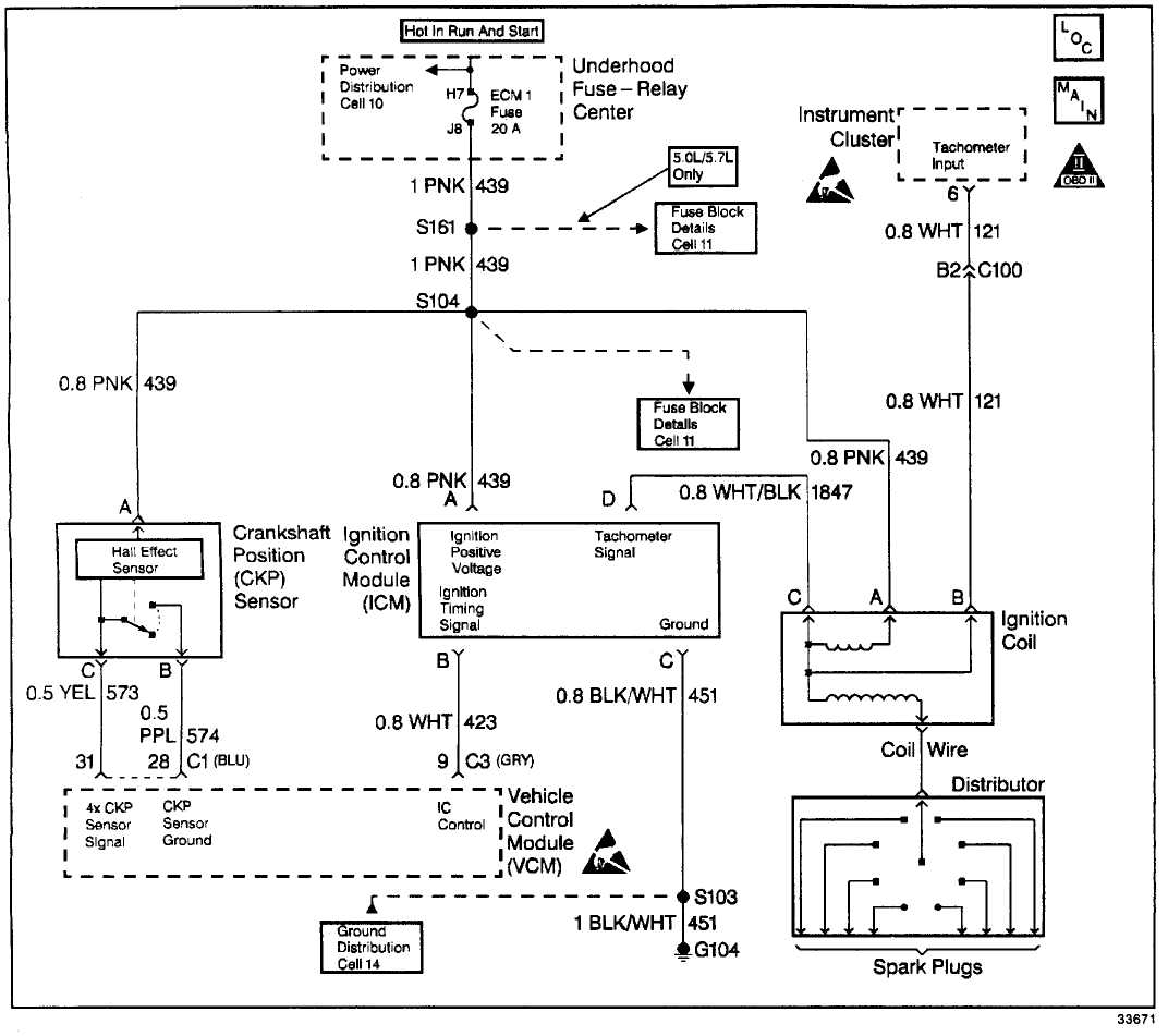

The computer is controlling the timing, so I’m pretty sure that you cannot really set it like this.

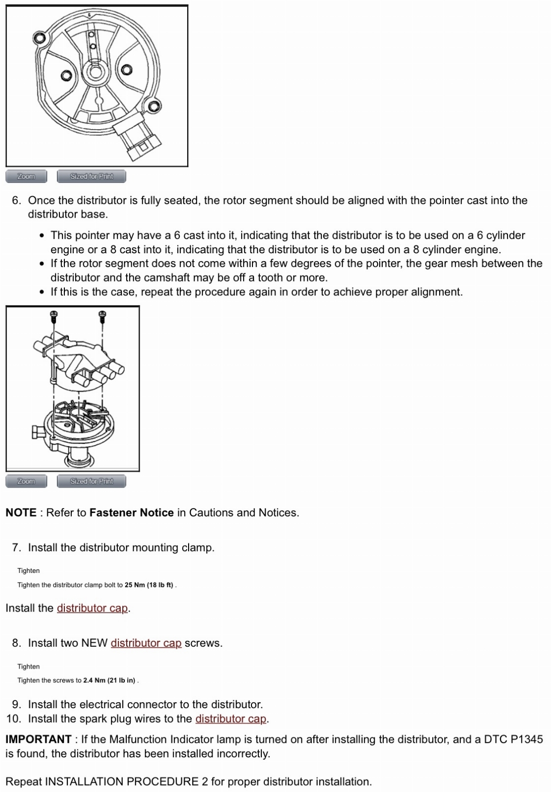

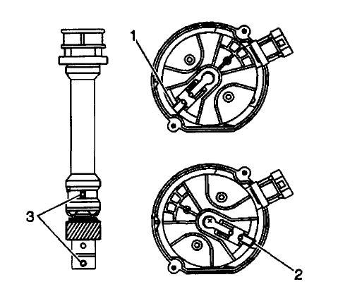

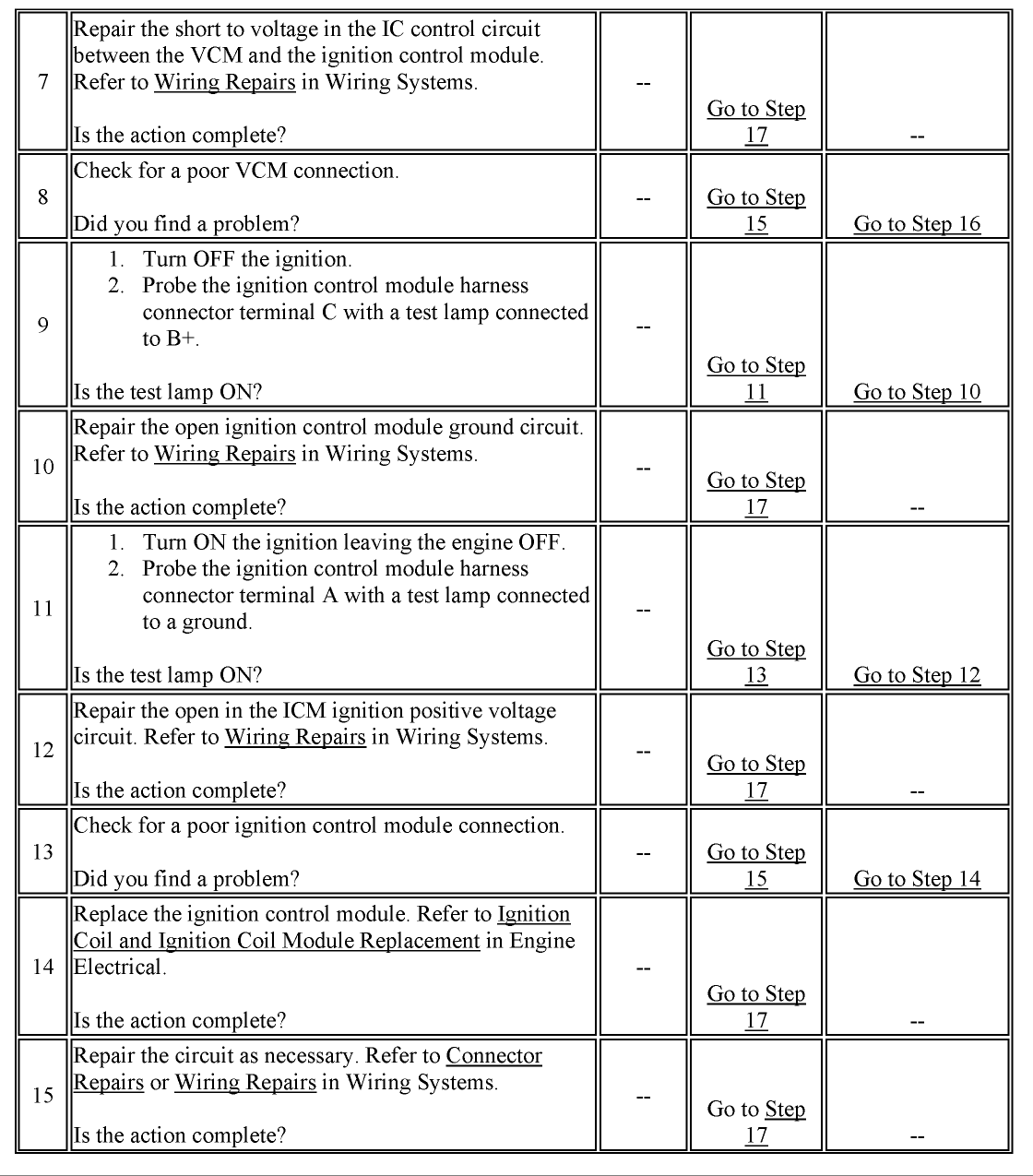

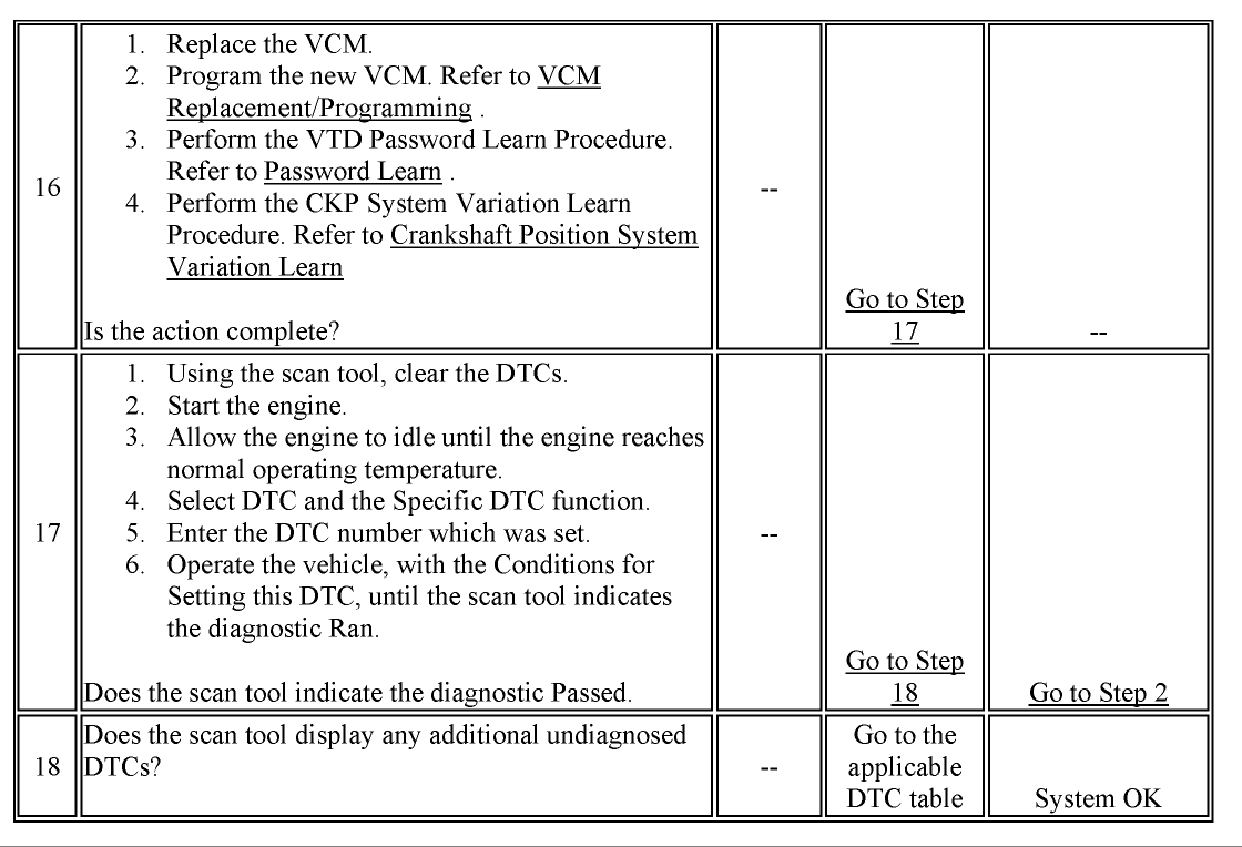

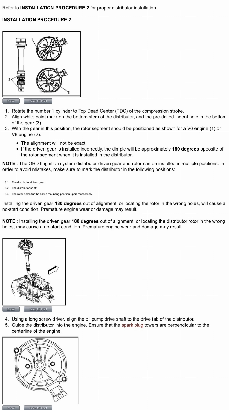

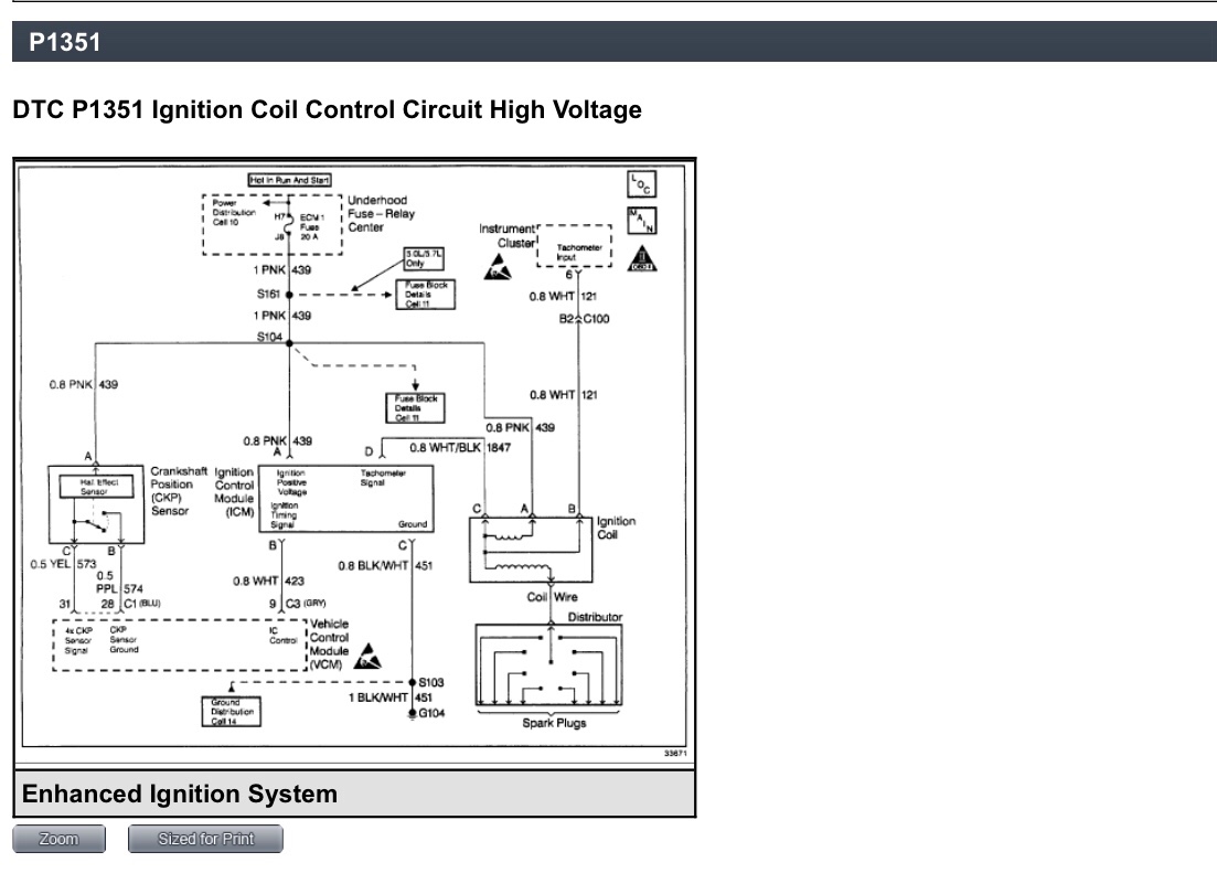

The P1345 code is, as said, the CMP/CKP correlation code being thrown because, likely, the offset wasn’t reset when the distributor was replaced. There’s a thread on here about using an app (CarGauge Pro or DashCommand) with an OBD adapter to set it.

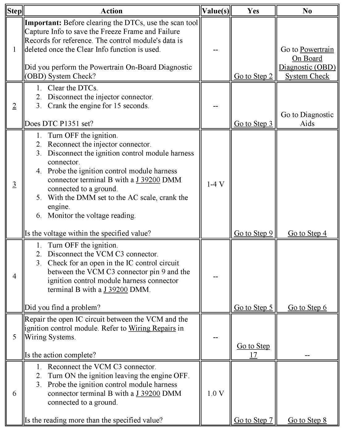

The P1351 code is an ignition issue, so that’s not helping things, either. Here’s the diagnostic table on that.
I’d get the codes resolved and go from there.
Hope this helps.
And here’s the distributor install in case you need it...
