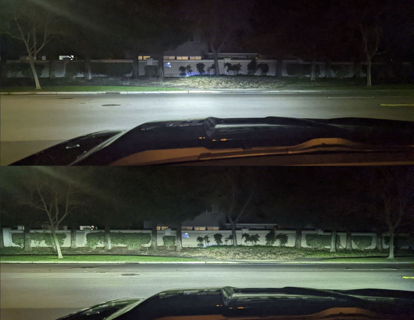

I just put a set of these on; Yellow Pro (36W).
I can tell you that they are leaps and bounds brighter than the OEM fog lights.
I like the amber back light option too; color matches the park lights very well.
Haven't had a fog yet, but did use them during a heavy rain and they certainly helped light up the road with no glare.
