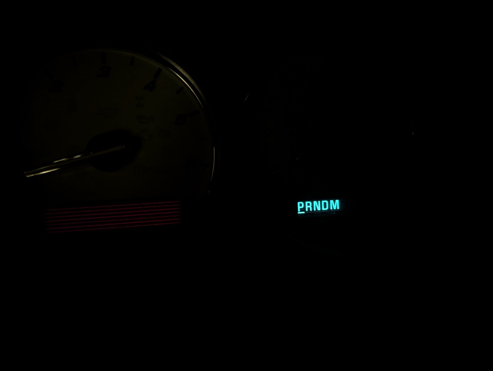

Every morning lately the dash is dim. Bright enough for sunglasses (cloudy) but my dash is dark.
