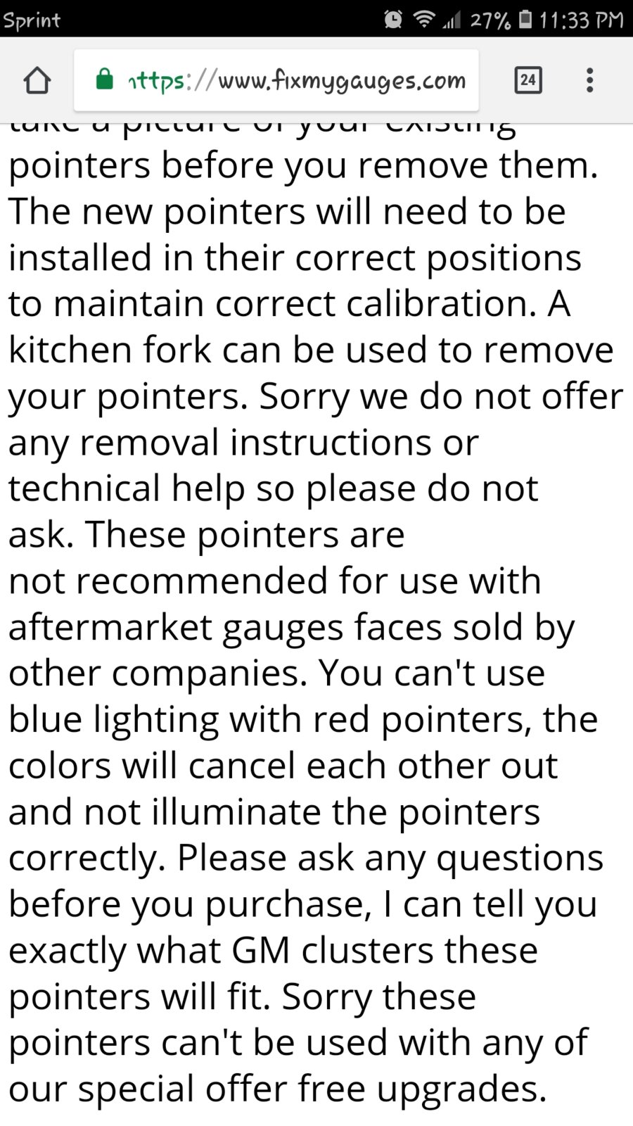

Anyone do (or have a picture) blue LED's with red needles? Wondering how the lighting turns out with the red and blue
If you read on digital dash solutions page somewhere there's a disclaimer about some color needles not lighting up with certain color led gauges. I think the combo you're asking about may be one of them. The colors cancel out or something...

This is in the "premium pointers" Section, but I don't know why it wouldn't also be true of standard ones... I could be wrong.
