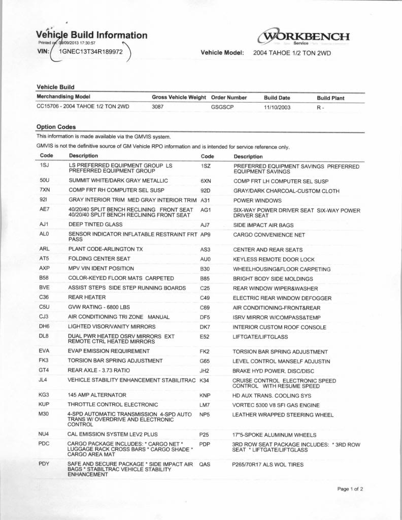

When I was at the dealer, the service manager took my VIN and ran the build sheet for my Tahoe (I suggest you get a build sheet for your vehicle). I was given the print out on my build, nowhere in the codes does it mention a limited slip differential, so it doesn’t have one – I don’t need to add friction modifier.

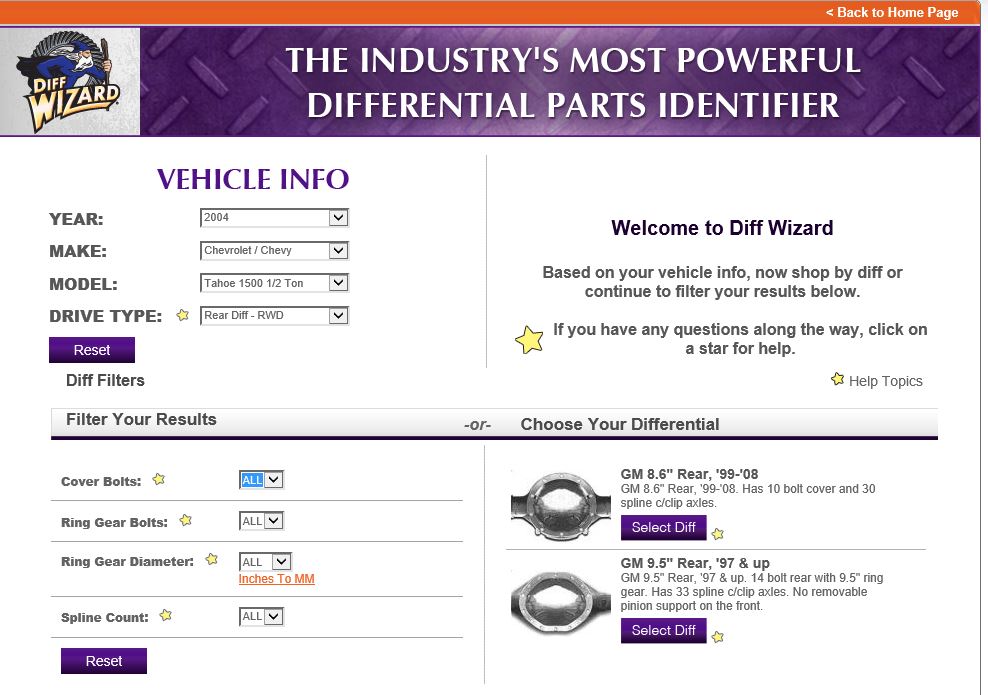

When I went to http://www.ringpinion.com/DiffWizard.aspx and plugged in my information, I came up with two different differential possibilities – either an 8.6” or a 9.5”.
Since the results listed two different potential rear ends, with a different amount of cover bolts, I got under my Tahoe and counted cover bolts – I have 10. The 8.6” has 10 bolts and the 9.5” has 14 bolts, so mine is the 8.6” rear end.
