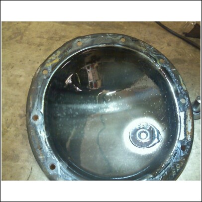

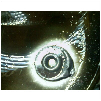

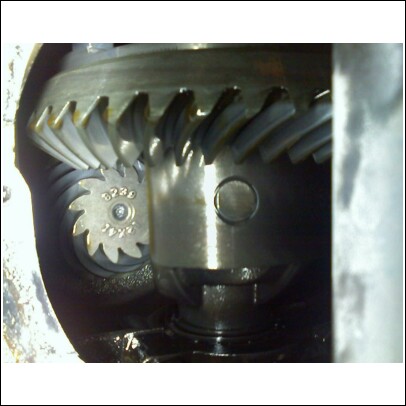

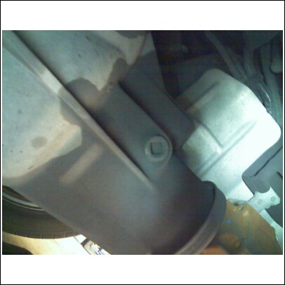

Done! Not so bad. Put a very small bead of RTV. CLeaning the old gaskets off with a razor blade seemed to have taken the longest. But did my best to get it as smooth and clean as possible. I had no drain hole. Also there was magnet on the pay to catch any shavings. I may have put more that the 2 & 2/3 bottles of Royal Purple but kept checking for fluid. Either way also did the motor oil change. Took it for a test drive and running good and smooth. No unusual noise or feeling. Now I need to do the Tranny with RP.
Brake cleaner I used to clean the pan and sprayed the differential out get all the crap out. The fluid & the gears did not look bad but, on the pan around the magnet I could see build up of mettalic funk. Got it all clean now.
