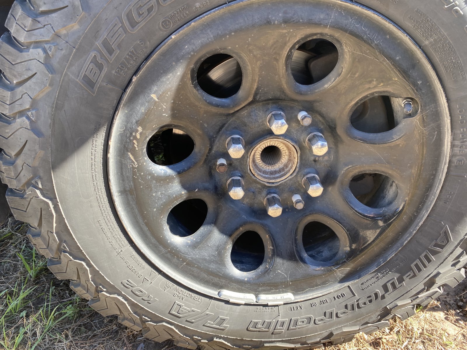

So I had my tires changed the other day and it seems I have a 4WD bearing on the left front and a RWD bearing on the right front. I had noticed that they looked different but never made the connection.
It drives fine, are there any drawbacks to this setup? It 's a 2014 PPV and I'm always finding little surprises like this. Thanks.

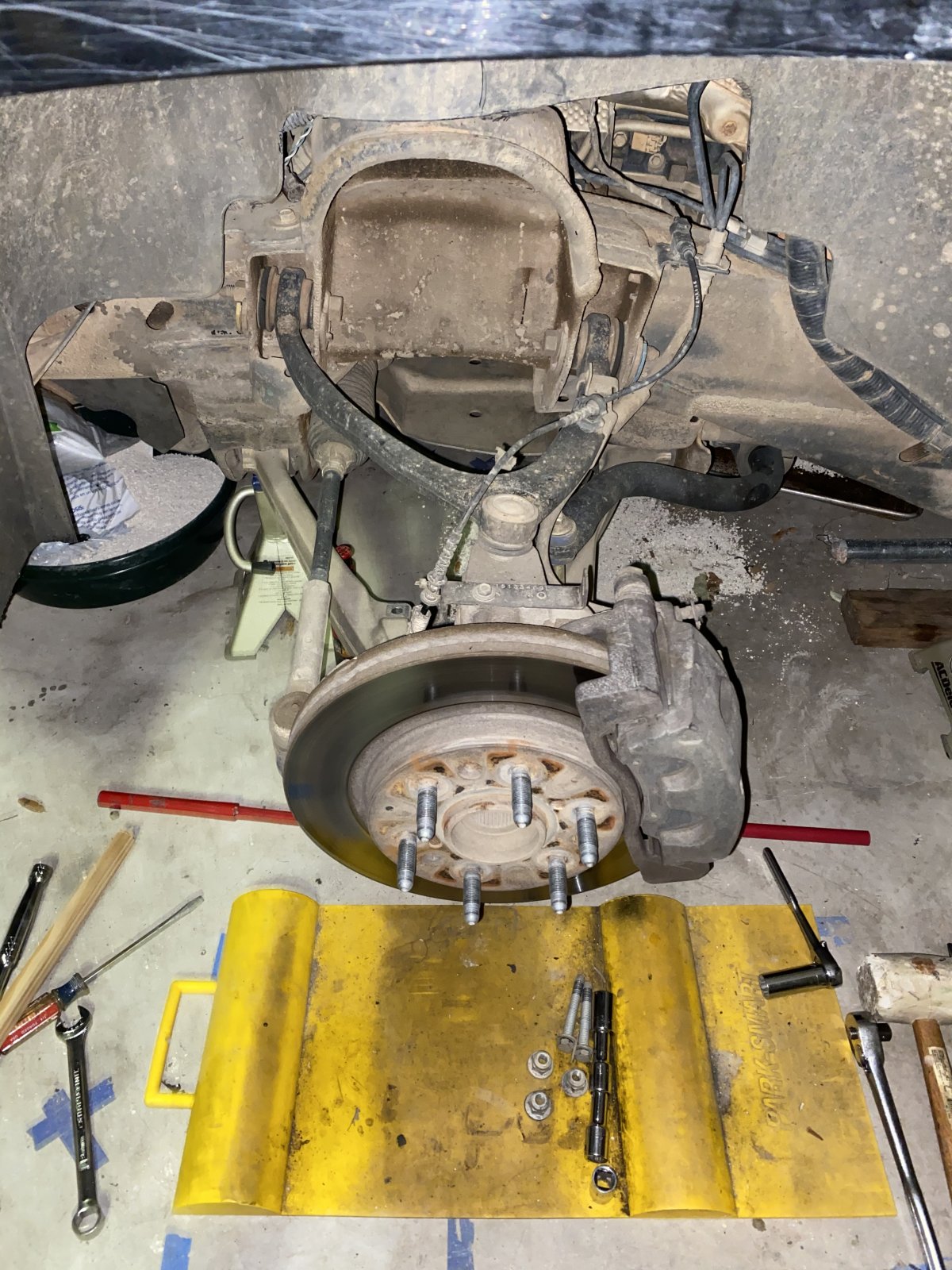

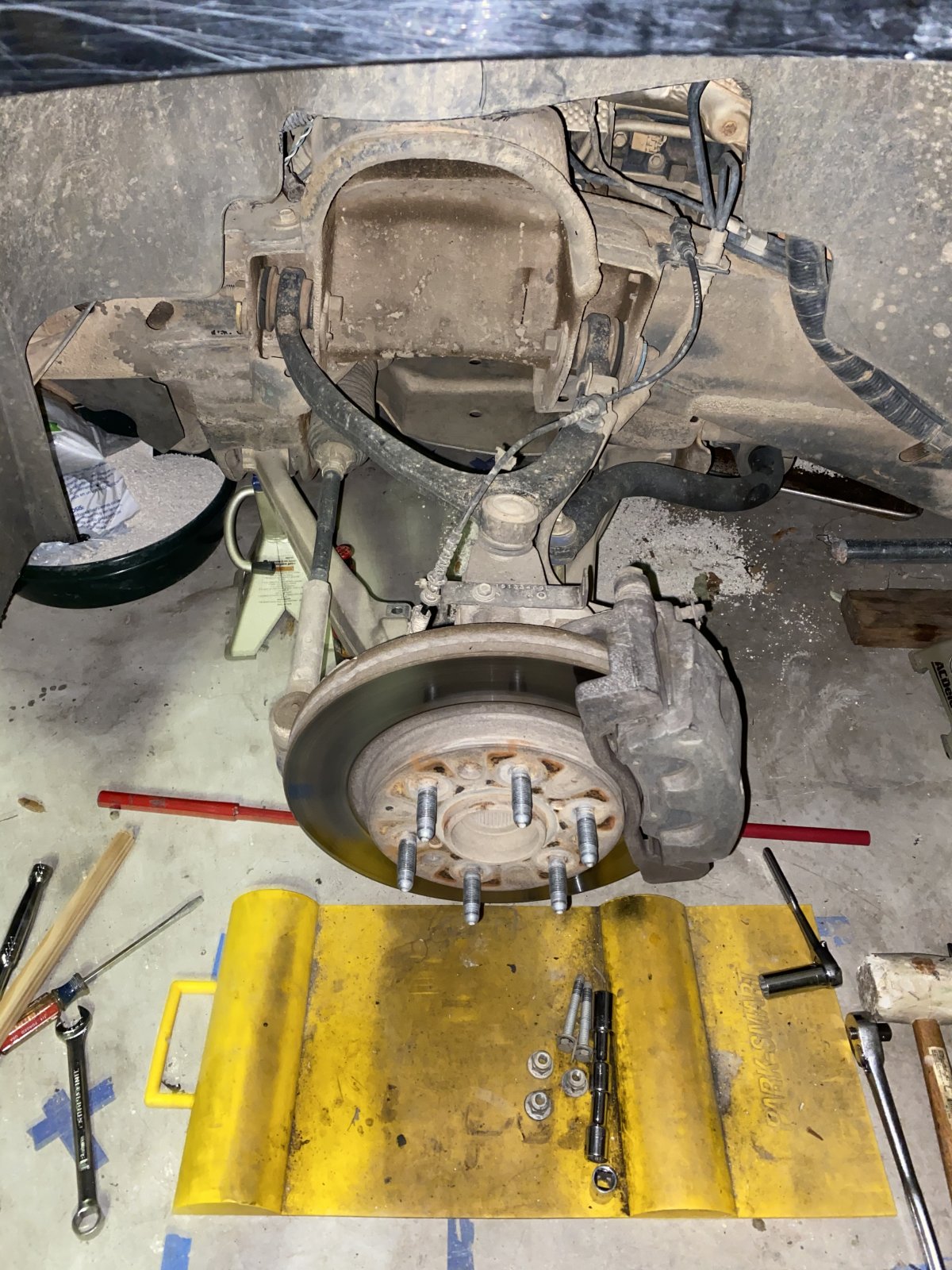

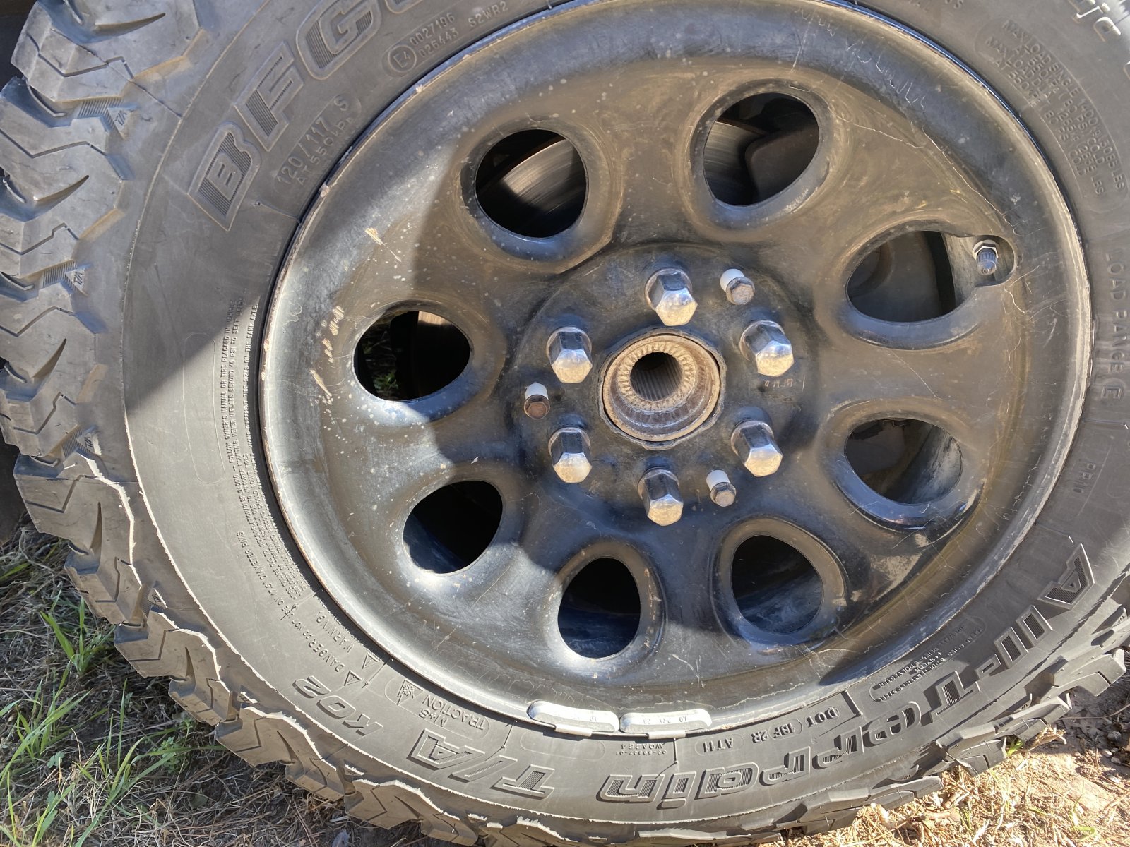

First two, me changing the hubs on thecopcar at 195k. Last pic was after several overland trips, the most recent one to Big Bend.
