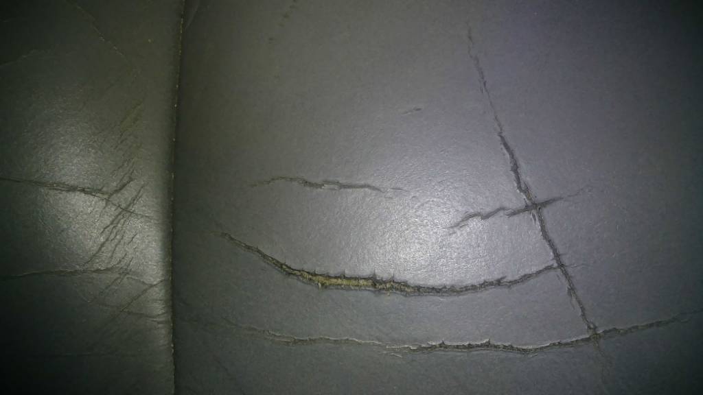

While I'm on it, for my cracked seats, I got a $6 bottle of matching color acrylic paint from Michael's. Worked great!
I have couple deep cracks . I was thinking filling with permatex let dry then add color .. I have gray seats also what's number on bottle ? 922 is number in glove box .

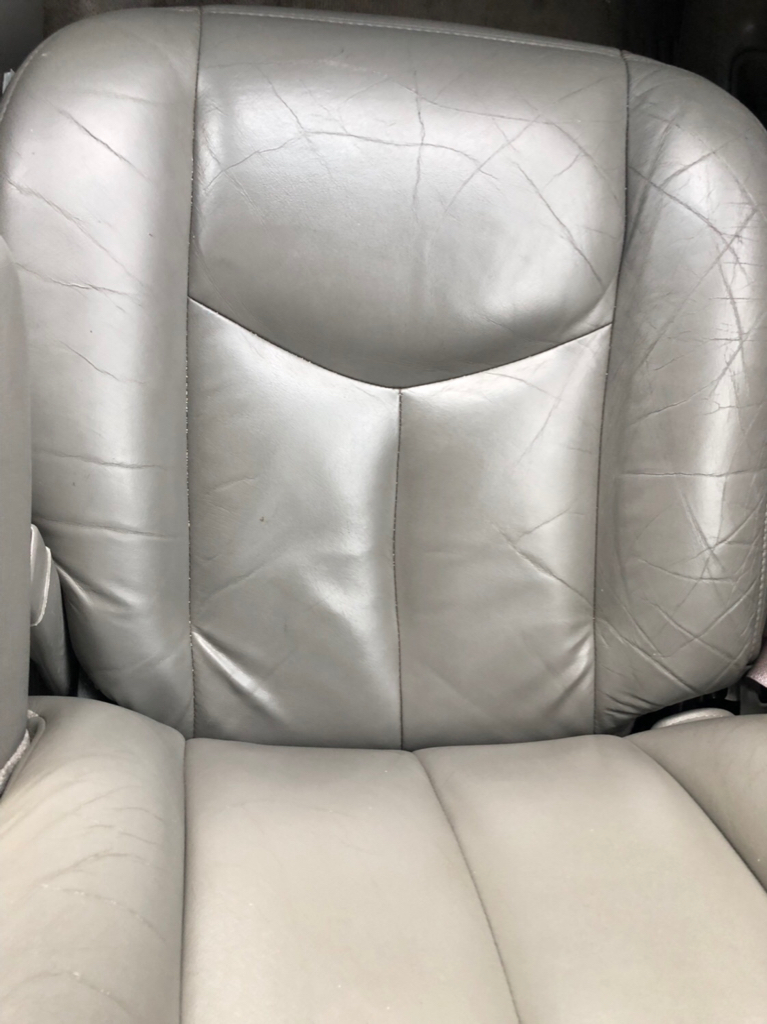

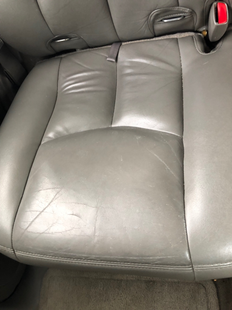

I had many cracks with very ugly yellow showing. I got a handful of white rags from Walmart. I wiped the cracked areas first with denatured alcohol to clean the cracks and surface. Using a Q-tip, I began experimenting with the 3 colors of paint. The middle tube is the "professional" grade for $6, found with the painting supplies at Michael's.
I used the Q-tip like a pen. Dip in paint, fill along crack. I would only let it sit as long as it took to do 2-3 cracks. It does overfill and leave heavy marked lines. I then used a dampened rag to wipe the seat clean. This removes excess off the surface while leaving paint in the crack. You might need 1-2 applications.
Mine came out great. We were going on vacation and would have extended family with us. The cracks were embarrasing. Seats really look great now going on a month of use.
