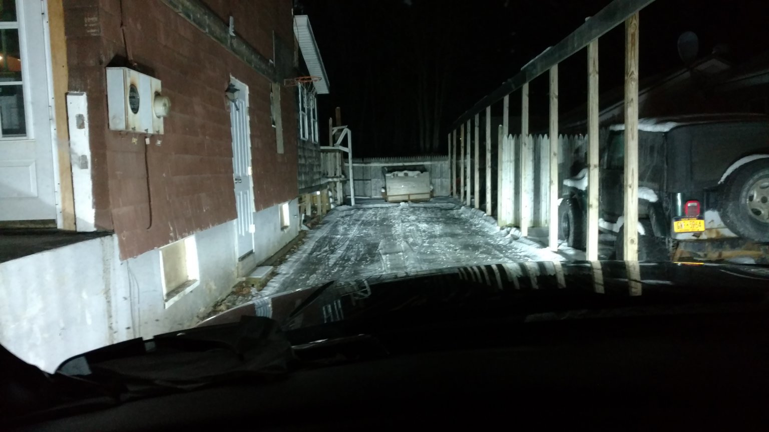

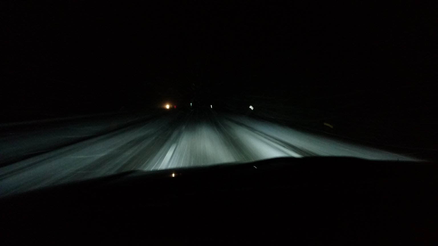

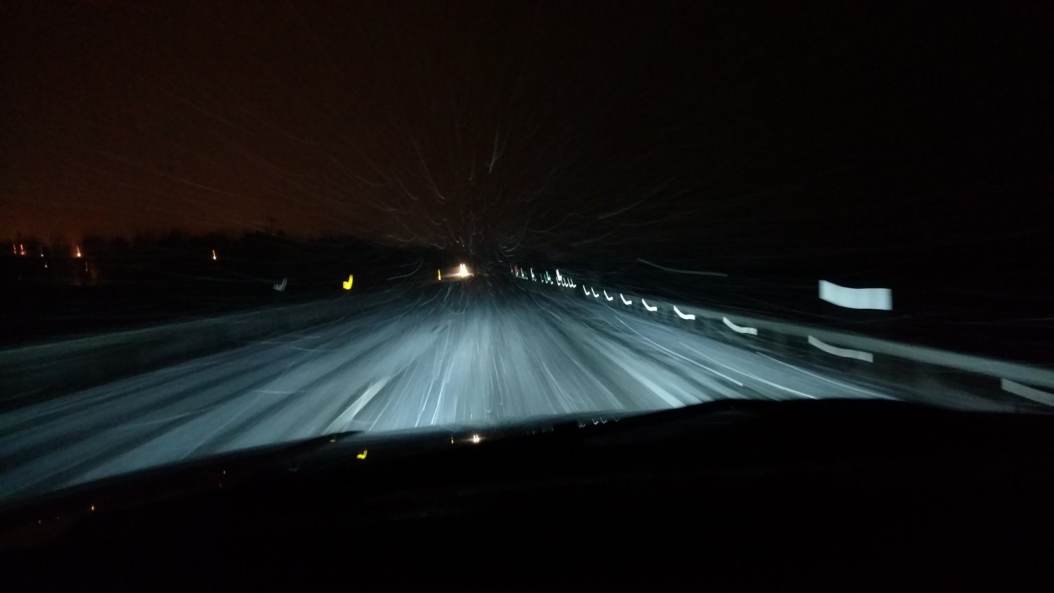

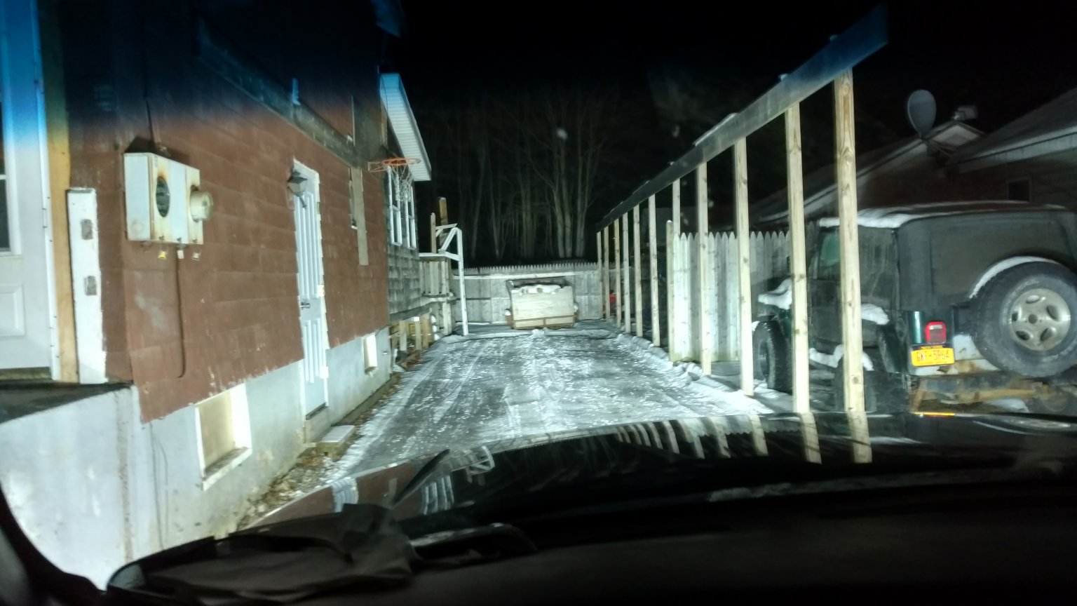

Simple LED swap is all you need, UNLESS you really want to change the look and go with the depos. Got mine on E-bay, under $75 shipped for the 9005's and 9006's.
Lows and fogs
Lows and fogs and highs
Lows and fogs and highs and LED Bar
Lows and fogs

While that's much better than stock, it's not all that impressive...
My quad retrofit alone has more output than all your lights plus your lightbar...
May just be the picture, I know it's hard to capture. View media item 23983

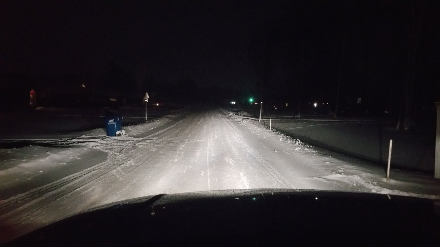

I bought some aftermarket Denali projectors, and I like them a lot. (see this post for pictures and links to Amazon where I got them)
Halogen bulbs:
$30 HID kit:

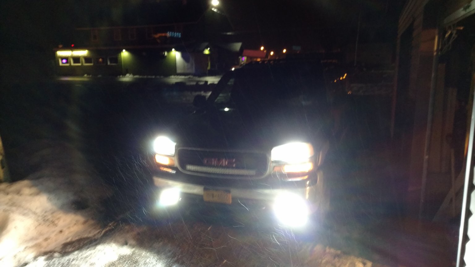

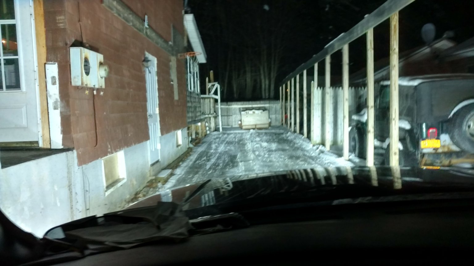

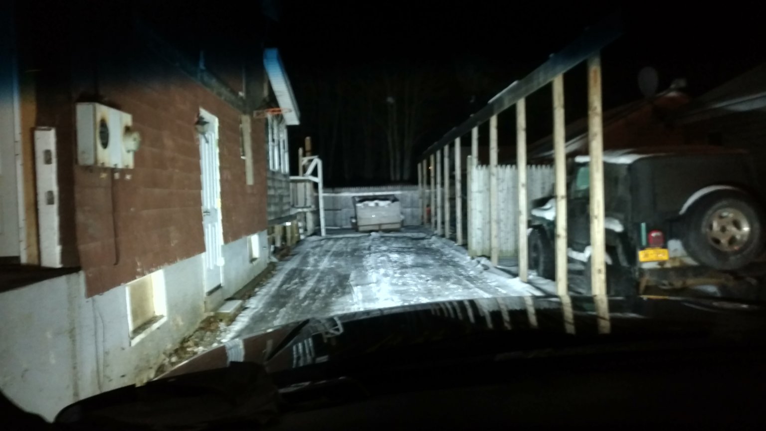

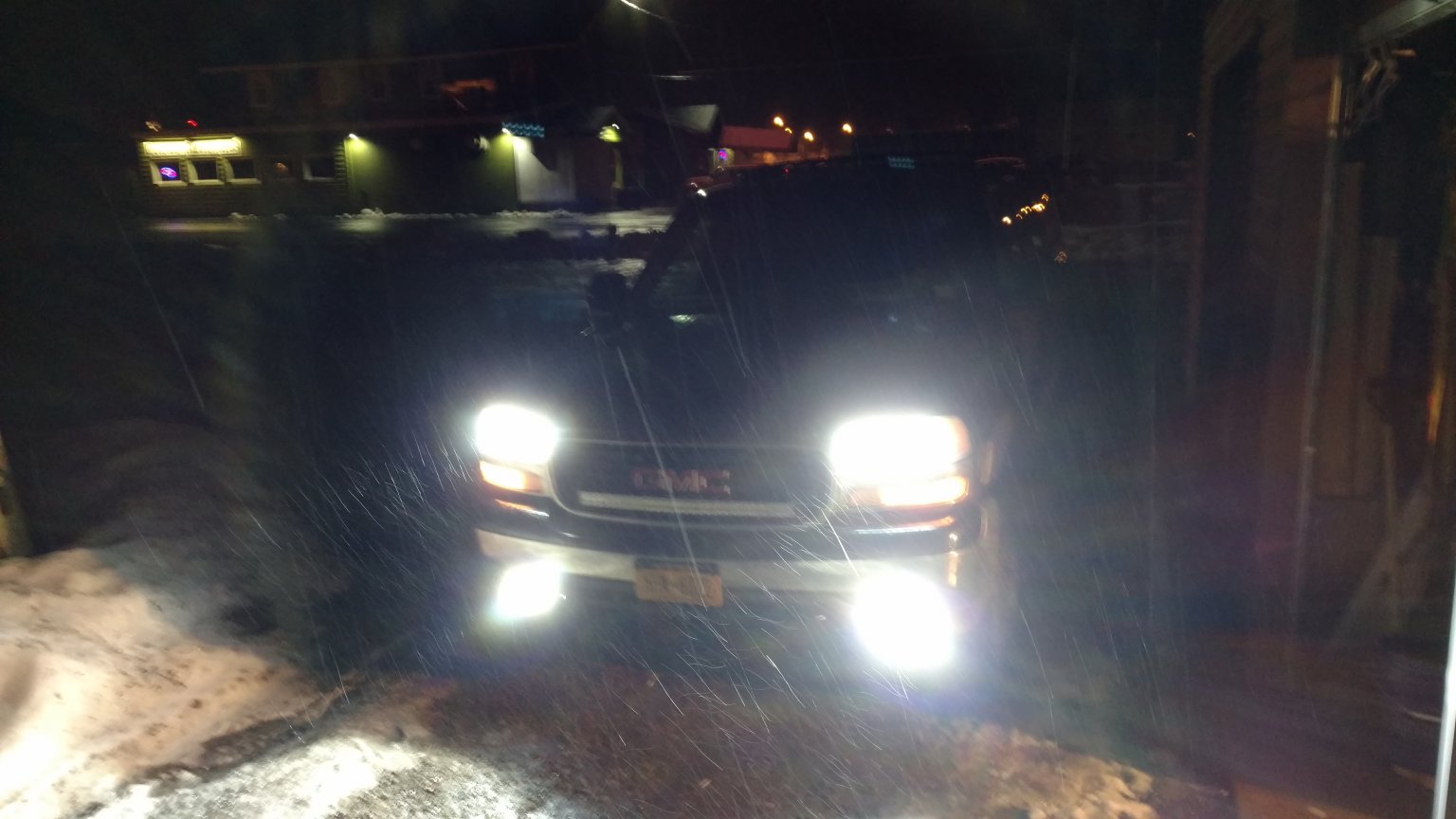

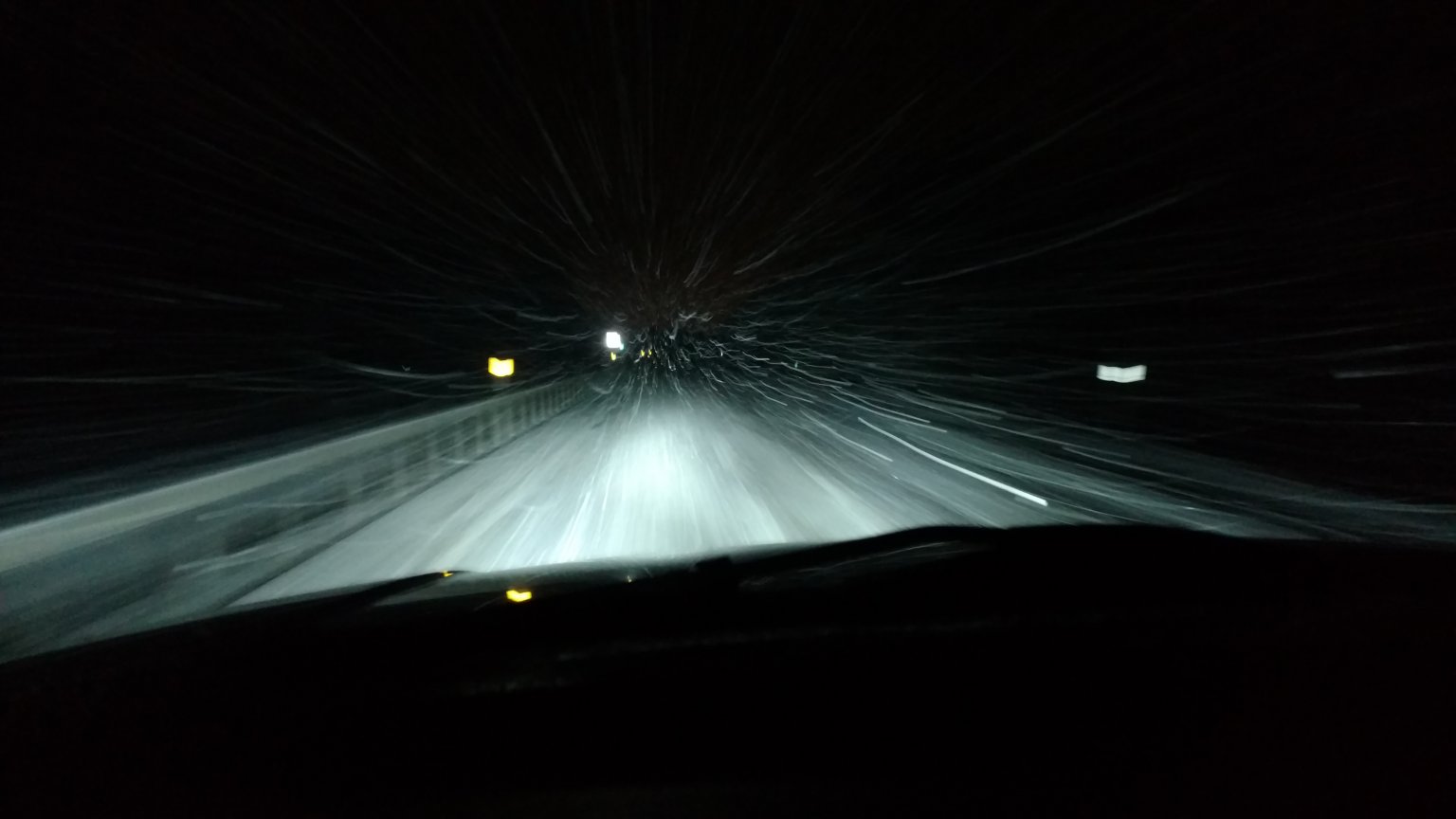

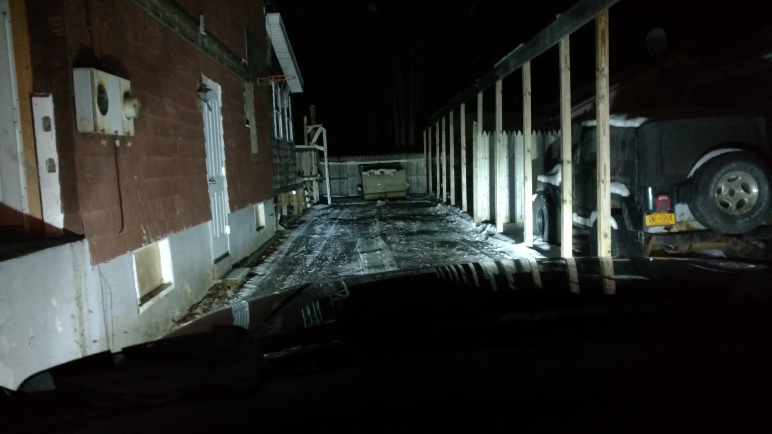

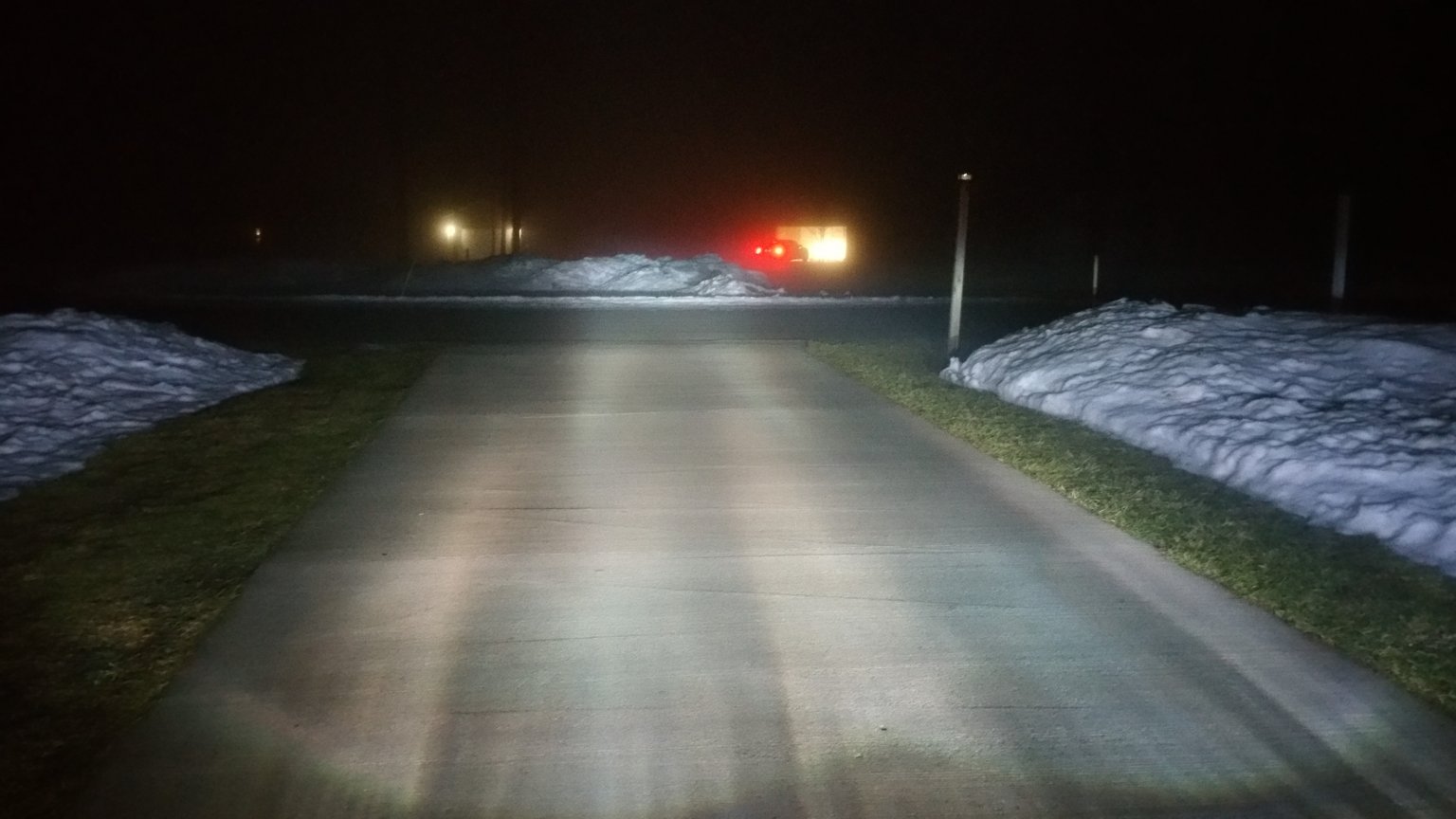

These better?????
Fogs only
Fogs and lows
Fogs Lows and highs
Fogs, lows, highs and light bar
Light bar only

That's much better. Actually shows something. However look how much light is above the front end. That looks very blinding for oncoming drivers. Hows the width?
I understand the ease of just swapping bulbs, but why not just do a retrofit and be done?
I'm not trying to be rude, I reread my first post and saw it came off that way, I apologize.

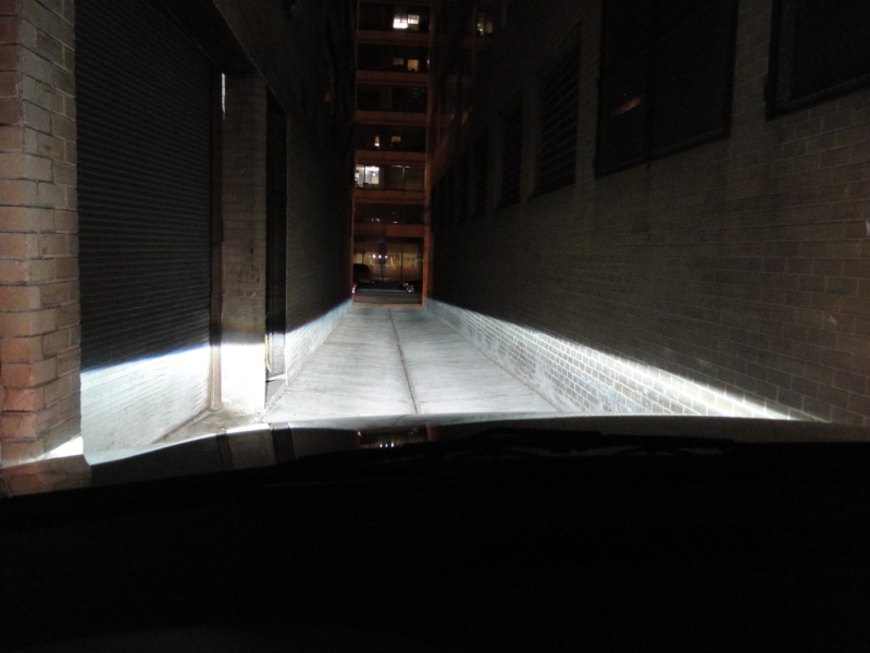

This is the exact reason NOT to just throw LEDs or HIDs in a non HID/LED projector housing. If you look at my cut off line picture below, you can see how none of the light is blinding oncoming drivers. Every bit of light is being used on the road. In your picture, this is no cutoff. You are blinding oncoming traffic...

Actually, I'm NOT blinding traffic. I'm friends with a few cops locally, and they have said that my lighting is directed low enough so that the hot spot isn't in their eyes. Could be that I'm parked on a very slight grade here, it may seem worse than it actually is.
My previous pictures were out on an open highway, again, not as bad.
