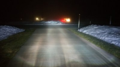

These better?????
Fogs only
Fogs and lows
Fogs Lows and highs
Fogs, lows, highs and light bar
Light bar only

That's much better. Actually shows something. However look how much light is above the front end. That looks very blinding for oncoming drivers. Hows the width?
I understand the ease of just swapping bulbs, but why not just do a retrofit and be done?
I'm not trying to be rude, I reread my first post and saw it came off that way, I apologize.

73958
This is the exact reason NOT to just throw LEDs or HIDs in a non HID/LED projector housing. If you look at my cut off line picture below, you can see how none of the light is blinding oncoming drivers. Every bit of light is being used on the road. In your picture, this is no cutoff. You are blinding oncoming traffic...

Actually, I'm NOT blinding traffic. I'm friends with a few cops locally, and they have said that my lighting is directed low enough so that the hot spot isn't in their eyes. Could be that I'm parked on a very slight grade here, it may seem worse than it actually is.
My previous pictures were out on an open highway, again, not as bad.
