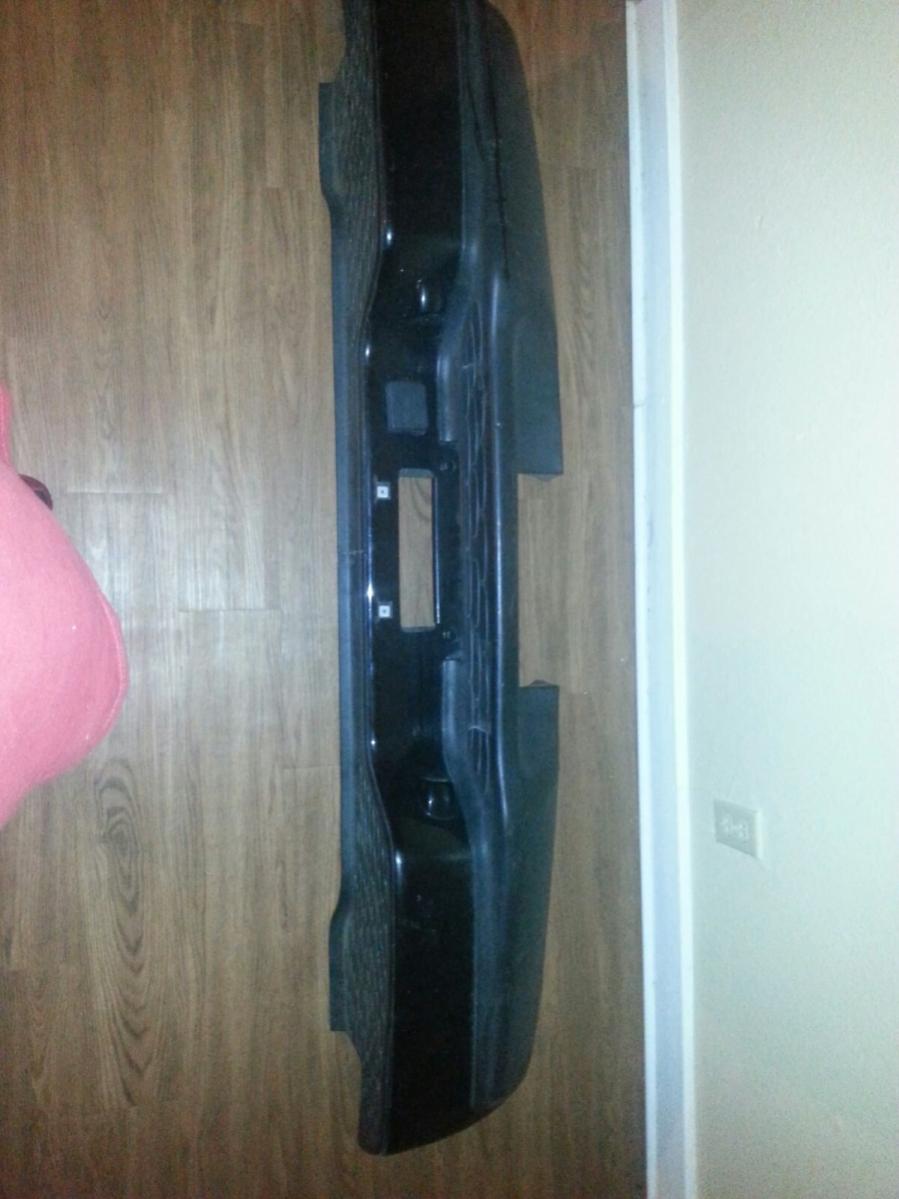

Found a denali rear bumper for a good price and it's already black, so no need to do any painting. My question is how does it attach the guy sent me a pic of it but from the pics it looks like it's only a cover?

The Denali has a specific bumper, as well as bumper cover and step pads. It looks to me in the picture that there is only a bumper cover and pads. You also have to get the Denali bumper brackets too, they are different. It is easy to do when the entire rear bumper is removed as an assembly with the brackets attached.

Easy swap and great mod! Do it. I am for mine. Wife likes her cover though.
