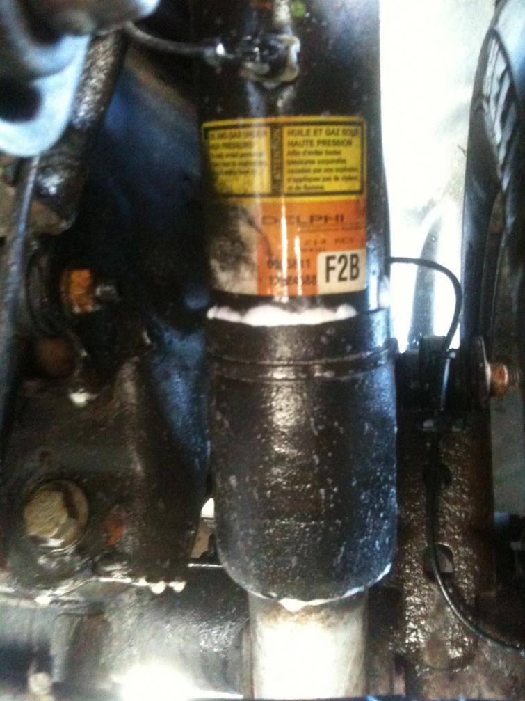

Update:
I got under the beast with some dish soapy water and this is all I could find. Does this look like a leak??

That's your leaking air culprit in that pic. The Autoride shocks are a big PITA.
