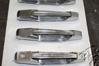

i have 1 set of billet aluminum chrome plated door handles for sell if anyone is interested.
