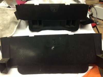

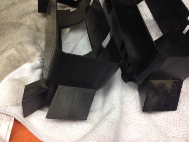

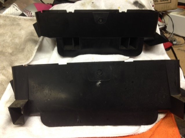

Pics attached
Basically the Denali plate is same size but has no openings on the front part that abuts the Denali console, The Tahoe plate has two openings on the front flat face. Also the inside of the Denali plate is perfectly smooth where the Tahoe one has "fins" leading to the front openings.
The Denali plate has two openings on the side where the Tahoe has only one.
Thinking you can easily modify the Tahoe plate by:
1. Blocking off the front openings however you like
2 removing all off the "fins inside the Tahoe plate to make as smooth as possible.
Hope this helps.

Those pictures rock, thank you so much. I finally understand what it is - it doesn't appear that it truly blocks off the factory Tahoe vents so much as it redirects them to the lower left and right hand corner, which is consistent with the indentations on the front of the Denali console to allow air into the footwell area. I'll see if i can find a part number for future reference on the forum, otherwise looks like I'll be scouring junkyards soon.

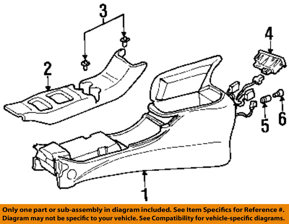

The part numbers for the complete lower console are:
15053714 (gray)
15035715 (tan)
Here are a few part diagrams to help you sort it out. The first is a general breakdown of how you would piece together a new console - there are three major part numbers:
Lower console - Item#1 in the diagram (note that it includes #4, 5, and 6)
Top trim/cupholders - Item #2
Mounting bolts to secure top trim to lower console (x2) - Item #3
The second is an exploded view showing everything that's contained in the console - again, keep in mind that the top trim is separate, but the part numbers for the top trim are:
15049273 (gray)
15049274 (tan)

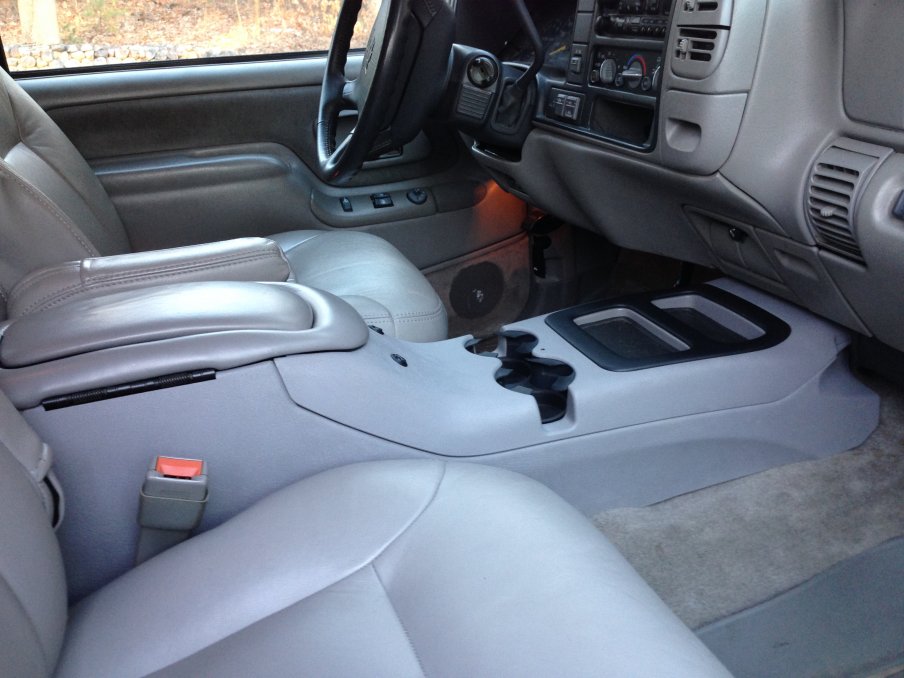

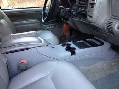

I already have a console in my 2 door
I picked it up in junkyard complete down to the key for the top lid.
I stripped the paint, repainted and re-upholster the lid and the tray bezel to match my interior.
I have a second compete one(tan) that i'll rebuild and repaint shortly to sell off.
Thanks
