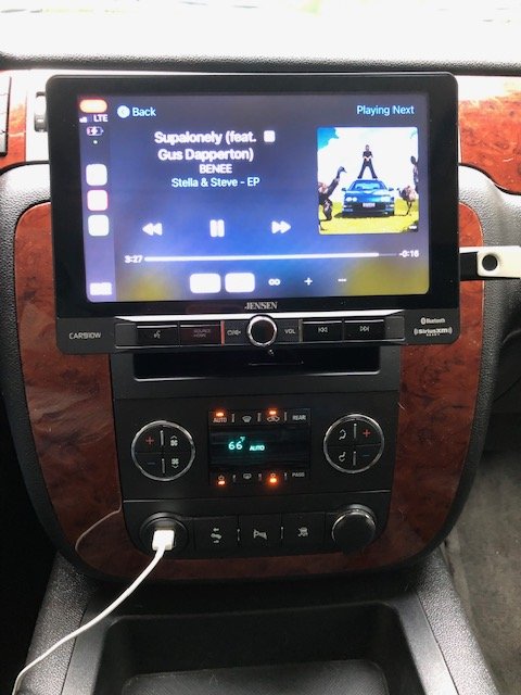

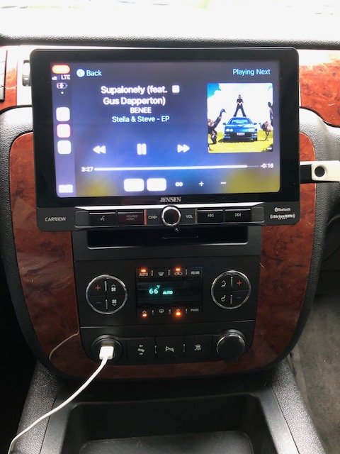

I’ve also upgraded speakers and added a subwoofer in the back. I couldn’t get anything out of whatever subwoofer is in the console. I also installed a Jenson CAR910W because I wanted wireless carplay. That is a great radio and pairs well with the Suburban. It is a good replacement for the 15 year old OEM design. I plan to move it up and back a little so it looks more integrated. That with some initial sound deadening and BAM the Suburban has the best sound!
This is a great forum. One question, are the Z55 shocks/struts a wear item that we replace at 100,000 miles or just if/when they leak?View attachment 352887View attachment 352888
