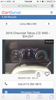

Are there two versions of the HUD? I've seen this theme page attached below and then the more traditional seen in the OPs pictures. Was an update done or is this just a toggle you can scroll to?

The cluster and the HUD are two different mods/parts. The cluster has to be programmed for your truck and for the HUD to work.
The center of the Denali instrument cluster is an 8" screen. You can choose between 3 different "modes".
This thread is more detailed and has way mpre info http://www.gm-trucks.com/forums/index.php?/topic/199229-HUD-in-Silverado/Sierra

Sorry I meant are these two different instrument cluster layouts. As you can see in the two pictures each is different but both are on a taho ltz
This is the third mode that you can choose from.
