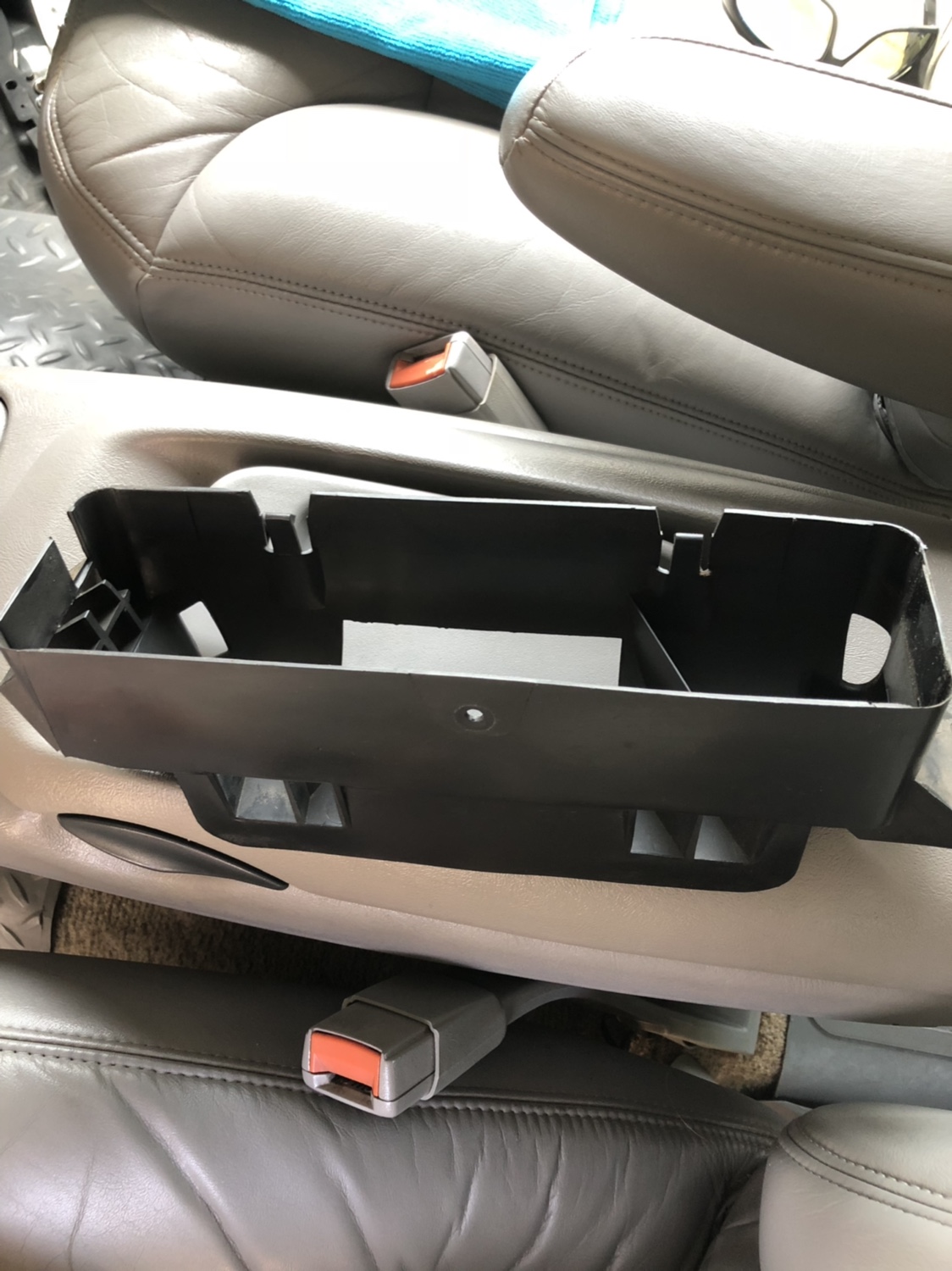

There’s not a lot that you can access, but if the actuator is turning correctly (and the spring linkages are intact), you can pull the lower cover from the box at the center floor...
...and see if you see anything obviously wrong with the damper.
Access to the top of the box, or replacement of the damper, would likely require rotating the dash down for access.

Actually, that looks easier than I thought it would be. I may be able to juice something up to change the air flow without removing it. "Clementine" is not and never will be a show truck. It's a winter drive so I can get to work in really bad weather. I have to open so everybody else can work. The old gal sits on some really nasty Firestone Discoverer MT2 tires and a 2 inch life. Probably the meanest, yet refined, Cadillac you'll see on the road. Unfortunately, unlike Tahoes, Escalades have a full console that may have to come out.
