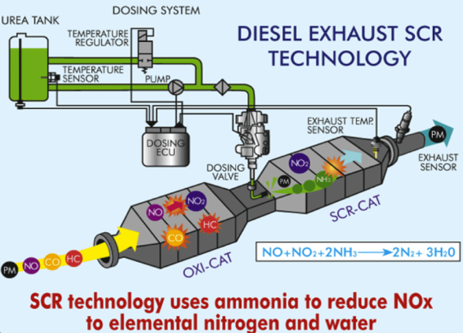

DEF usage is based on engine load (more load =higher NOx), so the higher the load the more DEF it will use. The DEF tank level is like the water and waste tanks on an RV, not a float like the fuel tank. DEF is allowed to freeze so a float would be damaged when the DEF freezes.
FWIW the urea in the DEF is converted to ammonia in the hot exhaust and the ammonia in the SCR converts the NOx to Nitrogen and water (not a complete explanation of how it works).
Edited to remove CO2 and replace with Nitrogen & water.
FWIW the urea in the DEF is converted to ammonia in the hot exhaust and the ammonia in the SCR converts the NOx to CO2 (not a complete explanation of how it works).
Close - it breaks the NOx down to Nitrogen and Water - CO2 emissions are heavily regulated by the EPA and going to continue to get tighter (EPA '27) is the next big emissions regulation. I believe the LZ0 with its revised DOC position, two DEF injectors and other improvements meets the EPA27 requirements for NOx and C02 reductions.
