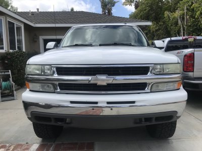

Heres the before of the front

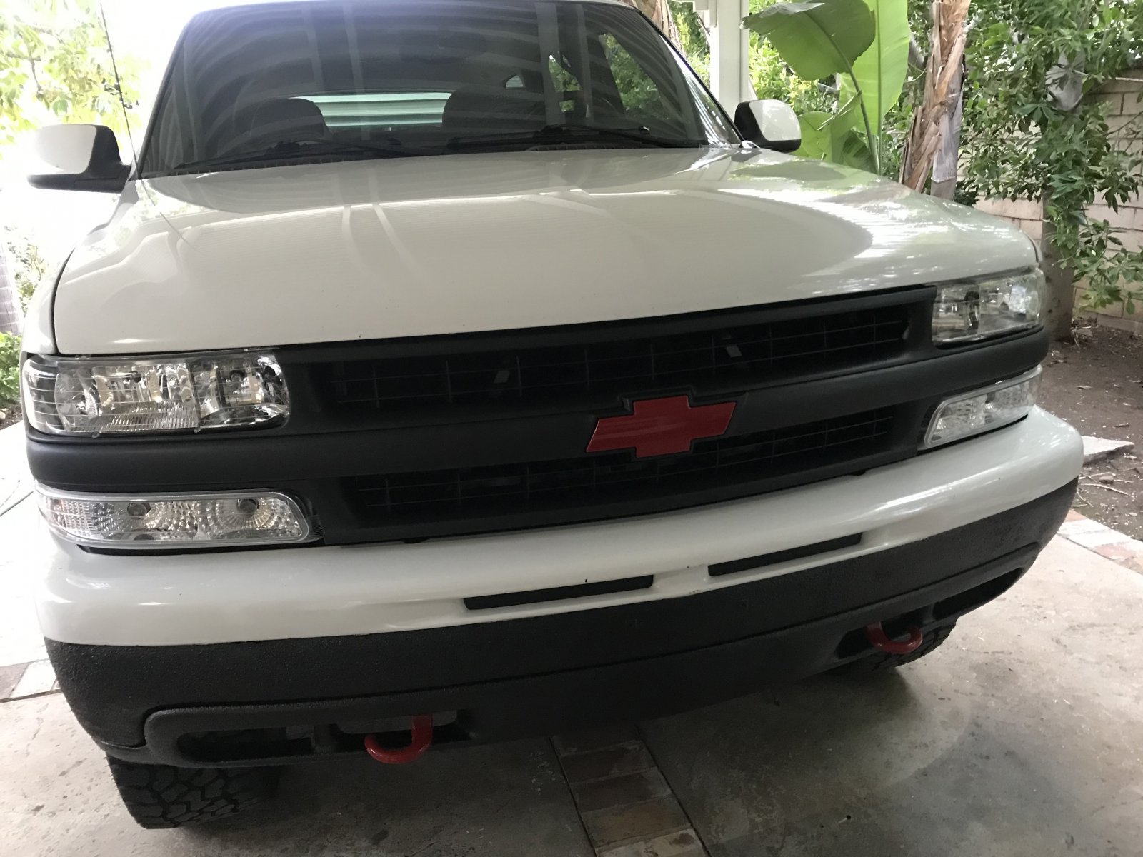

Heres the after of the front

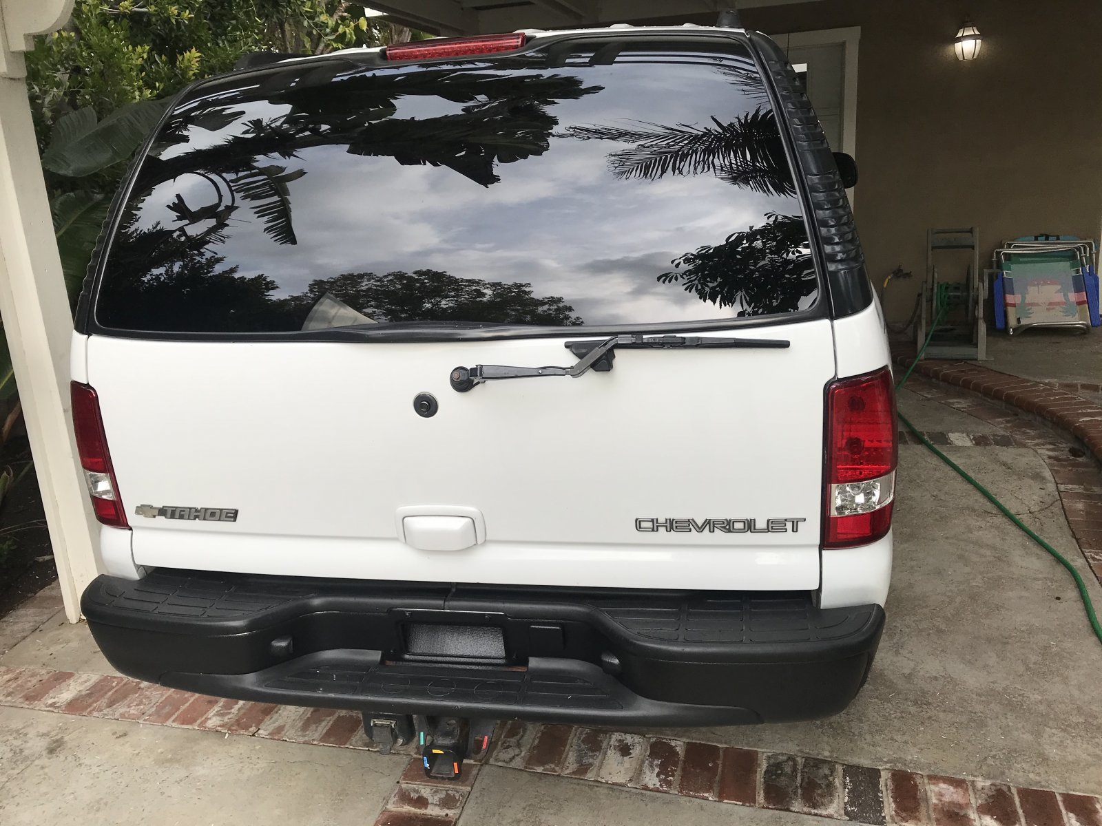

Heres the rear...I didnt do the plastic..just the Chrome

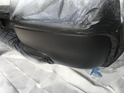

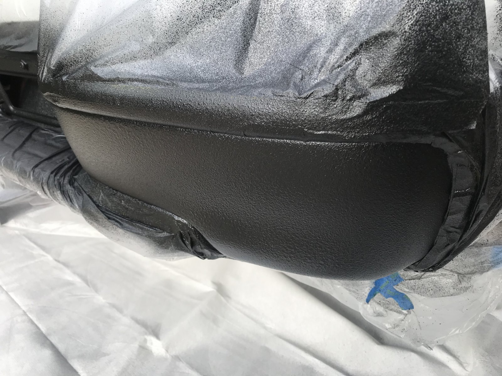

Close up of the rear, so you can see the texture

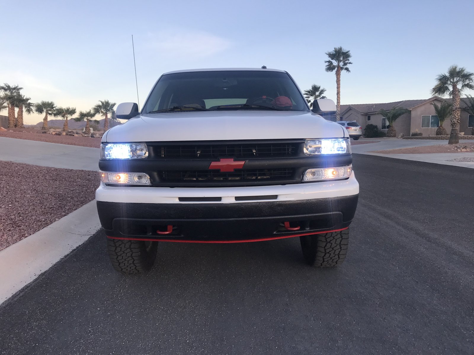

Then I thought I needed some more trim so I mocked up a red stripe
on the bottom of the front lower valance.....Walmart duck tape....LOL
I think it looks happier now.
