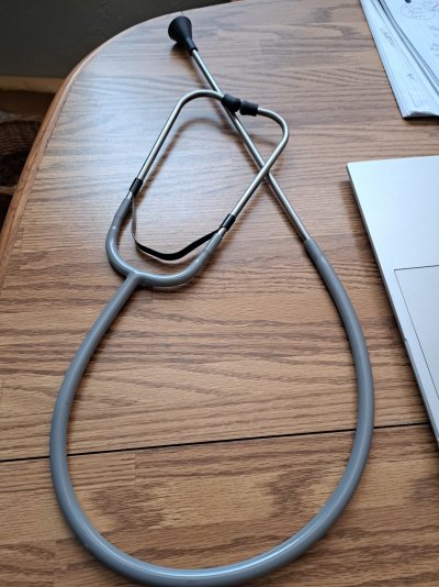

By the way, it is easy to diagnose if the sensor is needed. Use the park assist however you would to move close going forward or reverse and do not set parking brake. I used my mechanic's stethoscope and used my ear cup attachment. If the sensors are activated, you should hear a faint pulse effect, like a Geiger Counter. You tube videos about this. Some people use an app on their phone that listens and records and shows decibel readings. If you are close to PNW and Eugene, Or., let me know. I can do all this for you.
