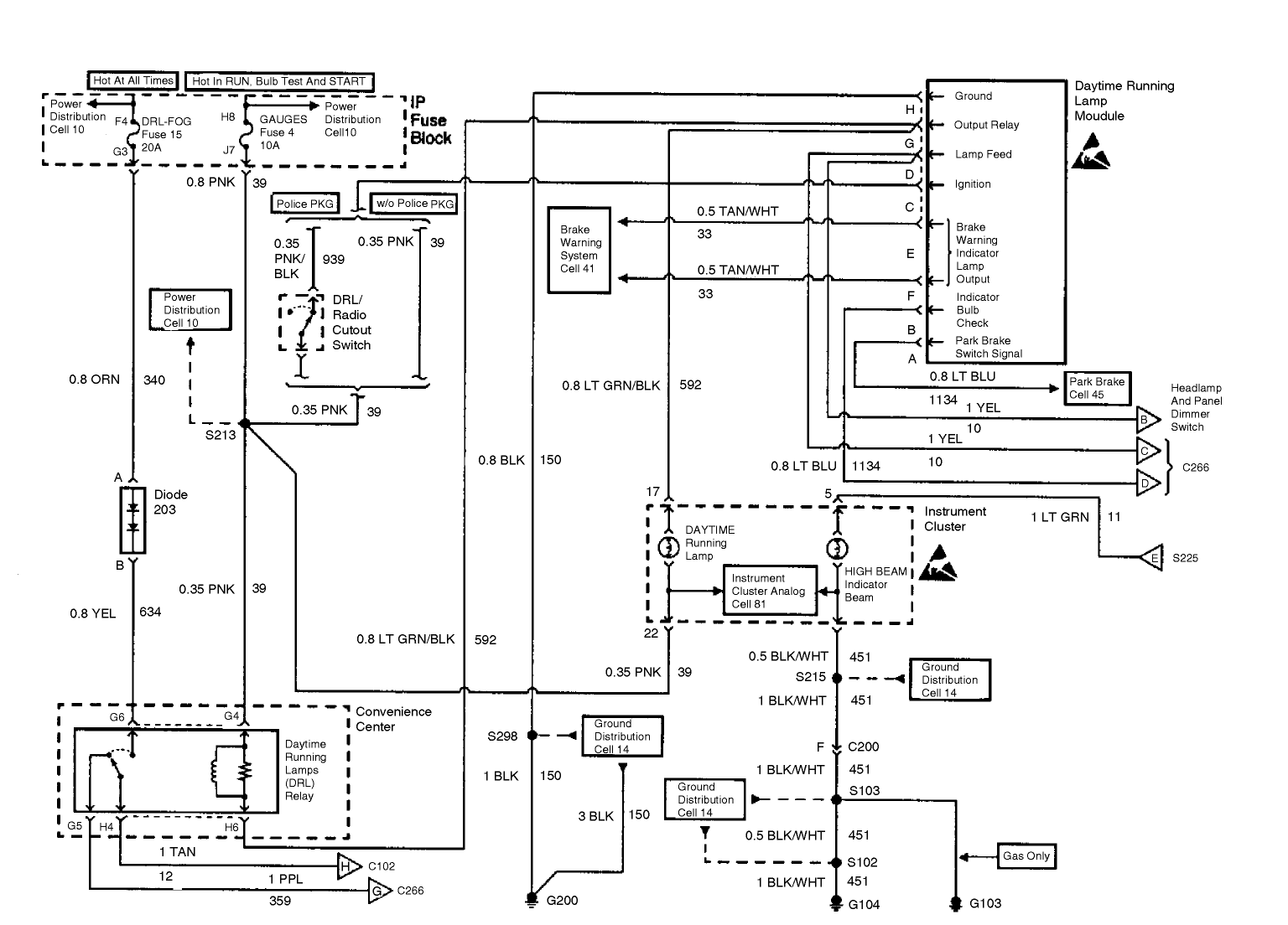

The DRLs are the low-beams and should come on when the headlights are off and parking brake disengaged.
Someone may have pulled the fuse, maybe check that. Diagrams say it’s number 15.

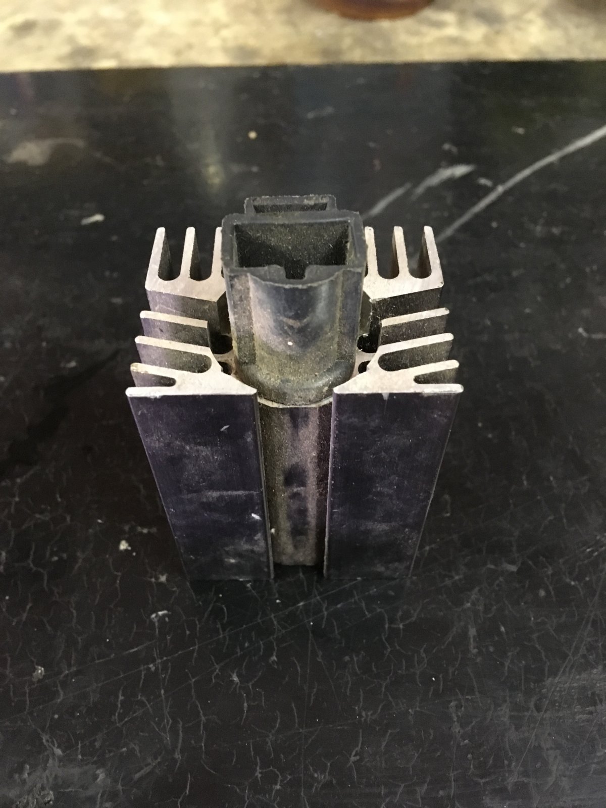

Look under the dash, right under the steering wheel, see the pic attached or above. Stupid Daytime Running Lights, the most dumbest thing ever invented by Government Burearcrats ever. If this module has been removed, you will have the green light illuminated on the dash during the day with with the lights off. It is telling you that your DRL's are not on. If the module has been removed it is not usually a problem on the 99's. But some have reported that it can interfere with other circuts. Do more research.
Oh Hell, I can't even remember anymore...that's how stupid and unsafe they are. I have removed these modules from 2 of my 99 tahoe's and a '98 Yukon without any issues.
Previous owner could have pulled the fuse, but most fuses are tied into 2 or more circuts so something else would not work as well (a way to track down faults). They are actually unsafe because you could be driving with the DRL's on and not turn on your actual headlights when it gets dark out (and hence, no tail-lights or side markers). Whatever, if another driver can't see a big old Tahoe coming down the road at them at 70 mph...well, you get the idea. If you don't have the module pictured above, then you may have the circut board type, housed in a green plastic box in the same location. 99's were on the cusp of using both types.
Yes, there are soldered resistors that can be removed or added if you have the circut board type. (keep doing a search on this site). OR you can put a piece of black tape over the "green" light and ignore it. OR, you can use it to your advantage like many of us here.
