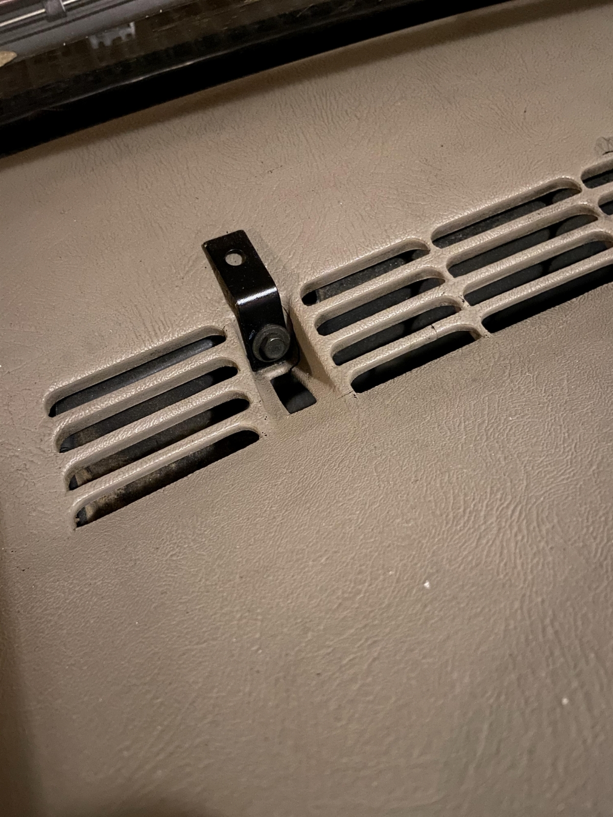

Have a picture of the top of the dash - particularly at the three screws? Usually, the plastic cracks around them and causes the top of the dash to vibrate (rattle).
In that case, you can either use some brackets to hold it down...

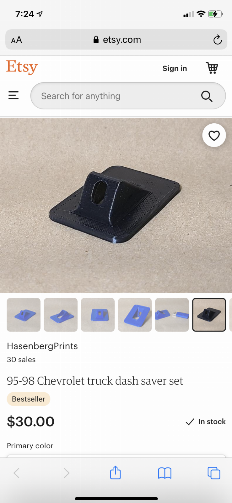

... or here is a link to a more refined solution. Either way, those dash caps are not structural and merely cover up a busted dash, so adding something at the screw holes would be ideal.
https://www.etsy.com/listing/894099828/95-98-chevrolet-truck-dash-saver-set
