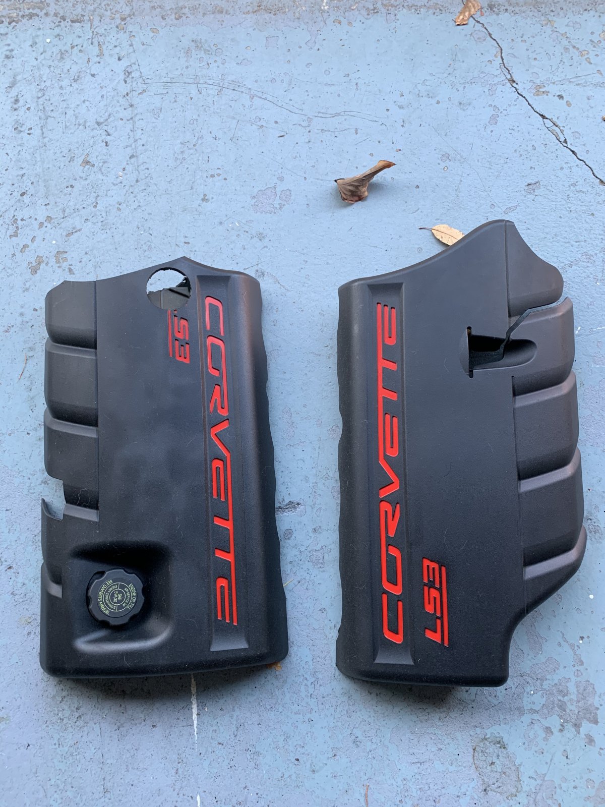

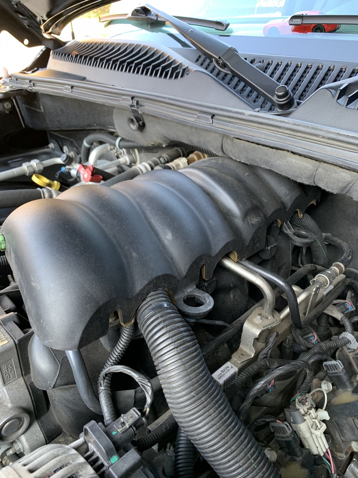

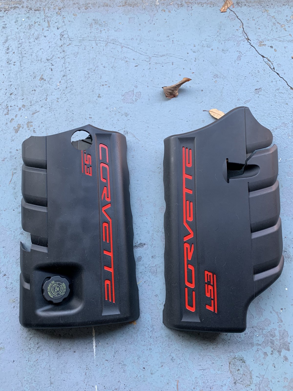

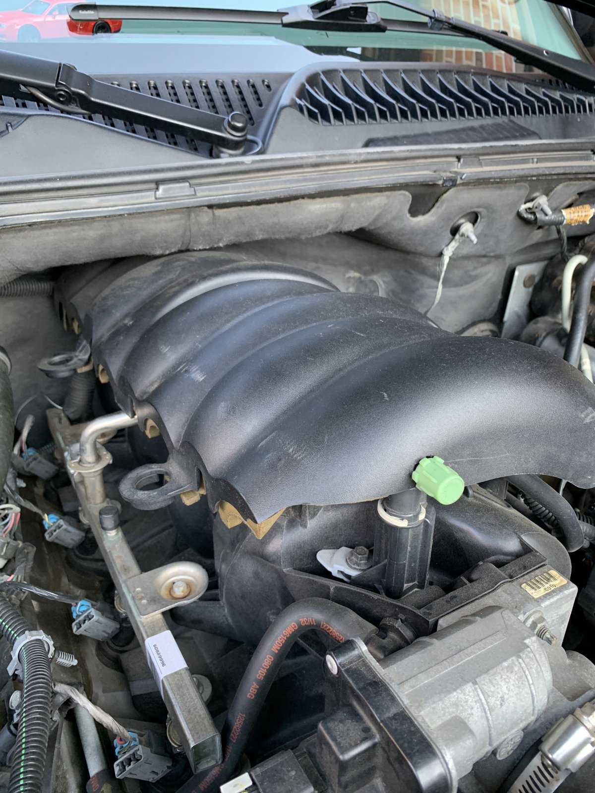

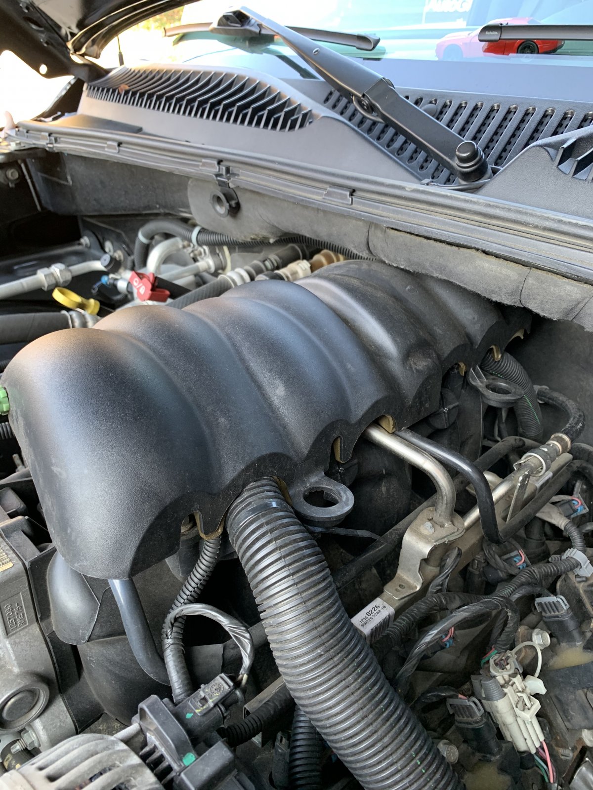

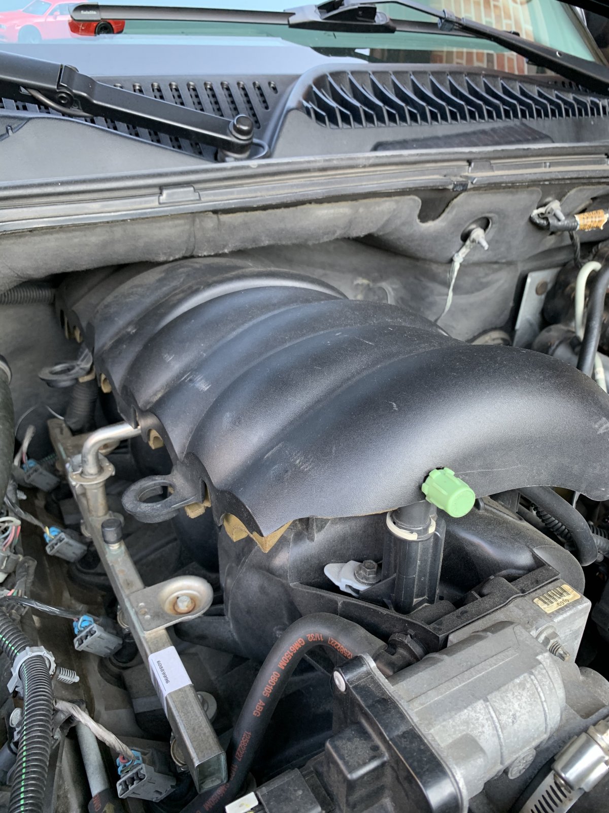

How did you get the LS3 engine covers in your engine bay? How are they attached? What intake plenum cover is that?
It’s all from C6 corvette. The passenger side you have to cut ALOT off of to fit but the driver side is untouched, just run your ground strap through the fuel line opening in the cover. The fake fuel lines that the covers snap onto are still a work in progress. But they can mount on the beauty cover with its existing mount holes. Oil cap is just mounted to the cover and not useable. Some wire looms will need to reposition a little but do not need to but unplugged. There is one I need to make in the beauty cover in front for valve cap to fit through, but that worked great because it locks it the cover.

I was going to find some LS1 stock fuel line to mount to to the beauty cover so the fuel rail covers will lock down tight. If you look closely the holes on the cover and the 5.3 fuel rail bolts on the intake matchup perfectly. So attaching a bracket or something should be easy.
