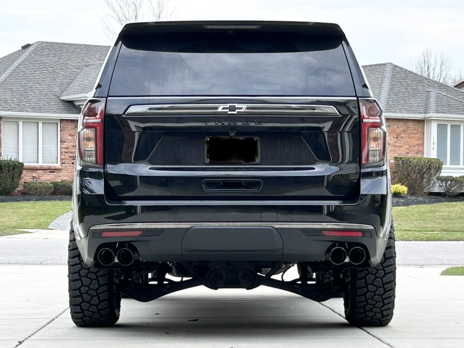

I’ve gotten used to mine and the DFM even with my Borla S Type muffler. Don’t want it kicking in I’ll just feed it more gas. I’m at 24,300 on the clock and loving it. At this point I’ve lost hope and just accepted DFM lol.

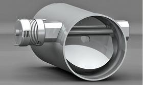

You can simulate it, clamp your flaps open temporarily and see if the noises go away. You might get the “helicopter” sound but if the squealing goes away that’s driving you nuts you can upgrade to a corsa that’ll “fix” it (no flaps, no drone, no dfm helicopter).
nick14226
Nov 22, 2019
258
249
What are these "flaps" you speak of?
GM has them in the exhaust pipes, near the muffler, on the AFM and DFM 5.3 and 6.2. Spring loaded flap opens based on how many cylinders are firing (how much exhaust is flowing). 1 cylinder cruising and the flap is barely open, 8 cylinder wide open and it’s full open. The flap prevents strange exhaust notes when cylinders drop with the stock exhaust. They’ve been known to make noise and also resist full flow when full open.
I would say the squeal while cruising, even when L9 (DFM deactivation) is engaged, being caused by the flap.

With the corsa I can really hear what’s happening with DFM. When coming to a stop the cylinders drop as you’re coasting/braking, and then just before you’re totally stopped the cylinders (and exhaust) come back to life. Some notice a bit of a lurch when that happens, and guessing it’s when the squeal happens you’re describing in the neighborhood. Clamping open the flap is a grasp at straws approach, but seems you’re getting to that point. No guarantee it would help.
Point being, if opening the flaps doesn’t help I doubt an aftermarket muffler or exhaust will either.
