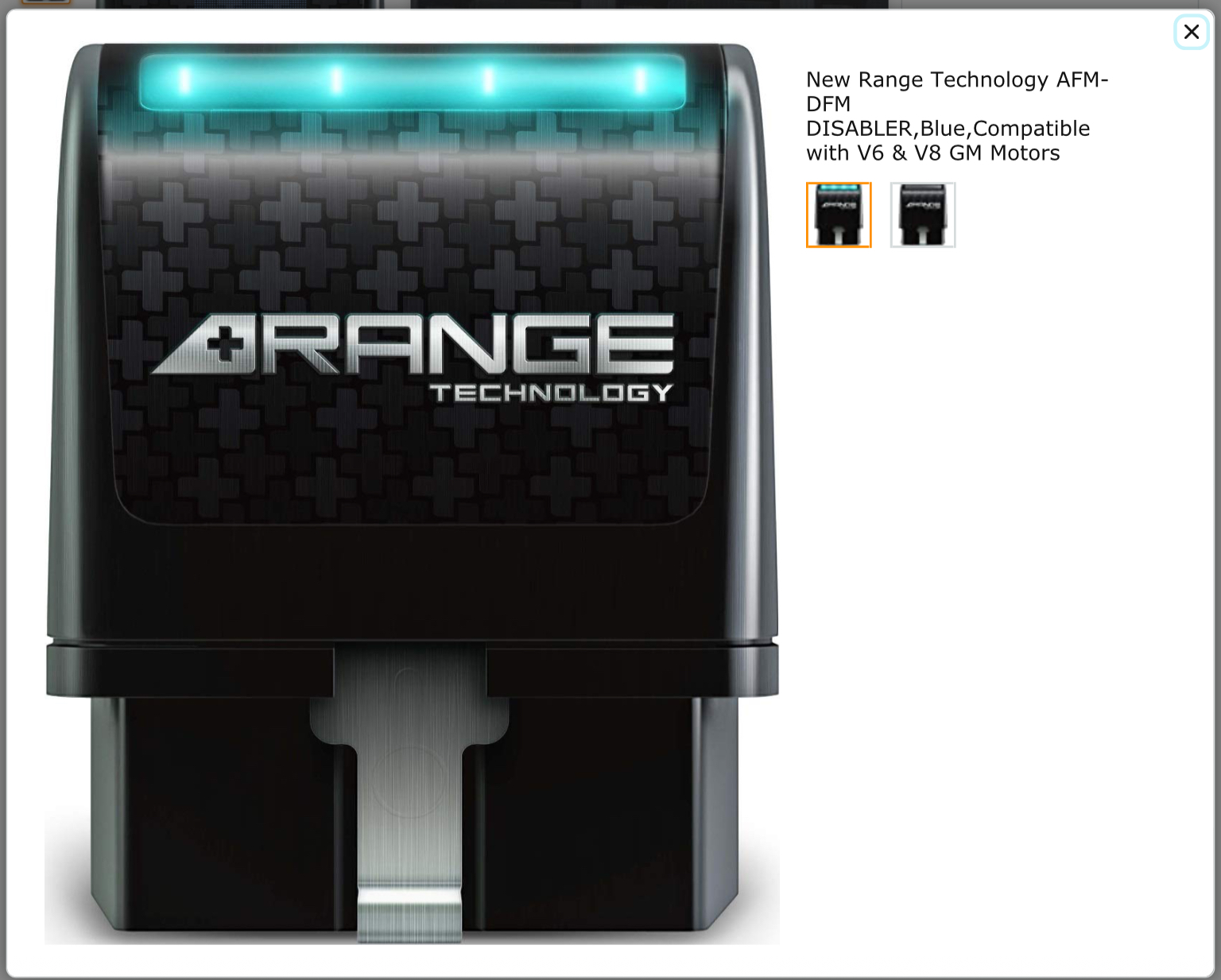

Does anyone know if any company makes an active fuel management cylinder deactivation disabling device for the current model year, 2021 through 2023?
check their website to see if one is available yet. Made by Holly
They said it's not. GM rewrote the code for 21+. It was open source before, but now they wrote the code internally.
Range is working on breaking the code to make a model for 21+, but they don't have anything now.
They expect an update by end of year.
