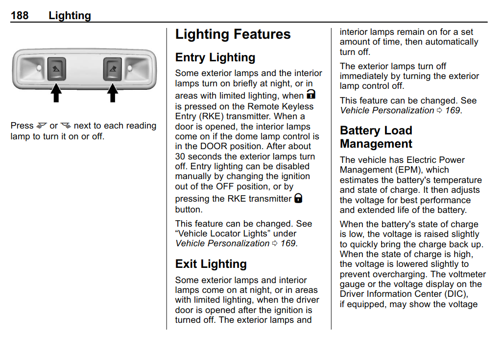

Check your settings (like @Joseph Garcia noted). Do you have a copy of your owner's manual?
