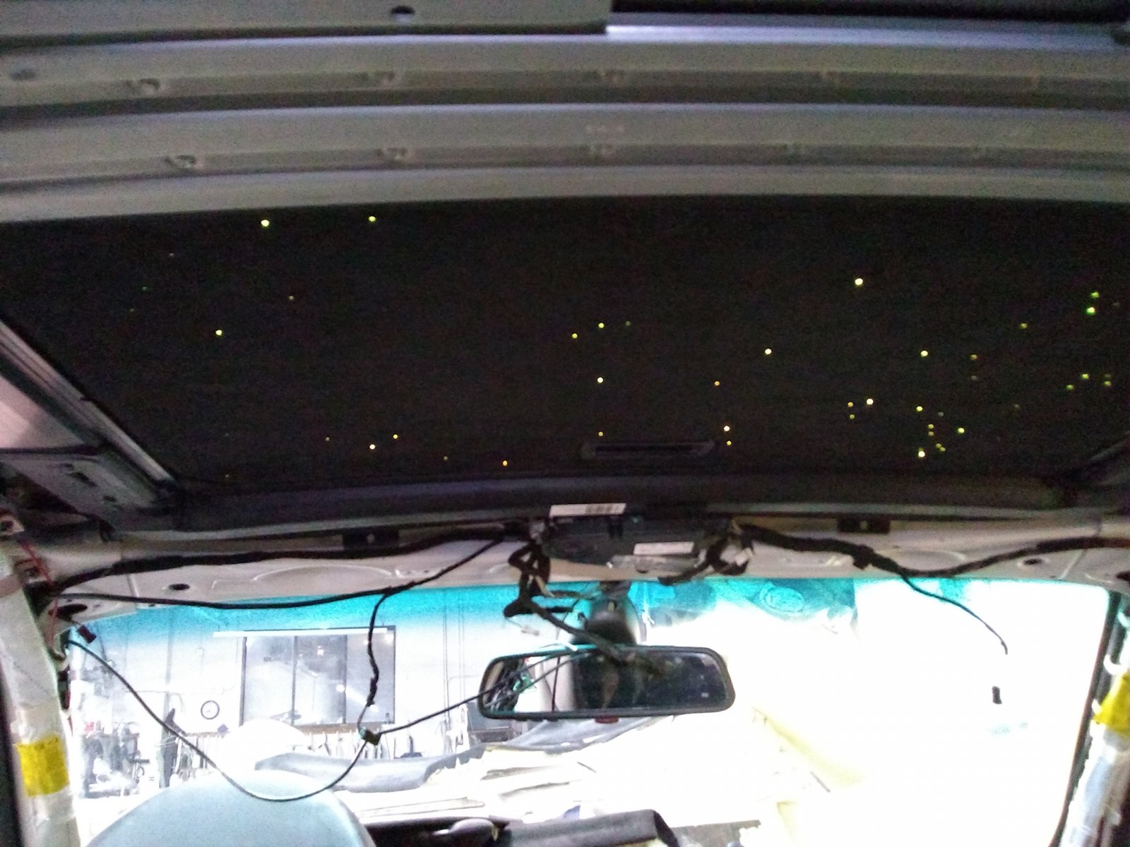

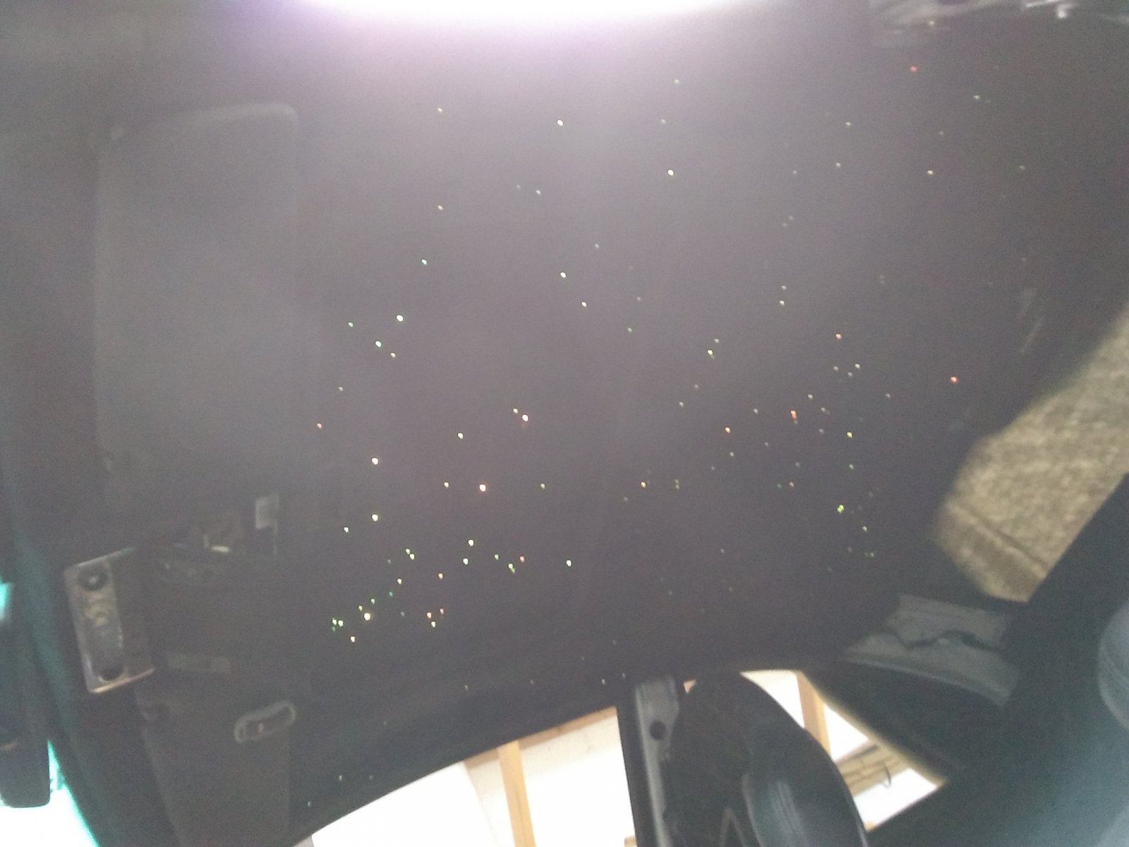

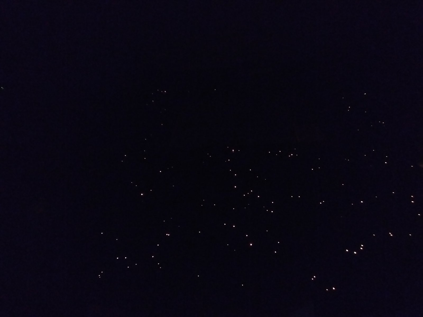

Coincidentally I just did a black suede headliner and a fiber optic starlight ceiling in my BMW last weekend. It looks awesome but damn it took a long time and that was in a car with a headliner less than half the size of your truck. I used 197 points of light, 40 or so of which were in the sunroof slider. It took me 13 hours total including recovering the headliner. If you have any questions on it shoot me a pm.
