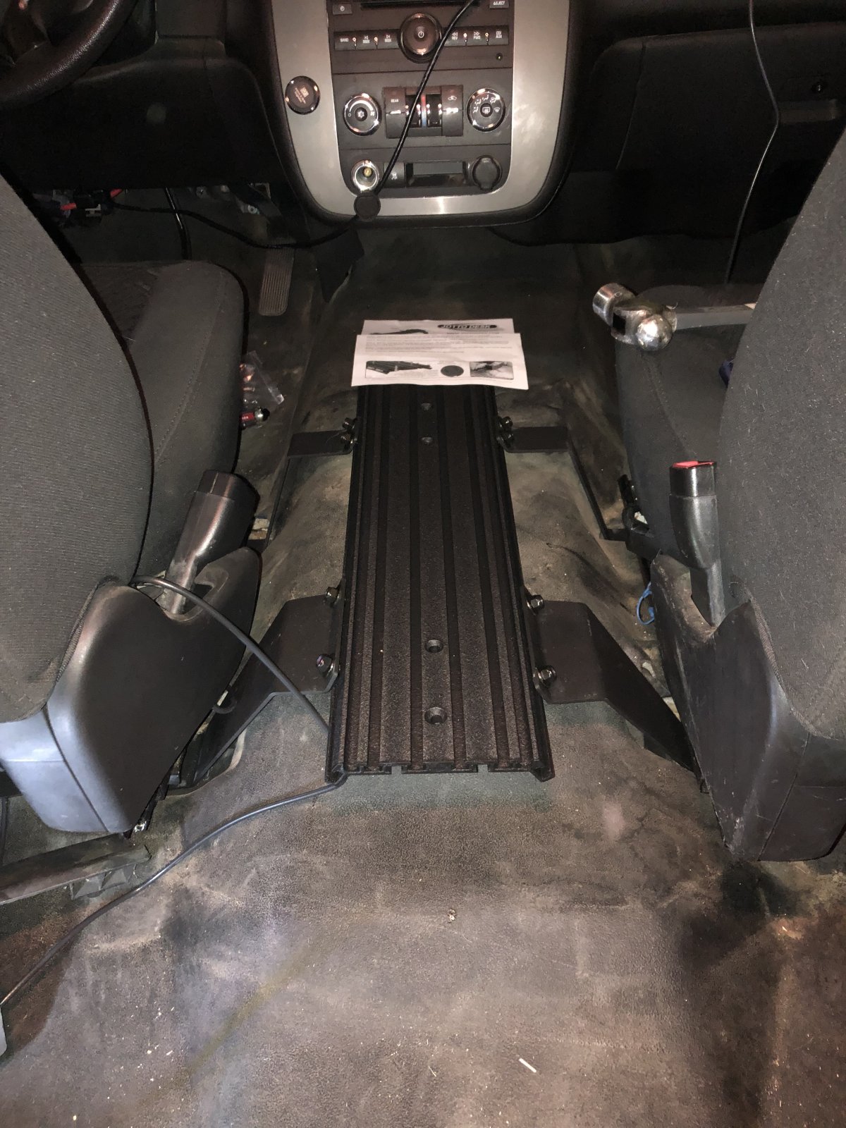

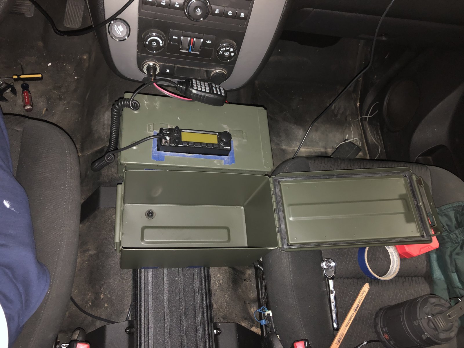

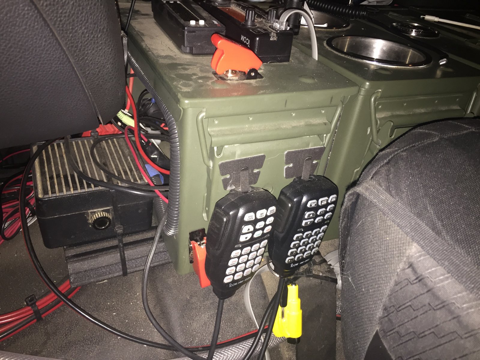

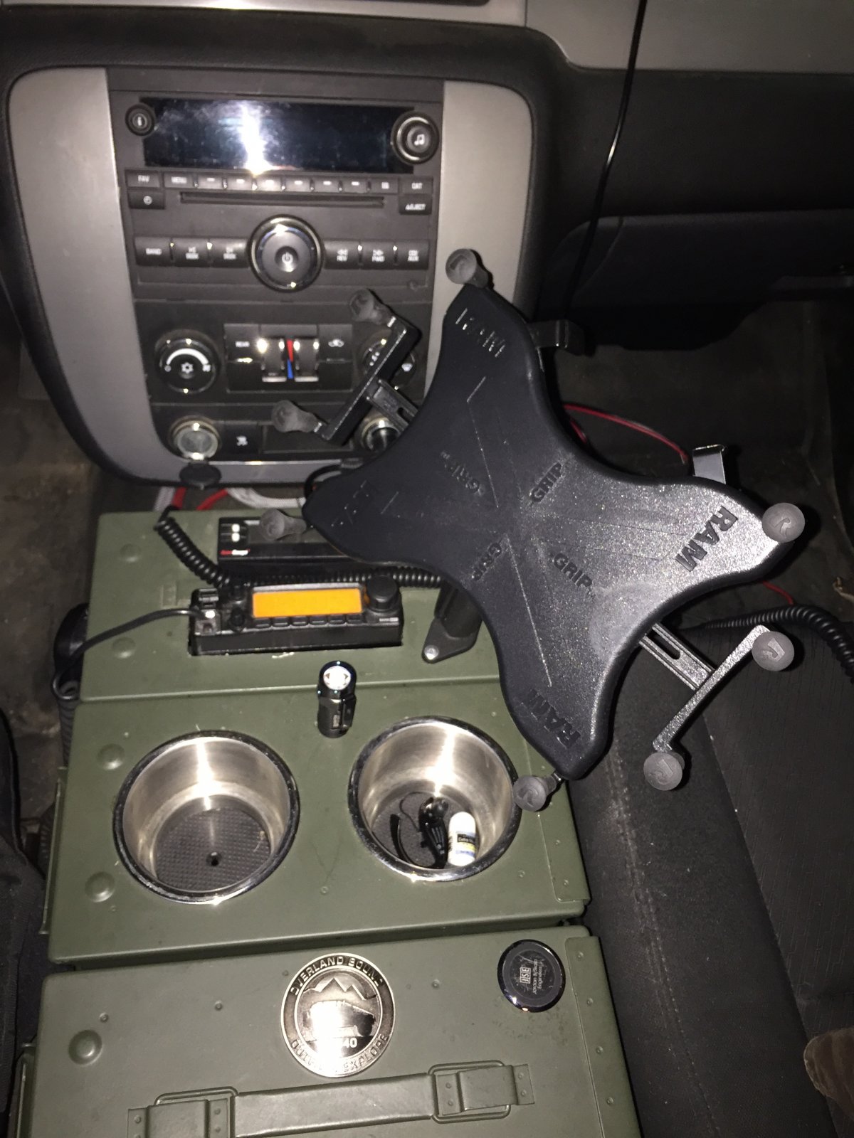

I started with a Jotto floorplate, then added 4 50 caliber ammo cans.

That looks very interesting. What's a good place to find Jotto floorplate? ebay or try my luck in a junkuyard?

I bought it new from one of the public safety suppliers. Paid $140 if I recall, 3 years ago.
they do show up on eBay. With any of them, the only unique thing between vehicles are the brackets to the seat mount bolts.
