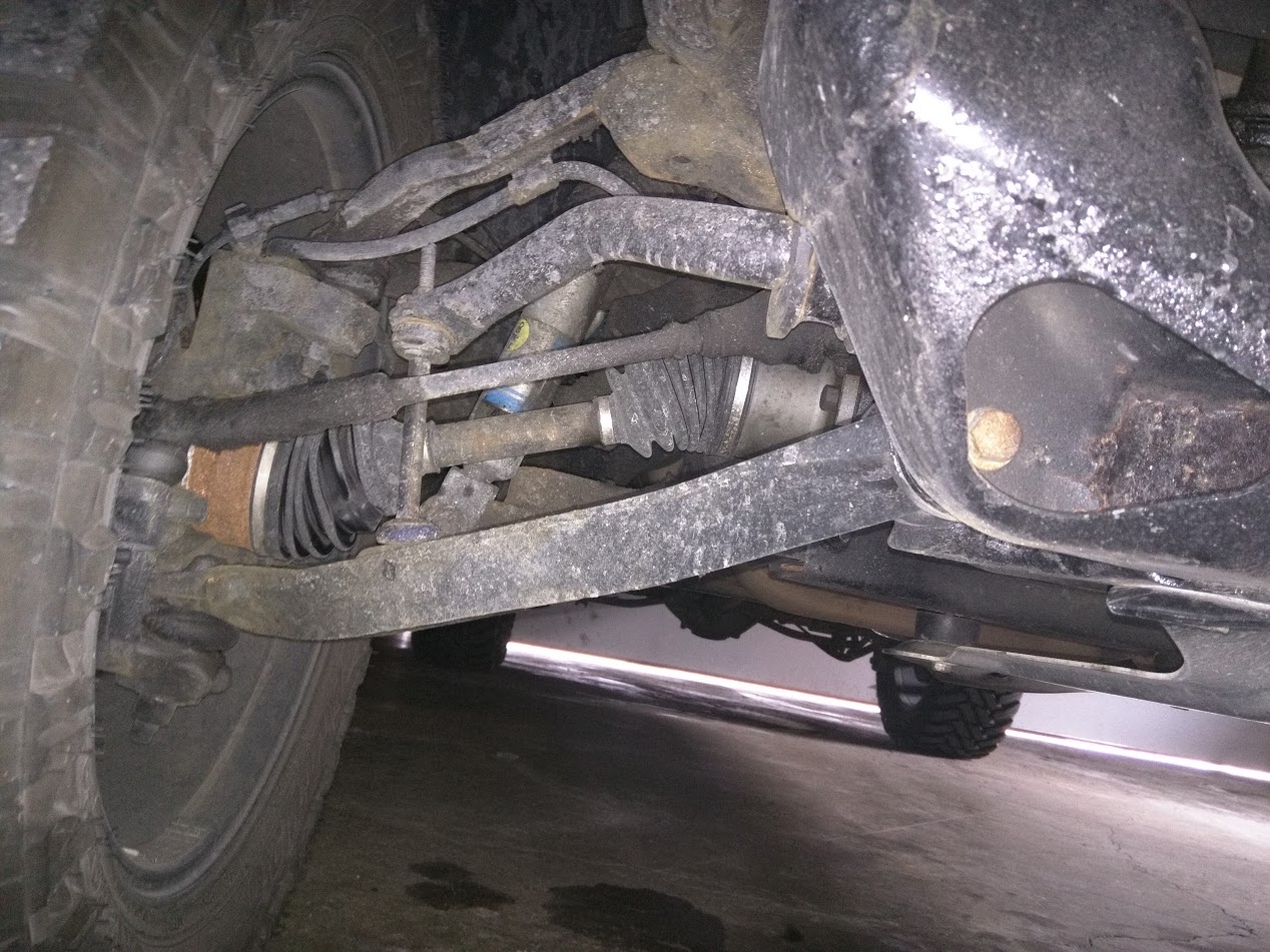

Thanks. Look at these angles - you can see the drivers side lower boot is already starting to ooze (clamp is still there despite the photo angle). The previous boots tore up at the axle stubs.

Yeah those angles are some of the worst I've ever seen! Would decrank them and let it ride for the sale. Pick up a NNBS and lift it!
View attachment 59295 View attachment 59296
Previous Boots:
After looking at the Pro-c's, Gauphy's, and BP's I've firmly decided on selling the two truck's I have and upgrading to a newer SUV. :)
Holy Crap those are some bad angles! I agree with @01Konvict, lower that thing back down, sell it, and lift your new vehicle. Good luck

You're right. Torsion keys made sense at the time raising up, fitting the desired wheels. Not a bad way to go if you don't mind chipping your teeth over speed bumps and pot holes.
