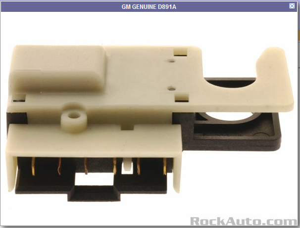

For the cruise, the brake light switch on the brake pedal arm could be defective; it has three switches integrated into the pkg and they control different functions. The internal switch that controls the cruise control circuit could be defective. A good scanner like a Tech 2 could show you the status of those switches.
Pic source: Rock Auto (for non-adjustable pedals)
