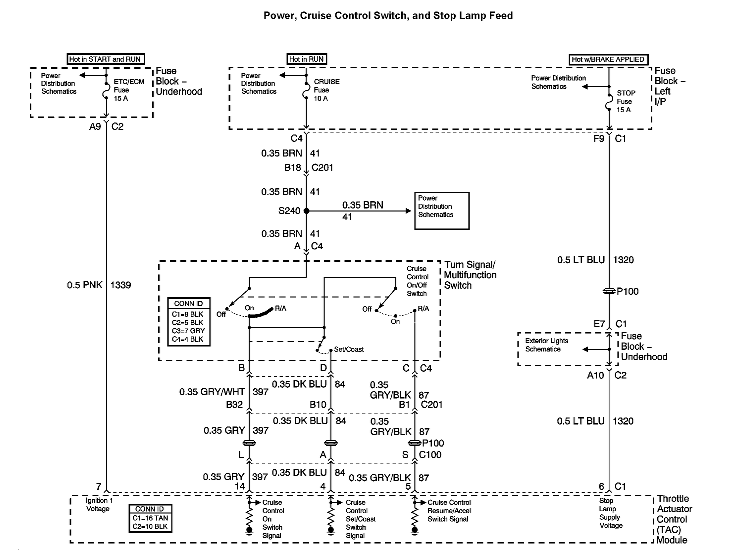

1. Check the Gray wire pin 14 at the Throttle Actuator Control (TAC) Module. It should have battery voltage with the cruise switch on and stay battery voltage as the set switch is pushed.
2. Pin 4 at the TAC module is a Dark Blue wire that will have battery voltage momentarily as the set switch is pushed. Pin 5 is Gray/Black and will be momentary power as the resume/accel is pushed.
3. Pin 6 is a Light Blue wire that is 0 volts until the brakes are applied, then it goes to battery voltage.
4. Inspect all the Brake lights for proper operation AND the correct bulbs being used. If all OK replace the TAC module.

Thanks for the troubleshooting steps, will try them. I'm guessing no voltage at pin 14 or 4 means bad cruise/wiper stalk on steering column?
No LED tails, just stocl

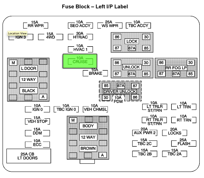

Could be assuming there is power at the 10A CRUISE fuse in the fuse box.
This is on the left side of your dash between your dashboard and door when it is closed. There is a door there. Pop it off.

Went back over everything, check the cruise control fuse again, check the connectors at the cruise control module on the firewall. Sounds that my third brake light, the high center mount light, has 2 LEDs that are not working. Could that be the problem?

Just rechecked the circuit, both with the engine running and without the engine running but the ignition on. No voltage a pin 14 with the cruise switch on and no voltage at pin four when the SET button is pushed. cruise fuse has constantvoltage

Well the right way to conclude diagnostic testing is to pull the cowls off the steering column (not hard to do) and test voltages there using the same schematic.
If you have voltage going in at Terminal A but no voltage coming out of Terminal B & C when the Cruise is set to "ON", then you need a new multifunction switch (turn signal stalk).

Replaced the stalk, still no fix... Should have tested voltages while I had it all apart
