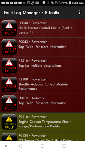

Ok just out of blue I got this . I started it with remote start . And got the reduce engine speed and had to shut off and restart to get it out of it's confusion the throttle wouldnt even work till I shut it off and back on. 2 times . Only thing I can think it could be our weather is crazy above freezing then below freezing and I was testing driving in winter storms so . It's all outside Yukon XL 2006 so condinsation would be in the cards . Anyone else ever had this come on just out of the blue . 181,000 miles.

How old is your battery?

Lots of threads here about crazy codes all of a sudden or ghost lights going crazy. Typically leads to battery probs or ground wire probs. Could something in the "drive by wire" system be going nuts?

If your voltage is ok and within tolerance then you may have a legit Reduced engine code. This has DBW(Drive by wire). There will be a TAC (Throttle actuator control) module up on your firewall next to your brake booster. This is what communicates your throttle position at the throttle and the control to your throttle body which has an electric motor and a TPS (Throttle Position Sensor). The Tps feeds back to the TAC module and if your commanded position is not within a certain percentage of actual then it goes into reduced power mode which is basically idle. This prevent a runaway condition. The 2 common failures in this system are worn wipers in the potentiometer of the TPS or the wiring harness that comes off the throttle motor (electric). The wires tend to break inches away from the plug. Just the wire not the insulation so not easy to see but can be felt. Both failures require part replacement. If your TPS is original, it will be riveted in place. There are other possible causes which include bad TAC module, Bad Throttle Motor, Bad throttle pedal potentiometer and broken system wiring.

take it to walmart they got the S/N in the system 18 volts is way too high
the alternator Bridge rectifier or voltage regulator is bad
BG1988
Nov 14, 2018
3,007
1,371
with the u0107 that rules out the failure of the throttle system
it just says you lost power to the TAC module
the other codes were a domino effect because you lost communications to the TAC
put the key to the run position for 4 seconds then start it
if it starts fine then you have an issue with the battery or charging system (including the ground wires and or wires to the control module )

Put new battery in all fixed no light . I cleared codes it acted up a bit on temp gauge but couple stops and starts all good no money light now . Crazy.. going take battery in tomorrow see if Walmart honors their 3-year return policy. [emoji849][emoji106][emoji53] Must have some dead cells . Thanks for all great info ..
Its good info for others to. It was just pounding out fault codes on that old battery . Here's the freak me out codes ..[emoji849][emoji849][emoji106]

You were right on the money [emoji106] thanks for the post . Switched battery out and it's fine .

Glad to hear that a new battery appears to have solved your problem. These trucks hate any sort of voltage issue. That is why Ron and I asked about your battery right away when you posted all those codes.
Keep an eye on your voltage to make sure you don’t have a bad voltage regulator.

The new battery . Voltage meter stays just a bit over 14 volts all the time now . Doesn't move much at all . Thanks for the info . I will keep a eye on it ..

I got one code I can't shake it just came back after 2 start cycles. [emoji849][emoji15]

that is because the 18volts fried it. luckily that is the only thing that got fried..
2 cycles is correct Voltage Low During Driver open state
Indicates Short to ground or open circuit or voltage high during driver closed state
Indicates short to voltage (short to ground)
check the fuse
P0135 confirms the issue with the heater in the O2 sensor
Driver Side Bank 1 sensor 1 (Pre-cat)
I recommend replacement of all 4 sensors if one is bad the others soon to follow
you can swap the sensors from bank2 to bank 1 if the Code moves to bank2 then it's confirmed that the sensor is bad..

As mentioned by Brent, there is a chance that your O2 sensor was damaged when your system was putting out too much voltage. At 181K, they are more susceptible to failure anyways.
Before you just change out an O2 sensor, make sure you don’t have something going on with the wiring like a corroded connector or a broken wire. My guess is you need a new O2 sensor, but it’s good to make sure your wiring is all in order before you go about swapping sensors.
More than once I thought I needed to replace an O2 sensor only to find I had an issue with the wires.
If you do end up needing to replace the O2 sensor, you will want to soak the threads in Kroil for a few days so hopefully the sensor will give you less of a fight to come out. They can be stubborn, to say the least.
