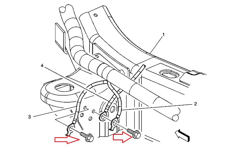

A couple of things to check: rent the fuel pressure gauge from the parts house and do a key on, engine off pressure test. Post results here.
Check and clean the grounds that are under the driver's door hinge, on the body mount on the frame, just behind the left front tire. One of those is for the body control module.
Apart from that, get someone to diagnose it before parts are shot at it.

Thanks for the reply @Fless. I just removed those 2 wires and cleaned them real good as well as the frame they were mounted to with no luck. Something I forgot to mention in my first post is that 2 weeks before my problem, my gauges in my cluster intermittently did not work. The truck would start up fine but none of the needles, PRND, or information display would work. Sometimes they would never come on during my drive and sometimes they would randomly come to life while I was driving. All the backlights/blinker lights in the cluster would work fine though. That is one of the reasons I am leaning towards an electrical issue over a fuel issue. I will try to get over to a parts store to rent the fuel pressure gauge later today to give that a shot.
