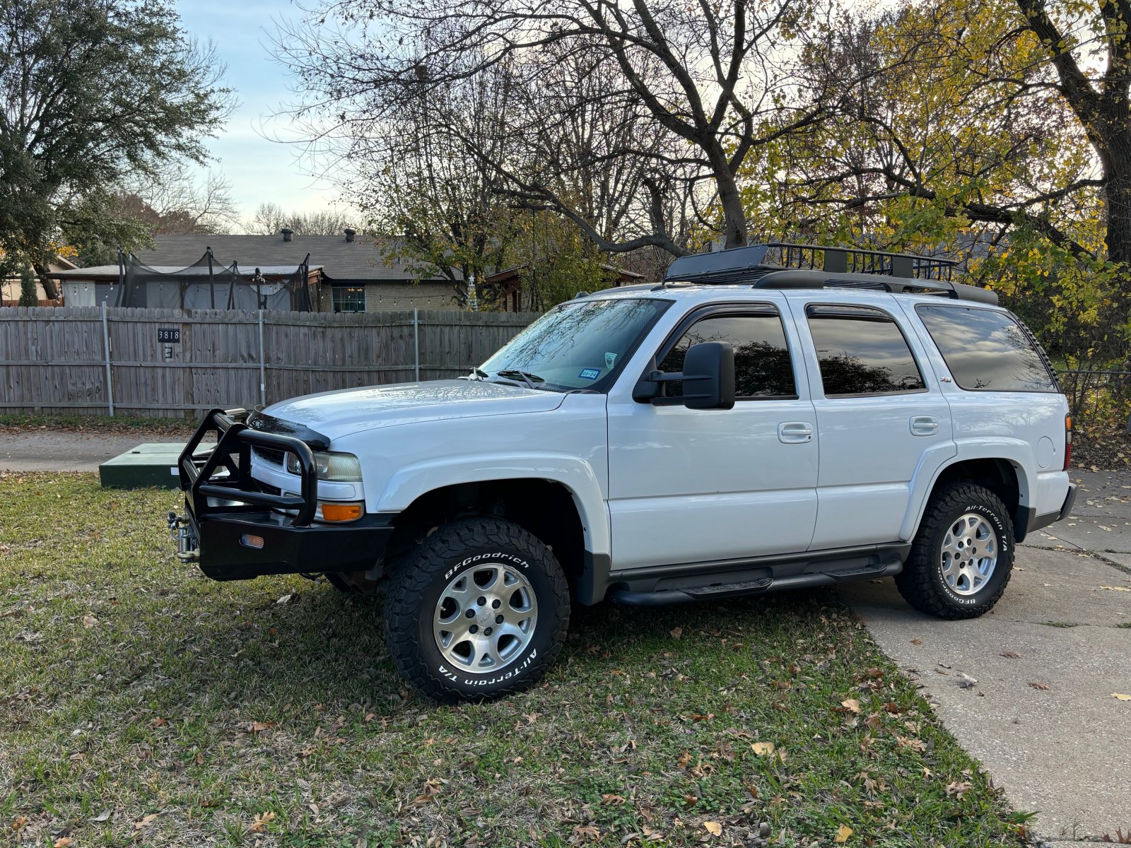

You can also look at Rock Auto. com. I buy from them and save even more that the GM Parts Direct. And the parts are genuine GM AC DELCO parts!! Just wanted to throw that out there. And as for the ease of changing shocks on the older 2003 versus the 2021, Its two different suspension systems with that magnetic ride thing. I have a 2005 Z71 4x4 Tahoe that I absolutely love. I had Rancho's on it before the level lift kit. Now I have Bilstein's. I prefer the ride of the Rancho's. It was firmer and responded better to bumps and corners. The Bilstein's are like kinda firm marshmallows.
