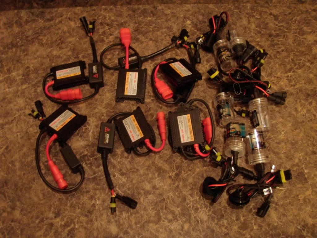

Not exactly progress, but the mail man came :)

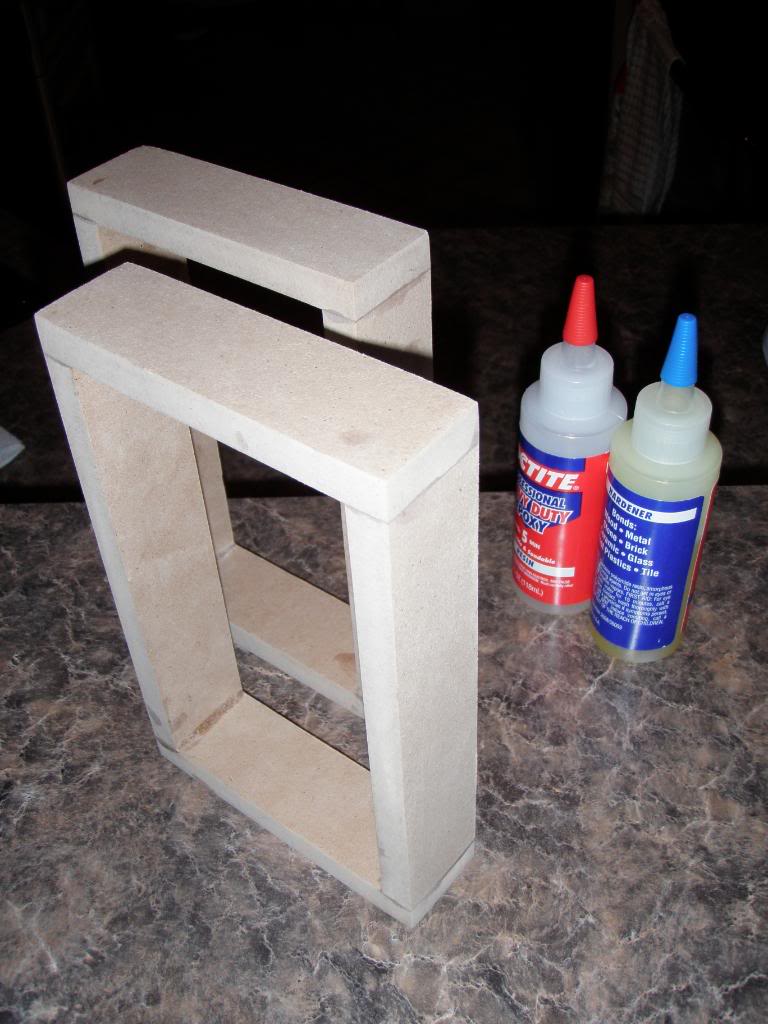

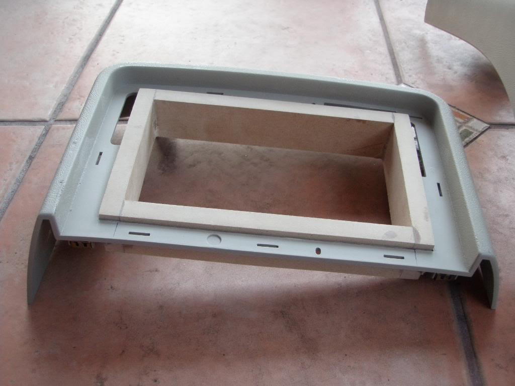

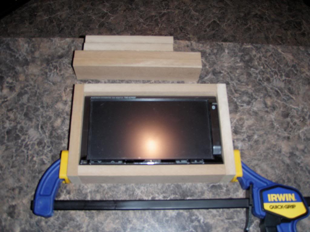

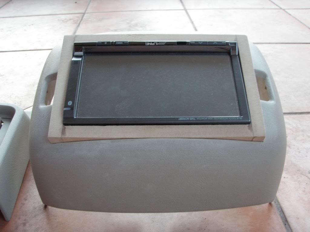

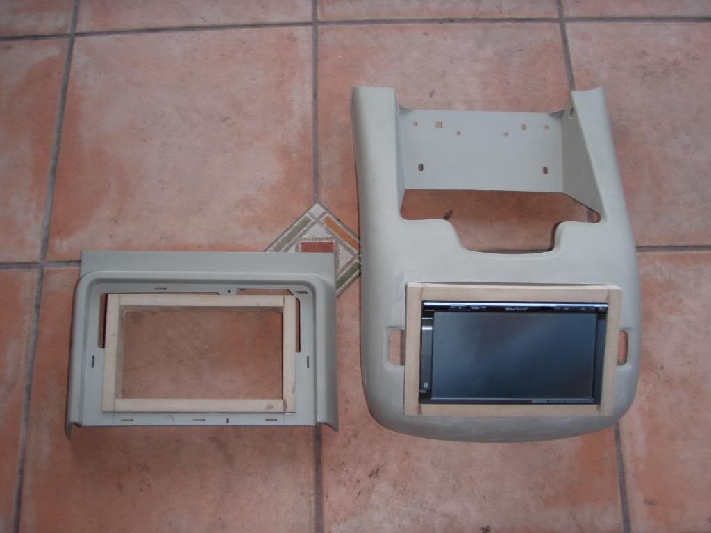

A little bit of action today, Made up the MDF frames for the center console's front and rear monitor, and cut the holes for their placement. Everything looks perfect and I will be locking in the frame with epoxy as a temporary tack, then fiberglassing it all in. The protruding corners of the frame for the rear monitor will be shaved down and smoothed in.

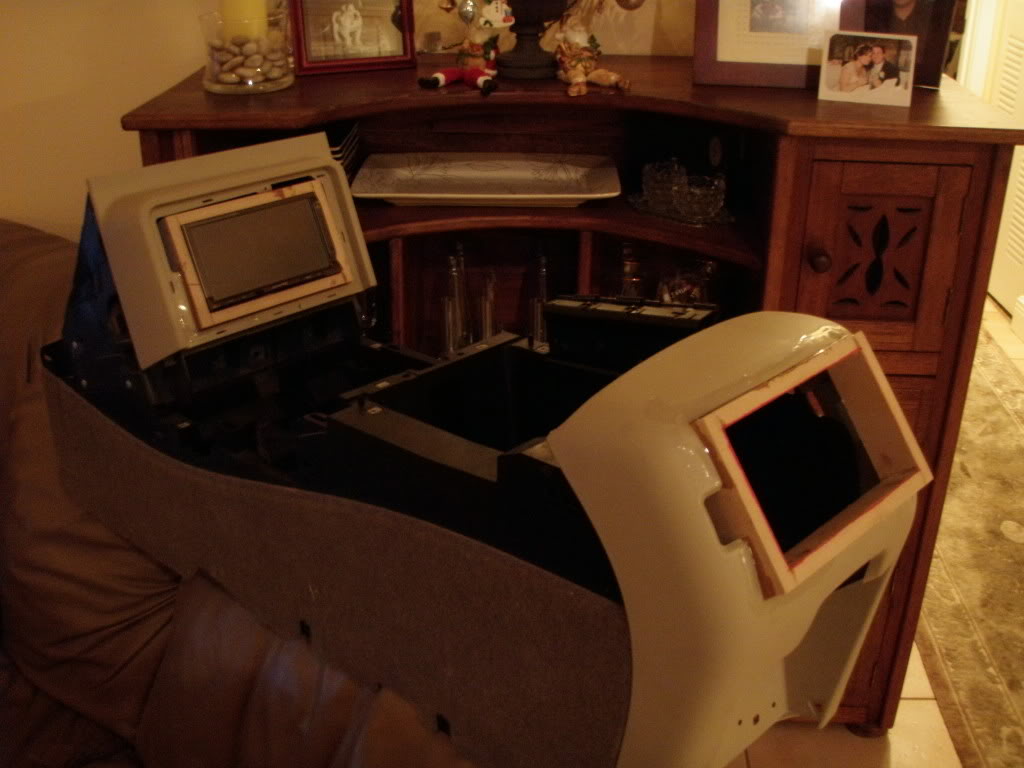

Here is another pic to better see whats going on...
I locked the frames in with epoxy and tomorrow I will blend them down how I want then fiberglass.
