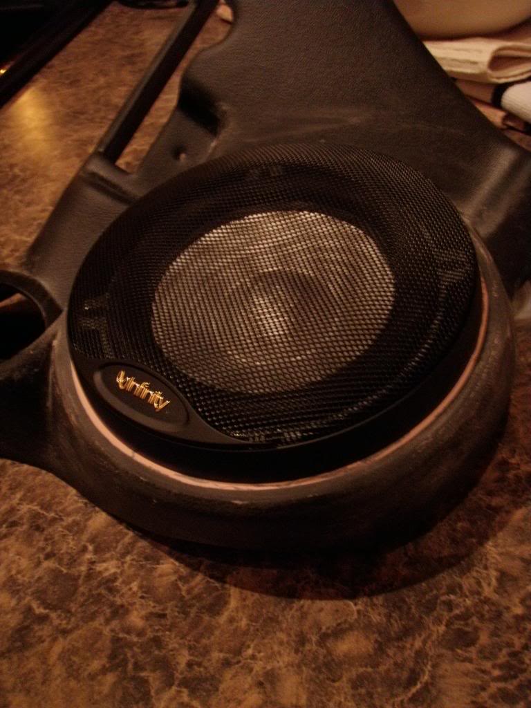

Look what the fedex droped off! Can't wait to get them home and see how they will work with the infinity grills. They look to be of decent quality. I think I will be preping them and painting them gloss black insted of leather wraping them, but we'll see...
rough up the backs, and build them up with kitty hair/FG, then dynamat em.
otherwise the plastic will break after a few months, especially if it is a heavy speaker.
I was thinking the same thing, that plastic isn't stong enough to handle miles of bumps supporting a heavy woofer. I have some tiger hair ready to go, but I think I will just use some pieces of fiberglass matting. I can get a nice thin, uniform layer and strong as hell. I'm also cutting a MDF ring and fiberglassing that in, one for more support, also to mount the woofer a little further out so that monster magnet has a little more clearance, and so that the infinity grill can be used.

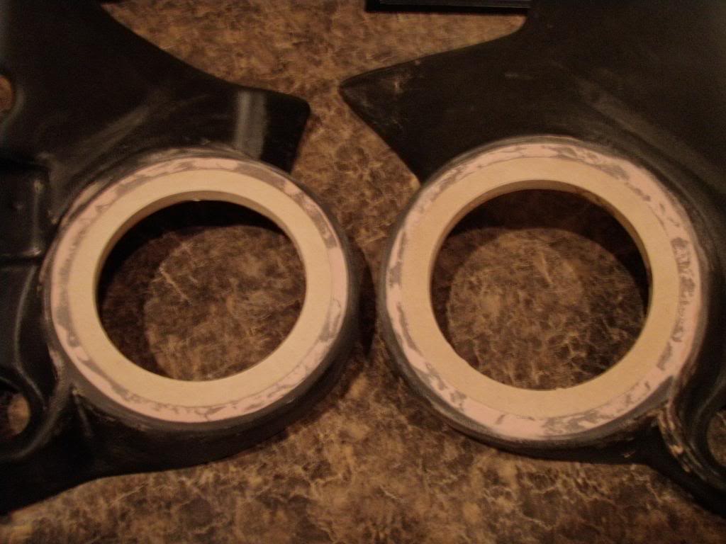

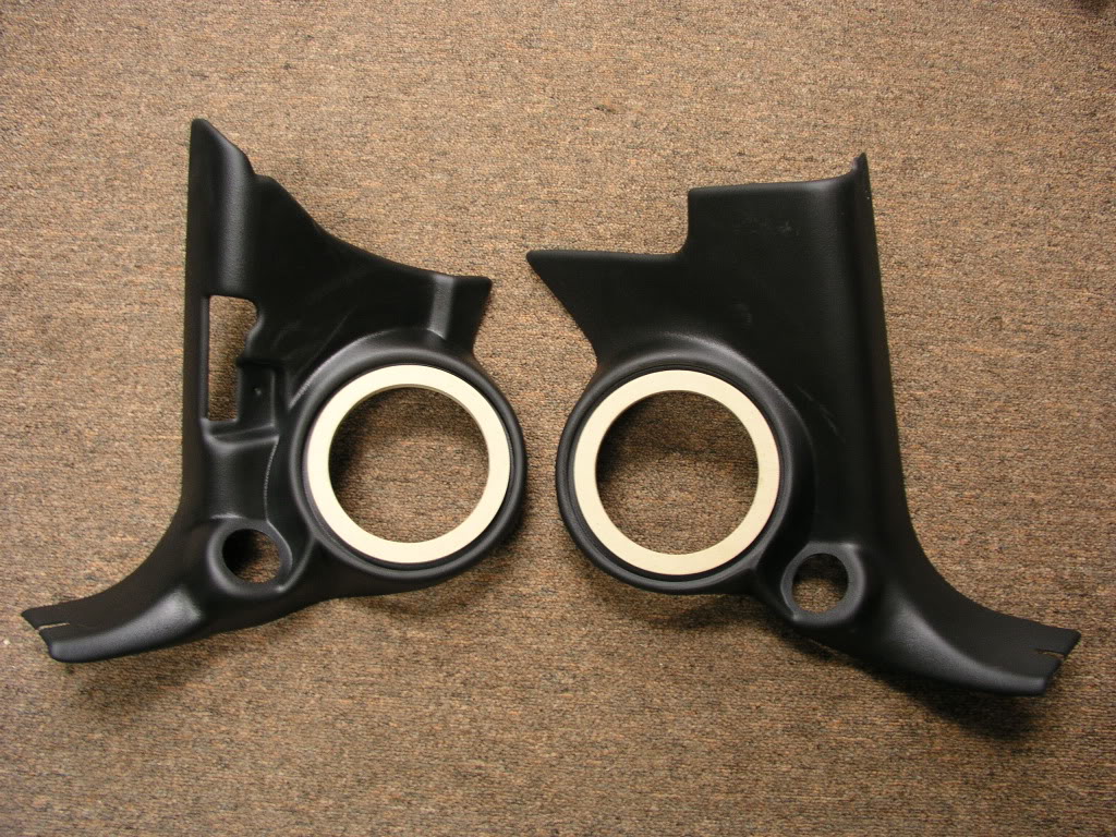

Just a bit of work on the kick panels. Cut out some 1/2 MDF rings for support, and they will be epoxyed, and screwed into the plastic with countersunk heads. Then I will be filling the void between the ring and plastic edge with Tiger Hair (Kinda like body filler with fiber glass mixed in) and sanding smooth to be a perfect fitting base for the infinity grills. Once that is done it will get a thin layer of fiberglass on the back side for rigidity & strength. I'm leaning toward covering them with leather when they are ready to go...

Sorry been slacking, Lot of stuff this past week, had a root canal today which wasn't too fun. This weekend I should be hitting it hard with fiberglass and building an amp rack/ Sub box.
I epoxied the rings into the kick panel and used tiger hair then a layer of body filler. Here are some shot of the work. I still need to hit the back end with a little tiger hair or fiber glass mat for additional support and then they will be done and ready to be wraped in leather...

looking good. i like that you sanded the ring and plastic togeather to make it loook lke one pieace
