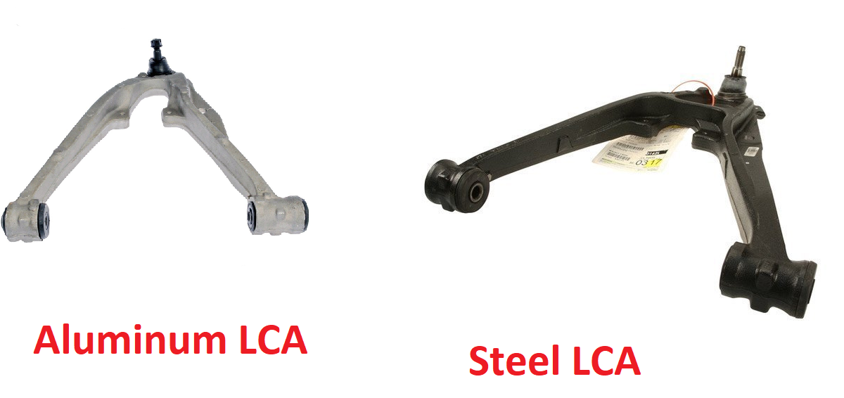

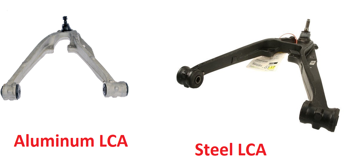

Ball joints are different depending on whether you have steel or aluminum lower control arms.
Aluminum control arms are thicker and require a thicker ball joint to seat properly.

Generally speaking, the aluminum lower control arms usually came on the AWD models in an effort to save weight. In the big picture, how much are we truly talking, a few lbs?
So, that said, if you're shooting for replacing the entire lower control arm as a unit, I don't see any benefit to going with the aluminum over the steel as the aluminum ones are usually more expensive.
Which one your vehicle currently has would really only come into play if you were opting for just replacing the ball joints as the steel vs aluminum arms take a different ball joint.
It's pretty easy to tell just by looking at them. The aluminum ones will be a lot lighter in color.

So would aluminum arms mean I have an aluminum knuckle?
A magnet test indicates that the knuckle is magnetic, but the arms all appeared lighter in color. Maybe I need to go have a closer look.
Edit: Just went out and looked again, nice and dark in color, and a magnet sticks nicely. Steel is the winner.
The aluminum lower control arms didn't JUST come on the AWD trucks. We have them on our 2 WD Tahoe PPV. They do save weight, which should help a tiny bit with mileage. They appear just a durable as the steel ones, so I'd opt for the aluminum units just to save weight. Weight counts everywhere, and 1/2 of it is unsprung.
